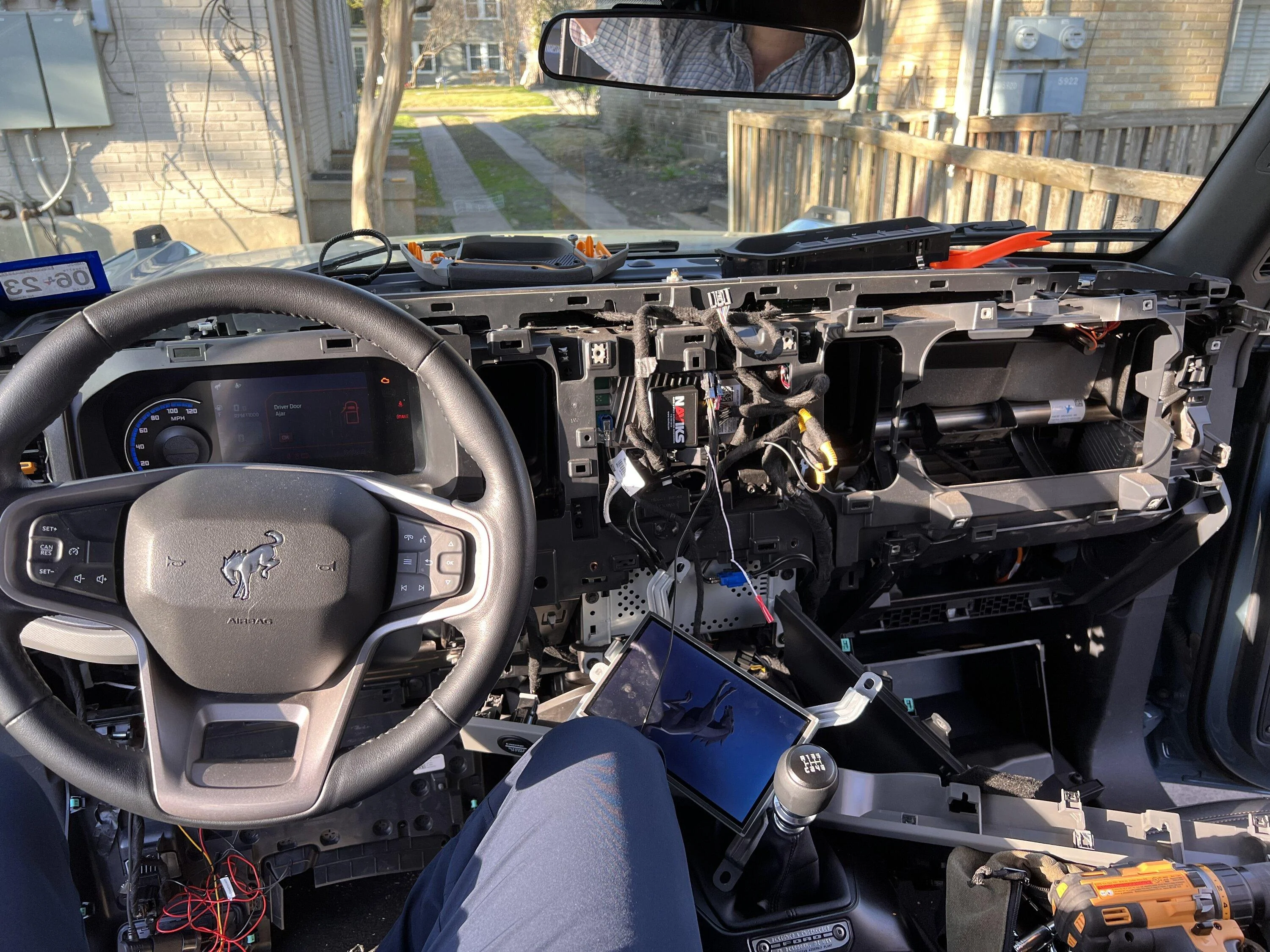

Attempted the Naviks install with an amazon natika camera on my 7MT Badlands base (no mid package) and unfortunately naviks does not support the manual transmission, yet.
If they get a 7MT test mule in NY they said they'd call me back after they get it working and available for sale.
I could get the camera to work after moving out of reverse when the "reverse image delay" setting was turned on, but it'd cut out at like 3pmh and the other feature, nav in motion, didn't work for whatever reason.
Don't look forward to doing this whole process again.

Recently installed the Naviks option on my BaseSquatch along with a Nakita camera.
Pain to install with how far the dash has to come apart but otherwise excellent operation.

Naviks just told me to use this video:
Then afterwards remove the screen with the 4 screws and you'll be able to access and install the harness and let the camera and accessory power provided dangle underneath
