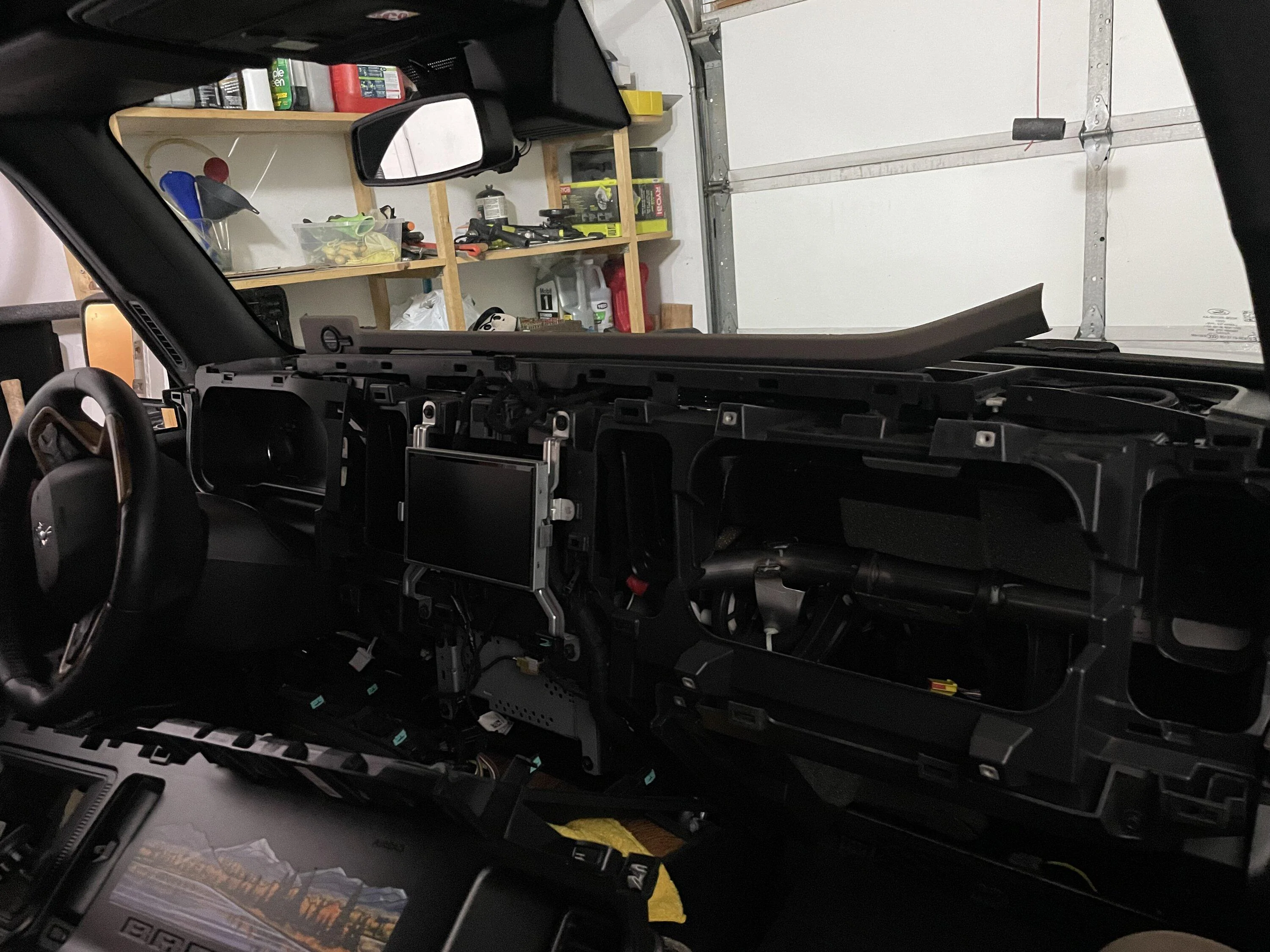

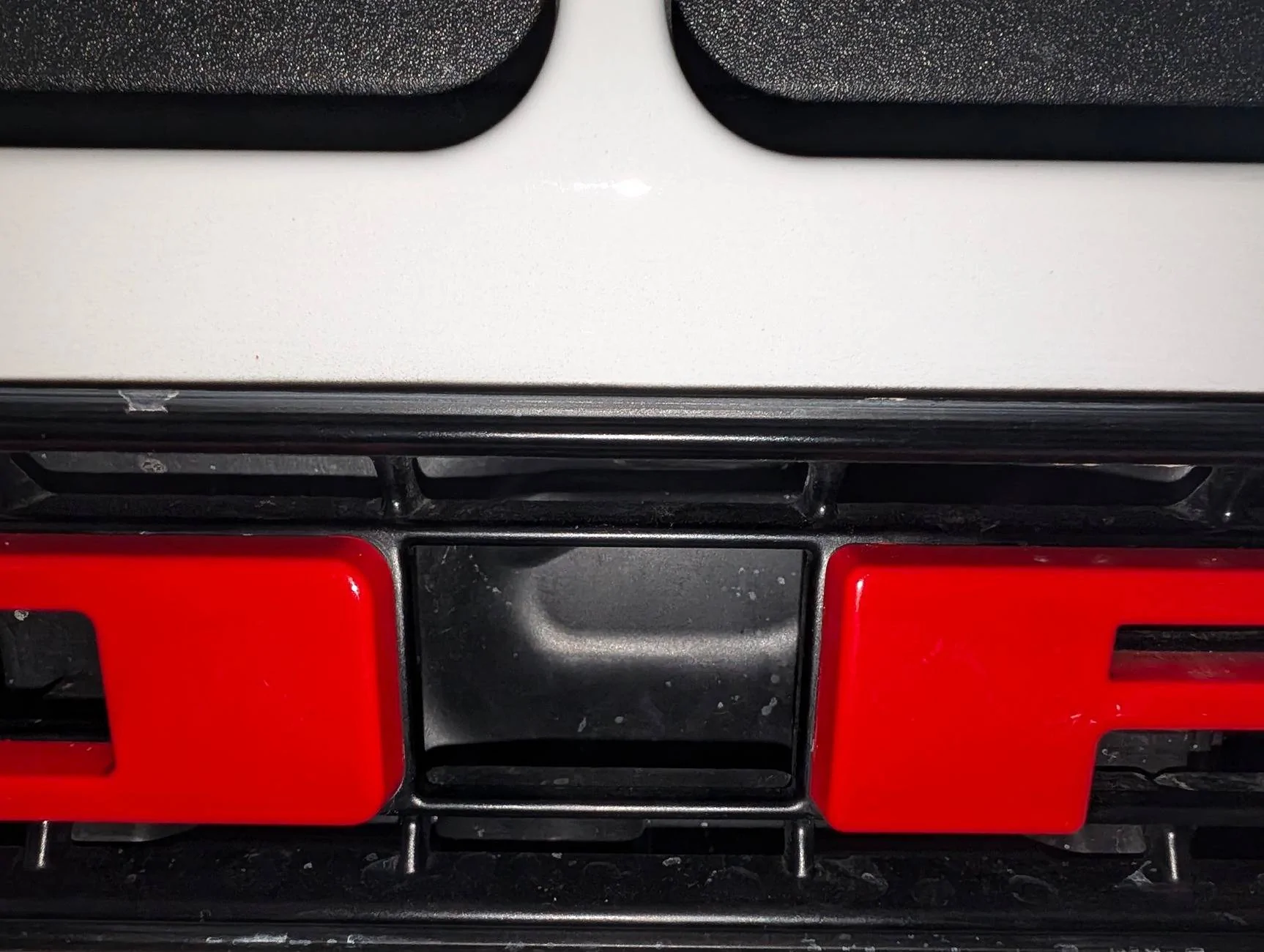

I successfully used the Naviks. Bit of final drama, but all worked out. I have a modular bumper and bull bar, so almost half the field is covered. However, it gives me the view I wanted for off-roading. I’ve not had it off road yet, so may adjust after.
Disassembly is tedious, and be careful of the airbag. The video I followed was quite helpful.

I also did the Naviks. The install video really makes it go smoothly but it takes a while. End result: I have a front camera that integrates into my 8” screen - lots of fisheye (not as annoying as I anticipated tho) but wheeling with it is kinda different. The camera flattens out everything. While it is helpful it isn’t what I was hoping for. It’s still nice to see the trail when you’re coming over a steep hill and can’t see anything but hood or sky. I may try another camera (I just used what Naviks recommended) It’s awesome for parking lots
