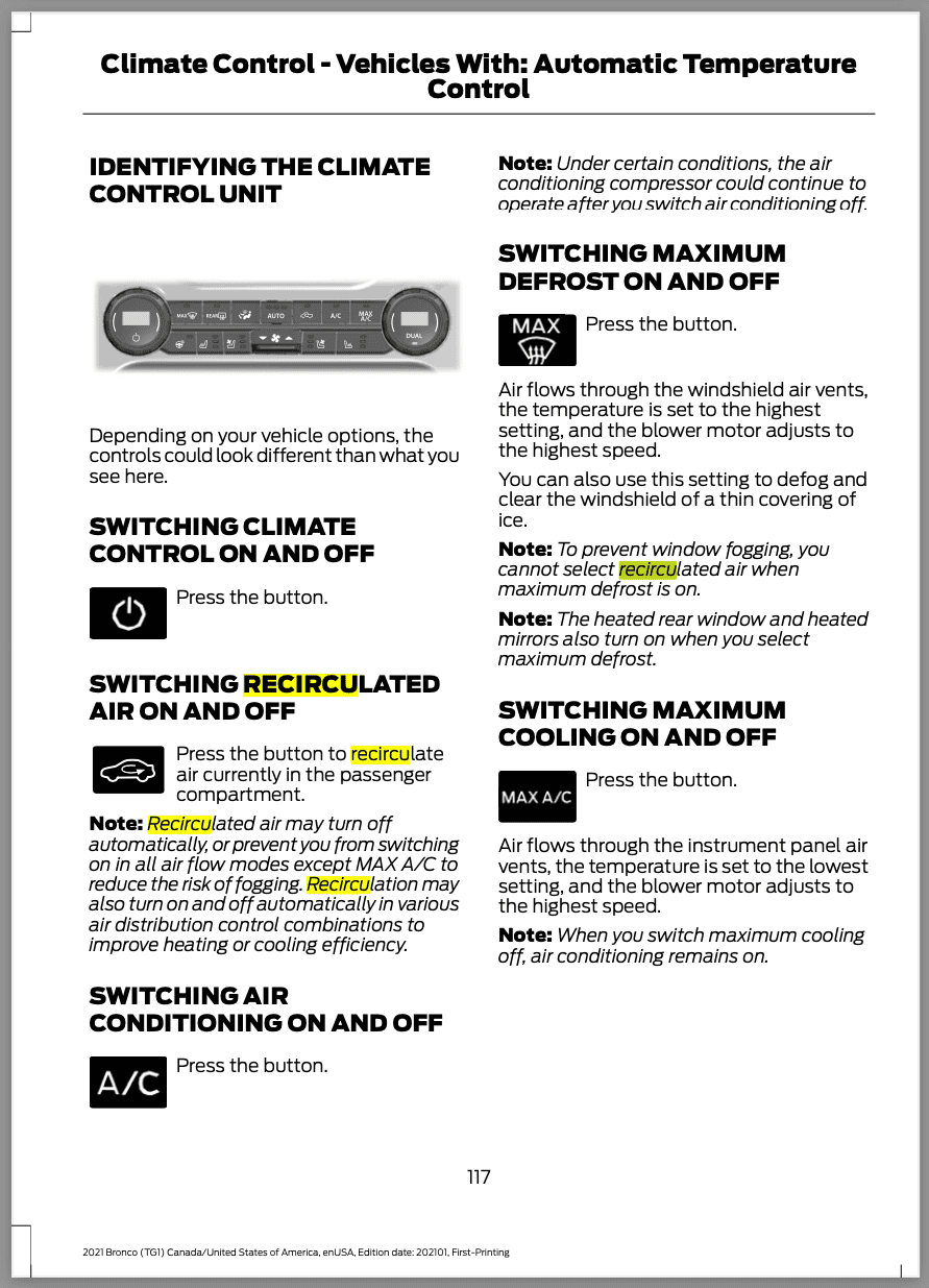

I took delivery about 3 weeks ago. The first week or so, the temperature was pretty warm so I didn't notice anything. When it turned cold again about a week and a half ago is when I noticed it. I would say it's probably been like this from the beginning.
I did some testing earlier this today, here are the results:
- When set to defrost only, it only blows air out of the defrost vents at all temperature settings.
- When set to the dash vents only, it only blows air out of the dash vents at all temperature settings.
- When set to the floor vents only, I estimate that 80% of the air blows out the defrost vents, 20% out of the front floor vents, and 0% out of the rear floor vents. At all temperature settings.
- When set to floor vents and defrost, their is no change in air flow from just floor vents. 80% to defrost, 20% to front floor vents, and 0% to rear floor vents. At all temperature settings.
- When set to floor vents and dash vents, I estimate that 80% of the air blows out of the dash vents, 20% out the front floor vents, and 0% out the rear floor vents. At all temperature settings. If while in this setting, I close all the dash vents, the volume to the front and rear floor vents do not change.
Based on this, I would also think that a mode door is not operating correctly.

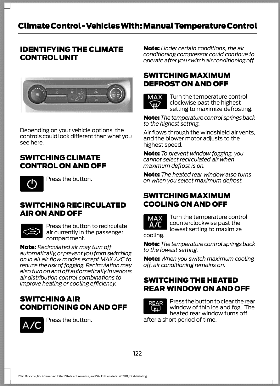

The only was recirc will stay on is in MAX AC mode. Otherwise the system decides which in my case is always off so I get to choke down car fumes and CA smoke in the summer.
I found if pressing the recirc button when not on Max AC, the recirc works for a period of time. It will eventually turn off, but works long enough to block car fumes, etc..
