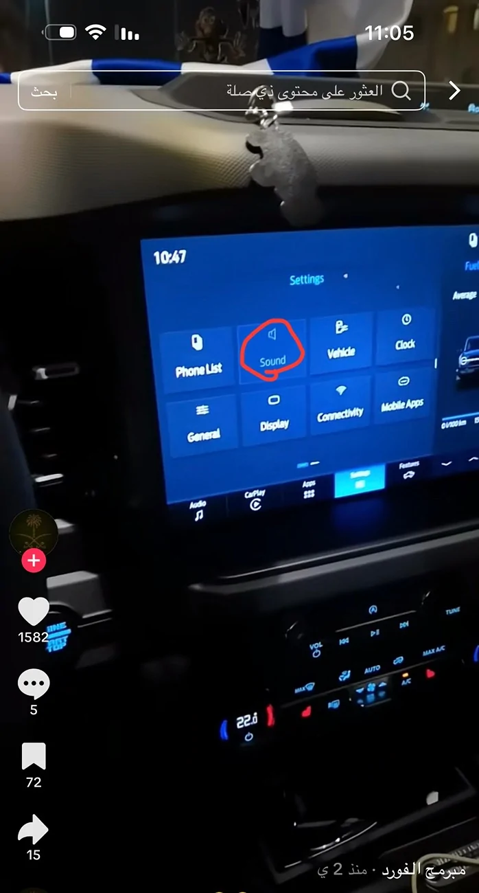

Audio system not working ,also no sound but some Tim it come healthy . I need diagram for Audio diagrams drawing .and please any one know locate of bulge of audio system
Ford Bronco Audio system not working IMG_7018

Diconnwct battery for 30 min an reboot first.

Did you try a reboot first, I think it’s hold the power and tune button together for a few seconds and it will reboot just like any other computer.
This worked for me when I had a function loss happen.

Close, it is power and the right arrow button on the radio controls. Forces a reboot.

yes

I did like that , I thank I have loss in connector

fuse? waranty?

Just get a new aftermarket head unit that's accommodates all the factory functions sound like it's fried....
