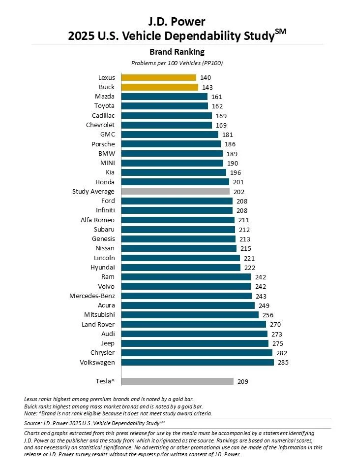

Perhaps my expectation that this very expensive vehicle should hold together as well as the Mazda I've been driving for ten years is misplaced, as is my expectation that Ford should take some responsibility for fixing known issues with its product.
Yes, I think that expectation is misplaced.
