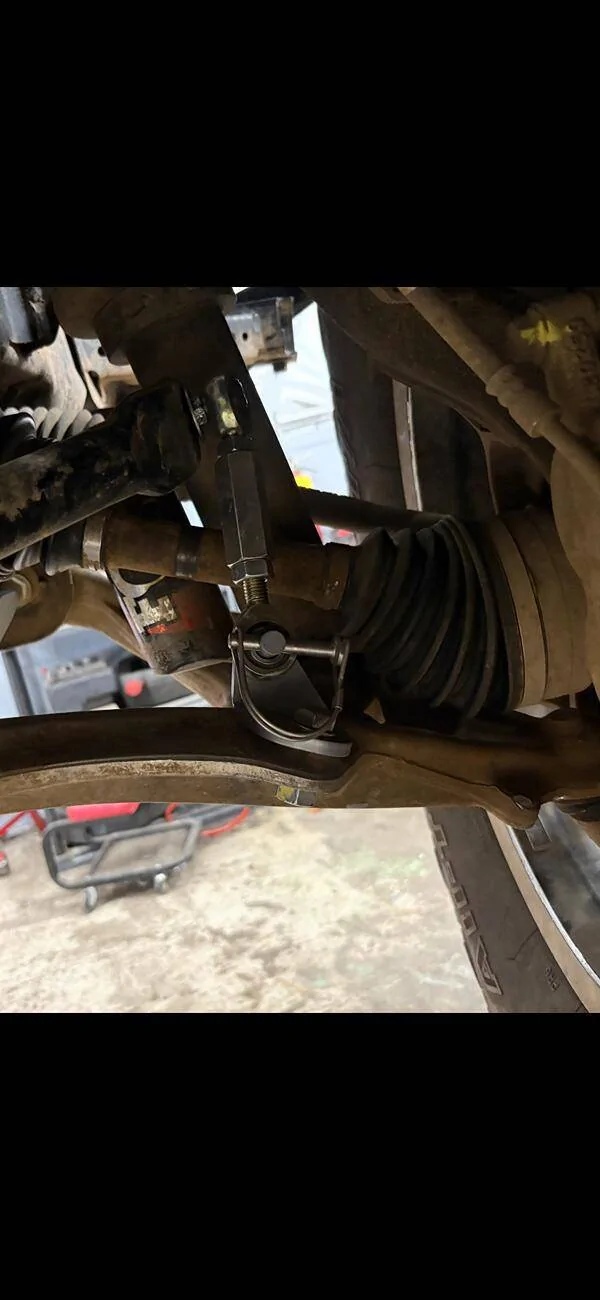

I’m manual. PLM. Took 15 minutes to install, 2 minutes to disconnect while airing down. Great on back roads to improve drive - don’t change flex or anything on my rig. Reconnect for sure speeding around town.
I will eventually just put this Boss links on because these are functional but clunky. For me putting on electrical would be overkill, and that’s saying something.

I've spent a year with the disconnected links from AcFab. Disconnecting and reconnecting is fine, so long as you find flat ground when reconnecting. But man are they clunky under normal operations, and make plenty of creaking noises.
For this reason, I have the OEM electric disconnect arriving today in fact and will be installing to an aux switch

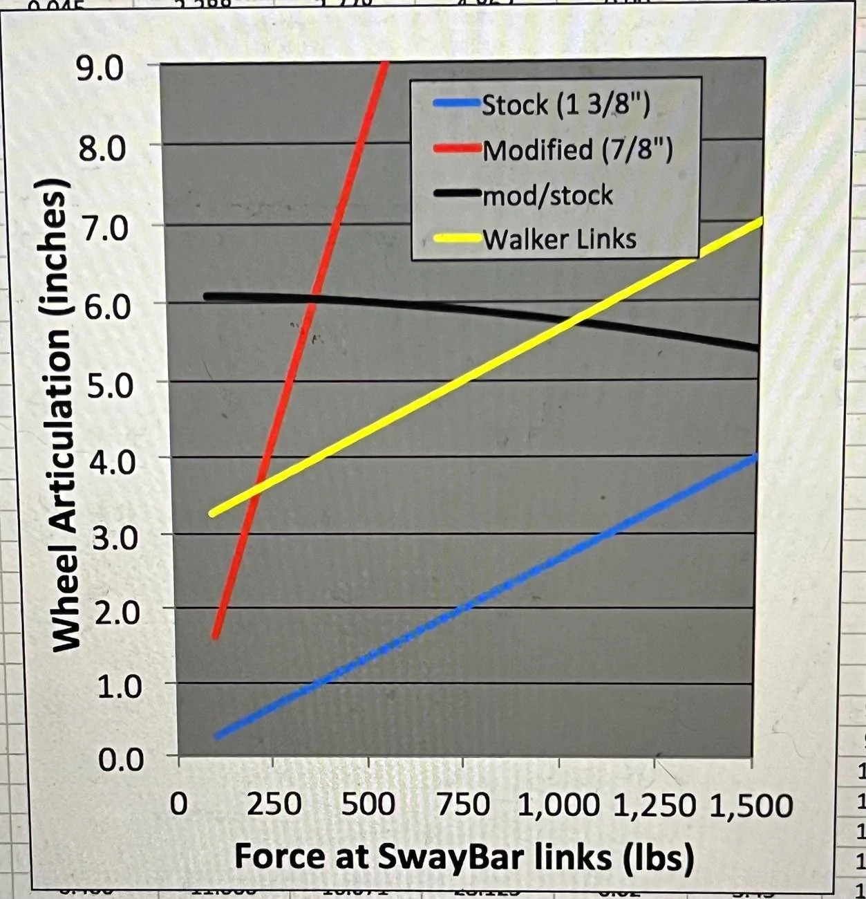

The sway bar transfers loads between the wheels (left/right), and thus limits displacements, as the wheels move in opposite directions. If both wheels are at same elevation (at ride height) then no load is transferred. As one wheel moves opposite to the other (on a left/right slope) the links of the bar become loaded. Hence the greater ease of disconnecting on flat ground.
As vehicle moves on nearly any surface the sway bar links will constantly cycle through load/unload even under small levels of articulation. The oem links/bushings provide flexibility and smooth absorption of loading cycles. A heim joint in this application will more rigidly transfer cyclical loading. Not ideal for street use, will be noisy and require maintenance.
not sure how maintenance free the boss links are??? However they do offer 3 inches of free articulation at low off-road end-link shock velocities. But still offer resistance to articulation at higher on-road shock velocities. Wheel articulation curve moves from oem to boss link curve based on end-link shock velocity. See figure.
There is nothing magical about the Rockjock bar. It is 0.875” diameter and thus provides significantly less torsional resistance than the 1.375” oem bar (4th power), and thus increased displacement. It is fairly expensive and can have some clearance issues for >25 mm offset wheels. I wish someone would make an OEM like bar that is between 7/8 to 1 inch in diameter.
the attached figure shows some basic sway bar math (wheel articulation vs loads in the links). It is easy to see that the heavy handed oem safety conscious 1.375” bar produces significant load (>100 lbs) for small articulations (<0.5”). That’s gonna make disconnecting difficult for small displacements. A 7/8” bar produces 5-6 times the flexibility of the oem bar. It also provides greater flexibility than boss links for off-road levels of articulation, (>2 inches). That is the way I would go if you can deal with the increased sway on the road.
Thanks for the math and the primer.
