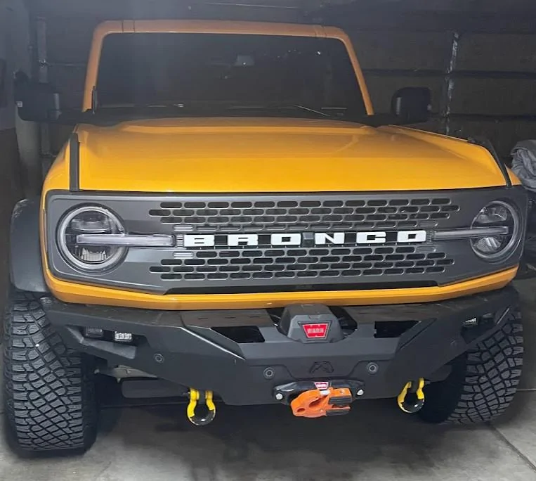

There are bumpers that have the winch mounted low as to not interfere with the camera. As mentioned earlier if you move the camera the view will be screwed up and probably not able to be adjusted. I bought a Fab Fours bumper and you can barely see the top of the Warn winch in the camera view.

Here’s a picture of my bumper

That would be perfect, I will send it to my guy that’s putting it together for me

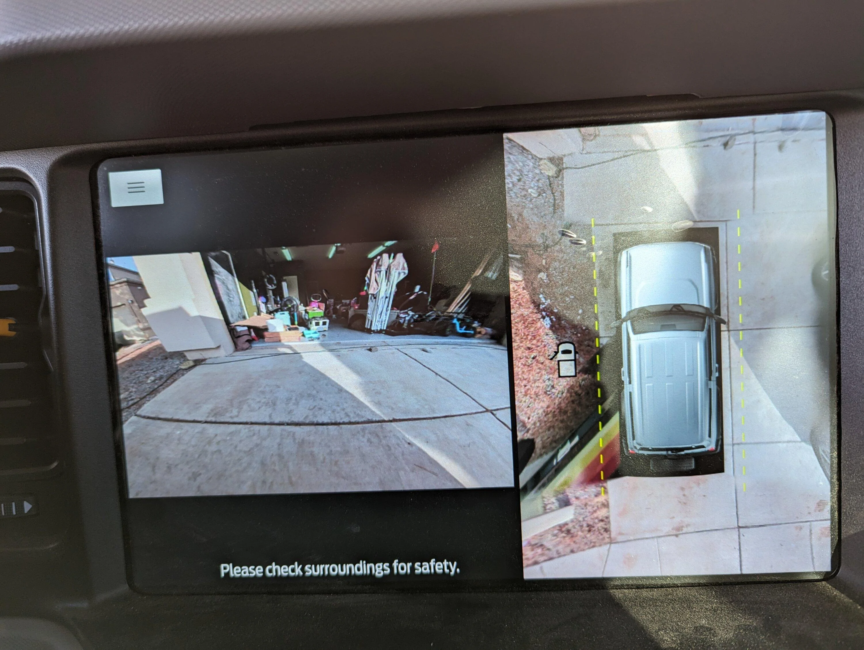

I actually just finished installing the RC high mount and I relocated my camera and washer hose to under the fairlead. The 360 can mesh is just a little off when your moving, but probably shouldn't be looking hard at that often during parking.
Didn't use any extra brackets, just a cable extended and hose extension, cut out the bottom of the "RC," drilled 2 holes for the screws, and bolted it on, with camera feed through the now more open "RC" and the washer hose through the grid hole directly below. It would definitely not fit the washer hose at least with a light bar installed.
Ignore my cluttered garage lol, 3 kids leads to disorganization lol
