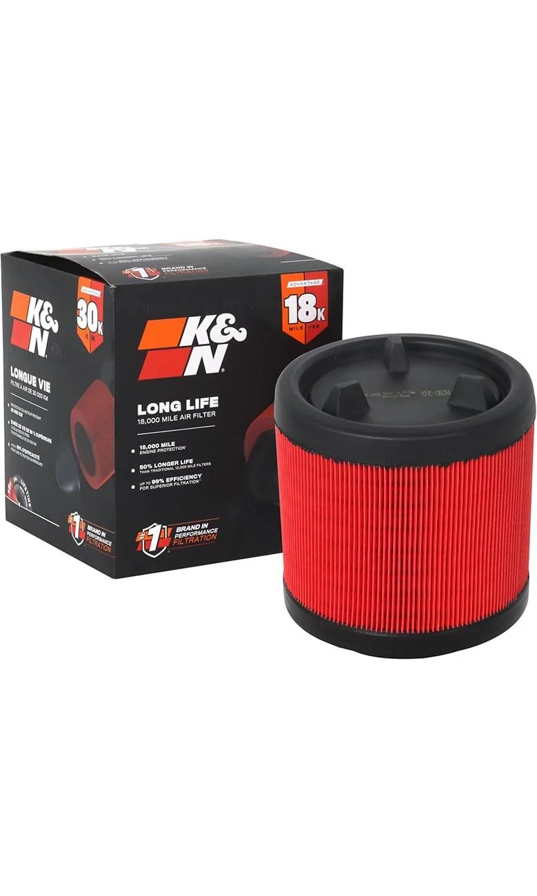

I ordered and installed one of these for $20. Would typically buy a Motorcraft but they are $10-$15 more.
Anyone try these before? Suppose to be good for 18k miles.
https://a.co/d/gVPUIkm

I did the K&N oiled filter. You can find it for less than $50.

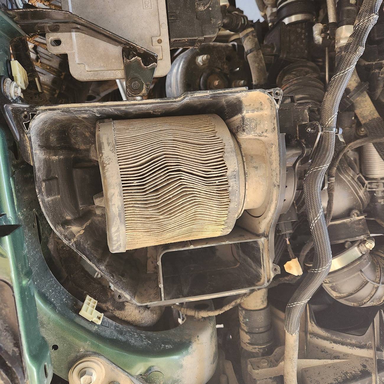

If you're bashing around in mud and dust you should look at something with a loose filter arrangement and add a prefilter bag. This is my oem basically every other weekend. The fins are so tight cleaning wasn't super effective.

To people like @Russ.Cere who are hard on filters - K&N can be cleaned in the field easily. But to most other people’s point - you could also just carry a spare paper filter as well. And I won’t deny they do let more dust pass than a paper filter, although I don’t know if that has a measurable effect on longevity or maintenance.
