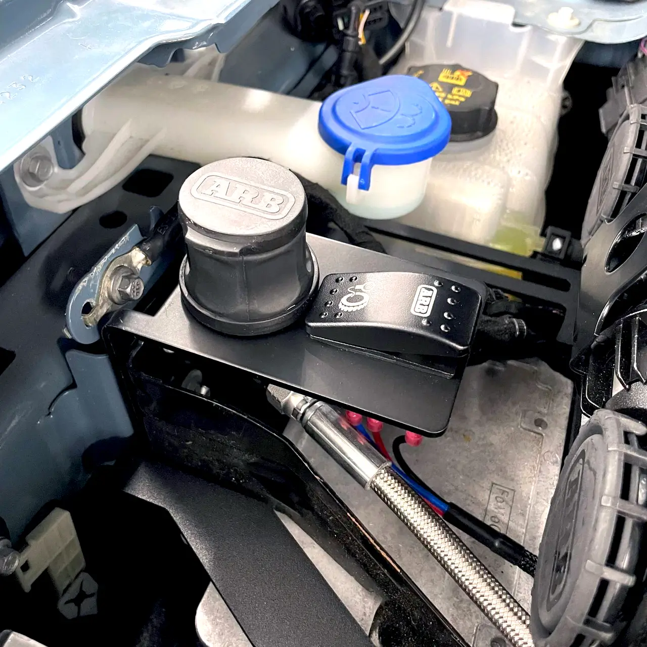

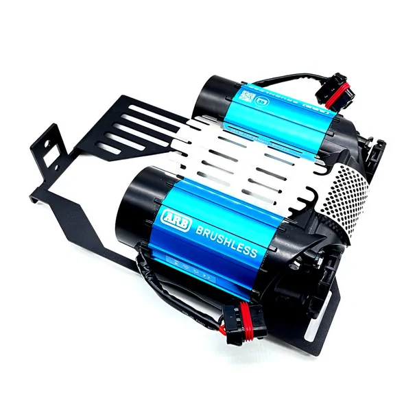

Sooo the manifolds do help by cooling down the air before they hit the hose. Are they required though? No, not required. 99% of our customers don't rock a manifold and have ZERO issues. The air hoses we sell are high-temp hoses so they work well. You DO NOT want to get a cheap amazon special air hose if you're not going to run a manifold though. Those cheap hoses are cheap for a reason. They are not reinforced. Those harbor freight specials... same deal... not reinforced or designed for the extra heat.
We sell the onboard kits with the new brushless here: https://www.4x4truckleds.com/kr-off-road-air-compressor-engine-bay-kit-for-2021-ford-bronco/
Ford Bronco ARB Brushless Compressor with Manifold? 1770149753074-9c
Ford Bronco ARB Brushless Compressor with Manifold? 1770149776987-jy
Add on a pump up kit so that you get the better hose.
What a lot of our customers do is they add on our switch/coupler kit. This includes a stainless steel hose and relocates the air coupler so the air cools down a bit before hitting the hose. No manifold needed, easier to access the air coupler and it looks nice. It also frees up an upfitter switch

Our kit works with the brushless. The only difference is the brushless does not have a plug and play switch. Otherwise our kit works.

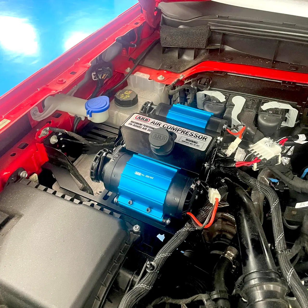

Is your coupler installed in our switch/coupler bracket like this
Ford Bronco ARB Brushless Compressor with Manifold? 1771167922602-q6
Or on the actual air compressor like this:
Ford Bronco ARB Brushless Compressor with Manifold? 1771167937899-mu

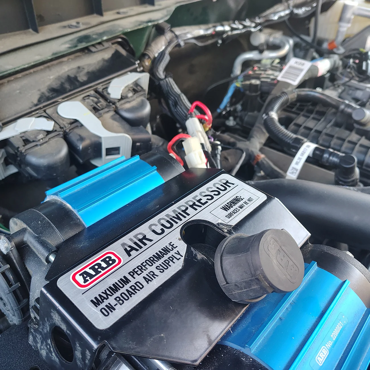

If it's on the actual air compressor like the 2nd photo... your coupler is hitting the hood because you did not angle the coupler. You have to angle the port on the compressor down to allow for the coupler. ARB allows this and there are instructions that came with your air compressor on how to do this. Basically you insert an open end wrench onto the side, loosen a bolt and then you can angle the port down, then tighten the bolt back up.

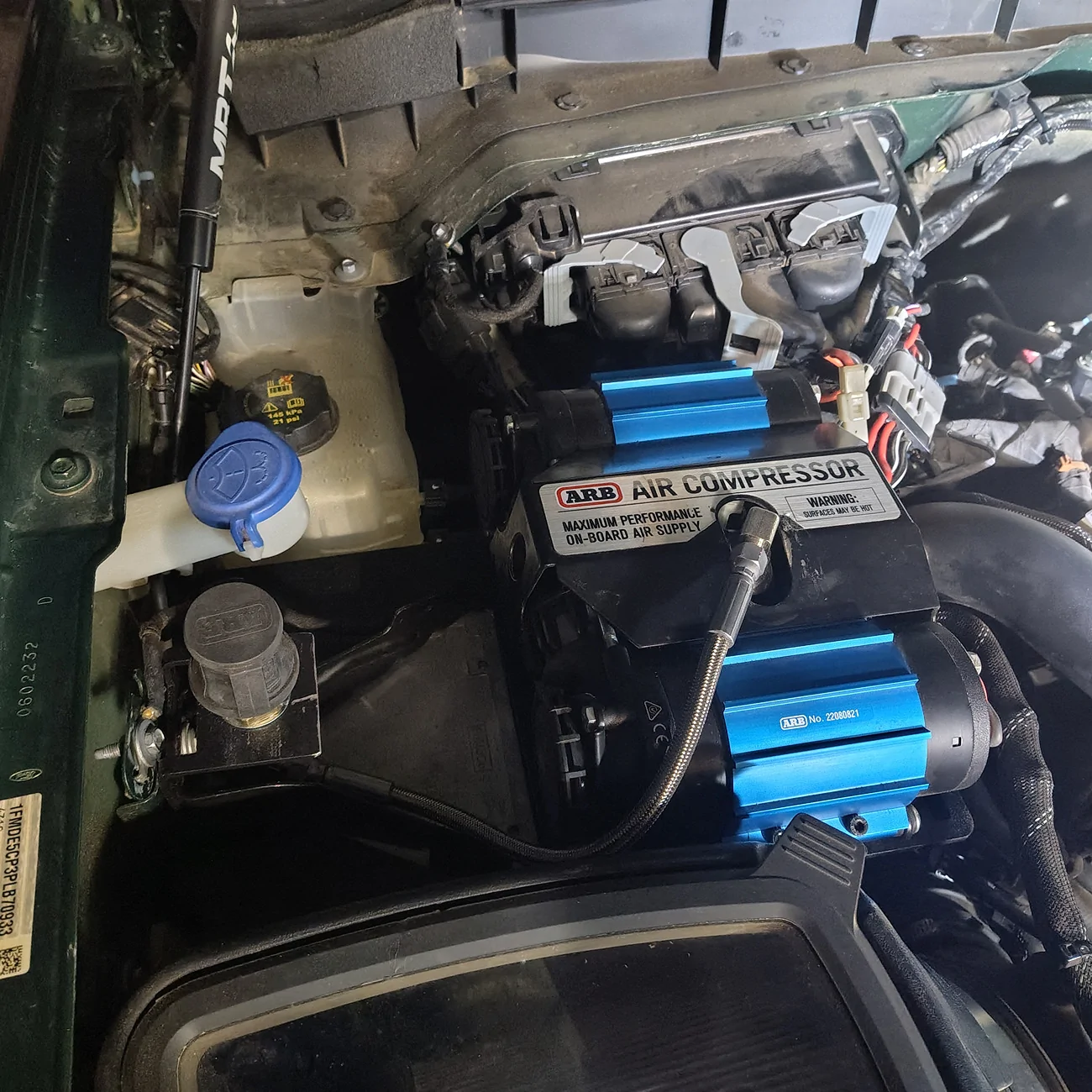

I will never do business with yall again, after you accusing me multiple times, saying I didn't install it correctly and then calling me a liar saying it won't hit the hood!
I forgot to post the pic. Yes, I did install it properly thank you very much! I cut off the area on the bracket where the switch goes, because I hardwired it to my Upfitter switches.
Ford Bronco ARB Brushless Compressor with Manifold? IMG_20260119_174051658_HDR
But once I noticed the hood was sticking up, I removed the bracket and installed it on top of the compressor! It doesn't even touch the hood now. Not a big deal, but shitty of you to say I didn't install it right! I've been doing my own work/repairs/upgrades for 35+ years...

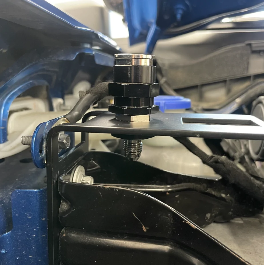

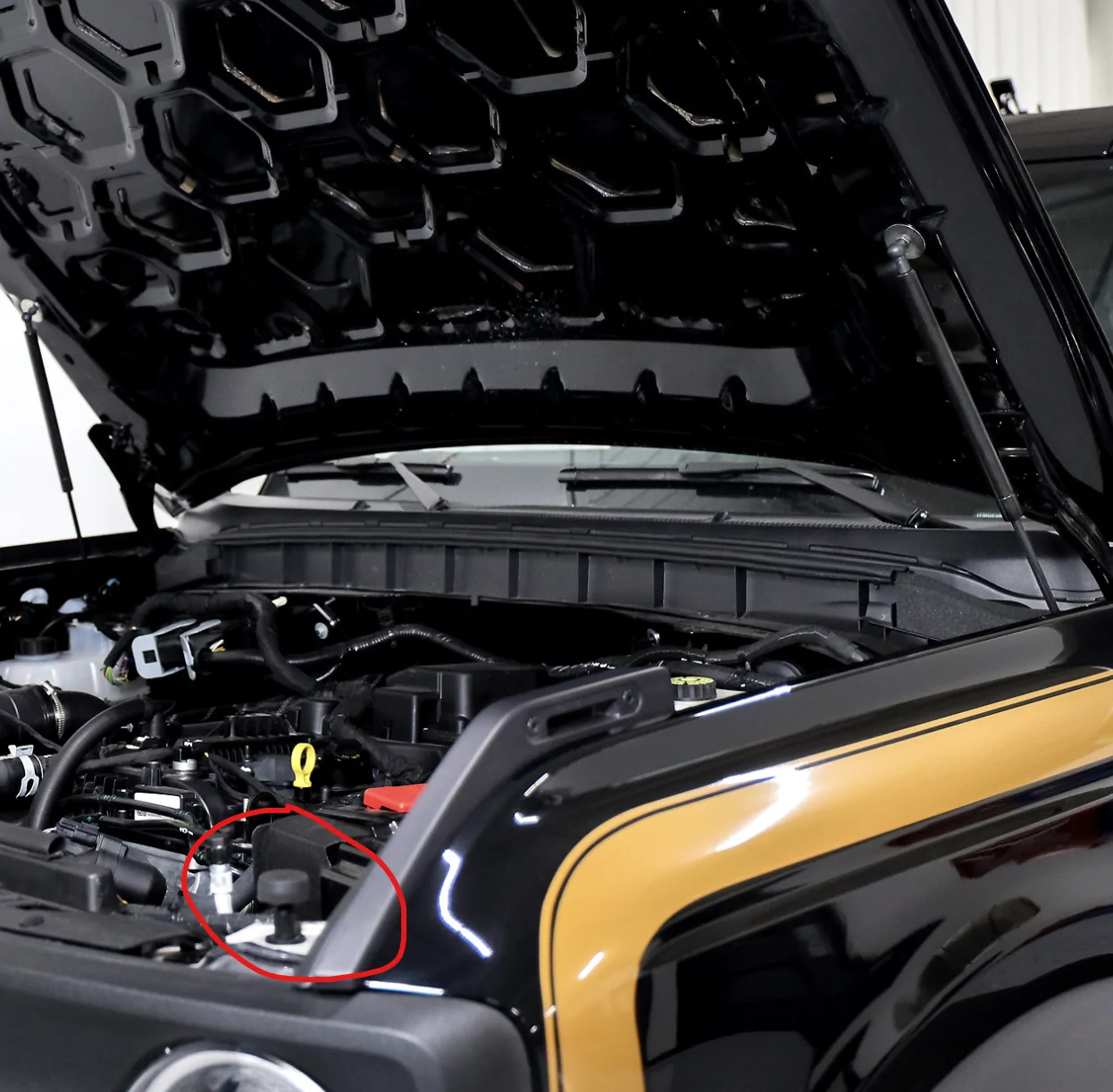

Our coupler bracket sits below where the hood sits, as you can see in this photo (yes the coupler rubber adds more height but not so much it goes above and interferes with the hood). In fact, our switch/coupler bracket allows the coupler to sit LOWER then if it were installed on the actual compressor itself...
My guess is that you need to adjust your hood spacers. I see you have an aftermarket shock system to support the hood, which usually requires more downward pressure when closing the hood.
Ford Bronco ARB Brushless Compressor with Manifold? 1771169976450-rg
On your truck try adjusting the 2 hood bump stops. As I said I've yet to come across a Bronco that didn't have hood closure issues without having to adjust these. It's a common issue
