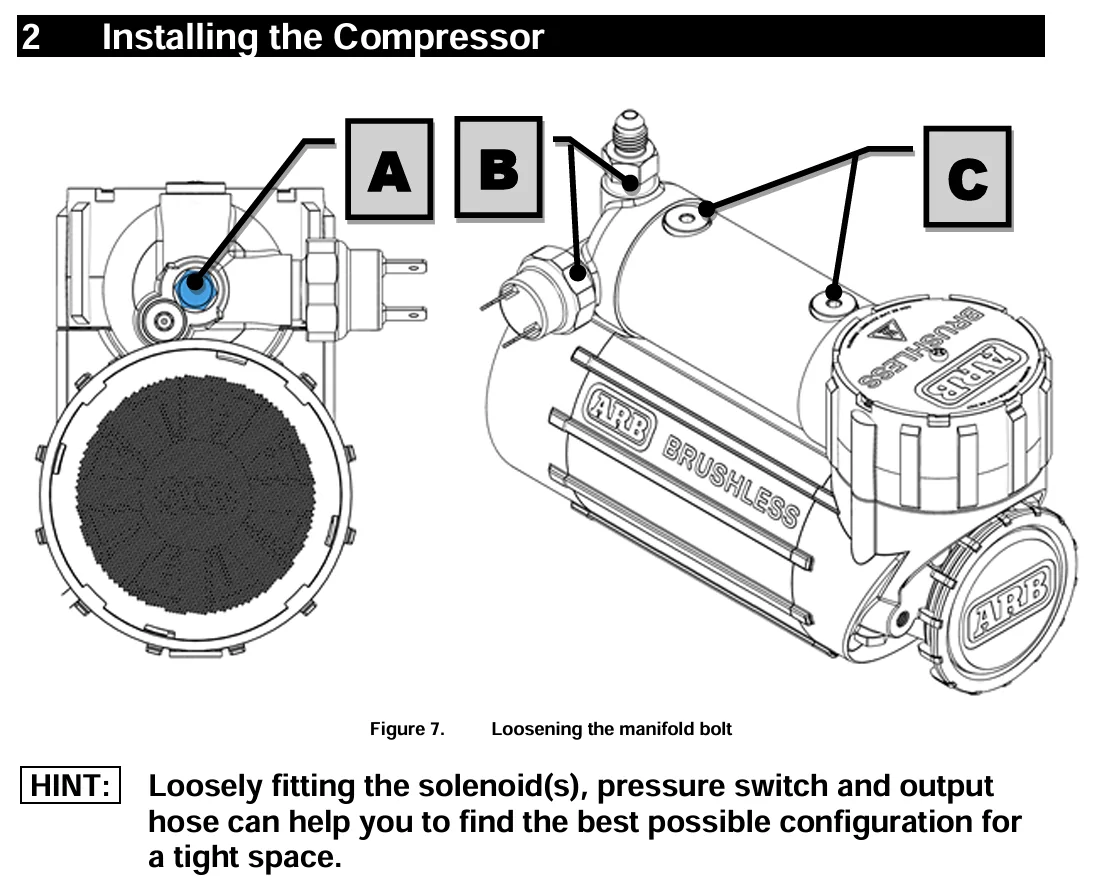

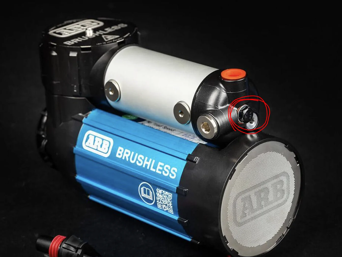

Looks good. im not sure if you are aware, but that silver air canister ROTATES :) So you can actually rotate it so everything sits how you want. You may know that. If others do not... loosen this bolt up and you can rotate the canister to point your air port where you want. Also another thing to note... you CAN USE some of the ports on the silver canister. There are TWO additional ports you can connect accessories to! So you are not forced to use the 2 on the end, but you have TWO MORE. Soo that may have helped with your install as you could have had the pressure switch and coupler on the same side.
Ford Bronco ARB Brushless Single Compressor Install 1758671421150-7a
Ford Bronco ARB Brushless Single Compressor Install 1758671694280-it
The new brushless compressors ARE faster however as you noted, different noises. The other oddity is the location of the air port and pressure switch port. Both the twin and single now have a pressure port and air port (previously the twin's was buried inside somewhere out of the way).
This just makes for awkward installs if you're used to the OG Twins. Not bad, just "different"
Also... they don't sheeth the wires anymore. Sigh... not sure why. We do it in our shop when we do installs but out of the box, they are not protected in a wire loom. We always recommend customers add a wire loom.
The brushless are faster but add maybe 15-30 minutes to the install now because of some extra steps.
Yes, I did rotate the silver canister a little. Now I didn't take off the fittings on the "top" of the cylinder labeled C, but they look to be smaller diameter ports than the ones labeled B?? So the pressure switch fitting wouldn't screw in there??
When you say the wires aren't sheathed. You mean the positive red wire and back near the connections to the compressor? The up fitter wiring loom is wrapped.
Correct. They no longer put a wire loom (sheething) around the wires. The red and black wires are not protected. I like to always ensure wiring is protected with nylon braided wire loom (or plastic wire loom if you can only find that)

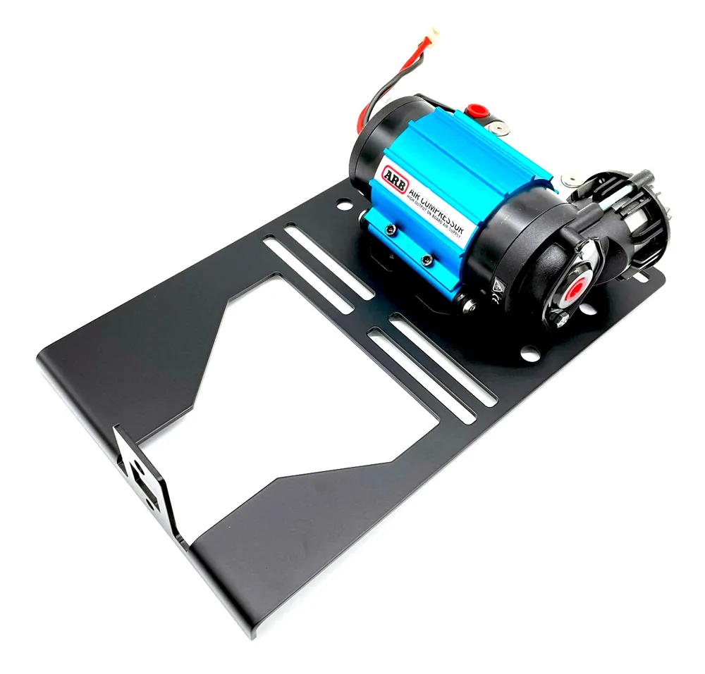

I'm interested in the single brushless compressor with a vertical mount. I wish someone would produce a mount for it instead of making you use a twin mount that takes up more space than needed.
Why not just go with our mount. You're not using that space for anything anyway so what's the problem using our mount? It's why we designed it, as it's compatible with single and twin air compressors. Keeps the compressor up high for easy access. Easy to install. And you save $$ on the kit using the coupon code BRONCO6G sooo best of everything!
https://www.4x4truckleds.com/kr-off-road-air-compressor-engine-bay-kit-for-2021-ford-bronco/
Sample photo of the single (brushless looks similar mounted)
Ford Bronco ARB Brushless Single Compressor Install Single1
