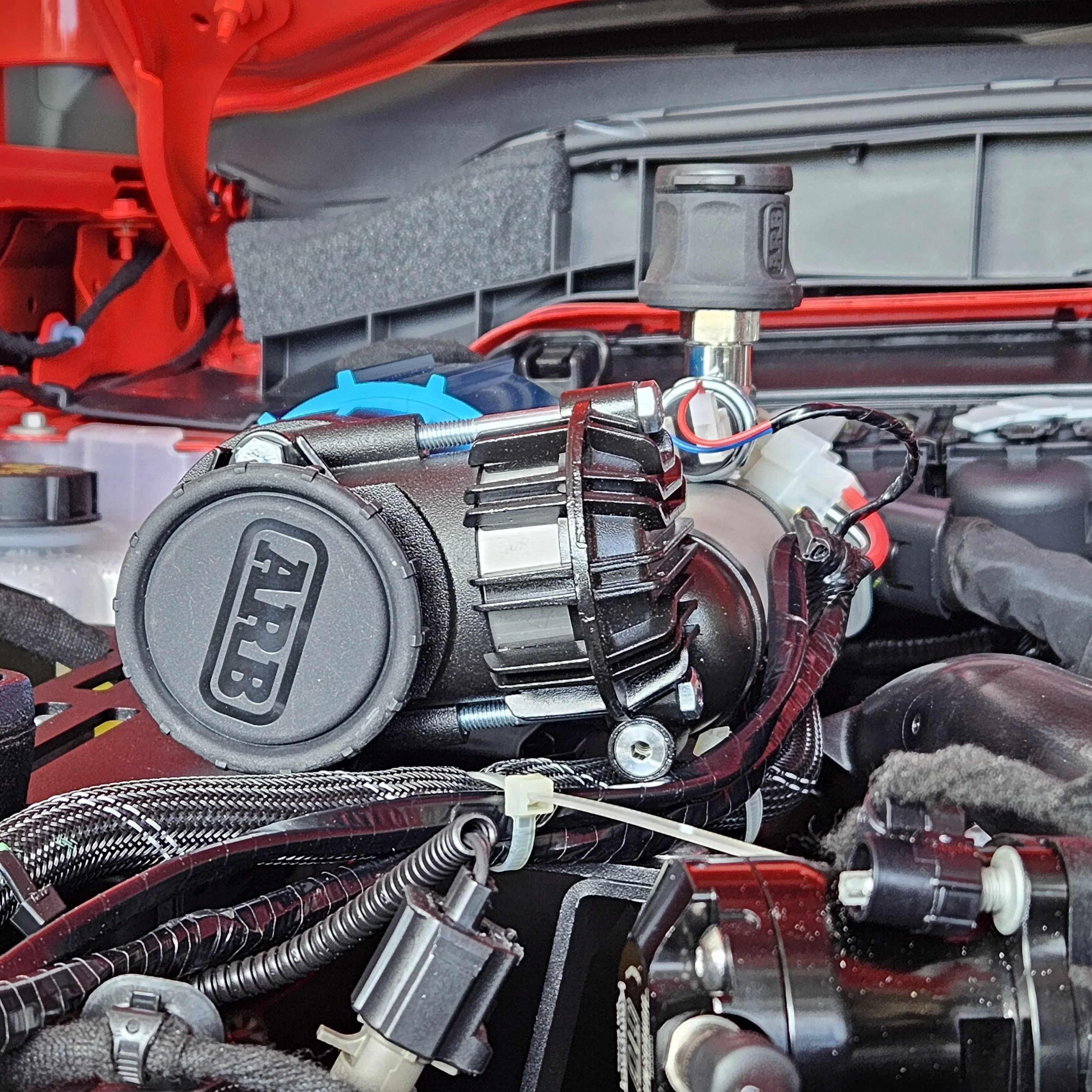

Im not sure what you did in the solonoid install that keeps you from shutting your hood because of contact with the air connector. The solenoid is necessary because the voltage to power the unit does not come from the switch but from the supply wire and therefore the switch wire simply shuts it on and off. At least that's my understanding. I agree that the lower bracket connection to the shock bolt is extremely difficult. By all accounts as you say the double ARB is much easier to install and the wiring harness works right without much interference or adaptation. I had four wheel parts to my wiring because I found it too complicated. I suggest that you rotate the unit in a different way so that it sits under your hood. See mine below.

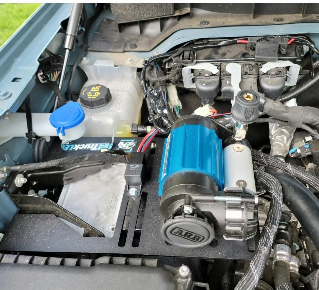

I had it that way initially, but then I added the pressure switch. The pressure switch part of the harness didn't reach over to the other side, so I rotated the unit as far back as possible to plug in the red/blue pressure switch harness. I don't think it's hitting, but it's close.
I see you didn't install the pressure switch on your set up. If I redo the set up without the pressure switch, then I could rotate back. I was instructed I had to have pressure switch, but I guess not.

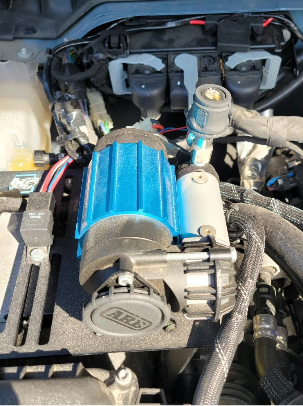

I took your advice and switched it over. Much better set up, and no need to adjust every time.

Excellent! My pressure switch/solonoid is on the other side, out of view! I installed the unit and bracket, 4wp installed the solenoids and wiring. I've done my own boat wiring for years, but I could not understand the instructions for how to wire this, and using the upfitter switches. Paying someone else to do the wiring? Priceless! I admire your ability to do that yourself!
