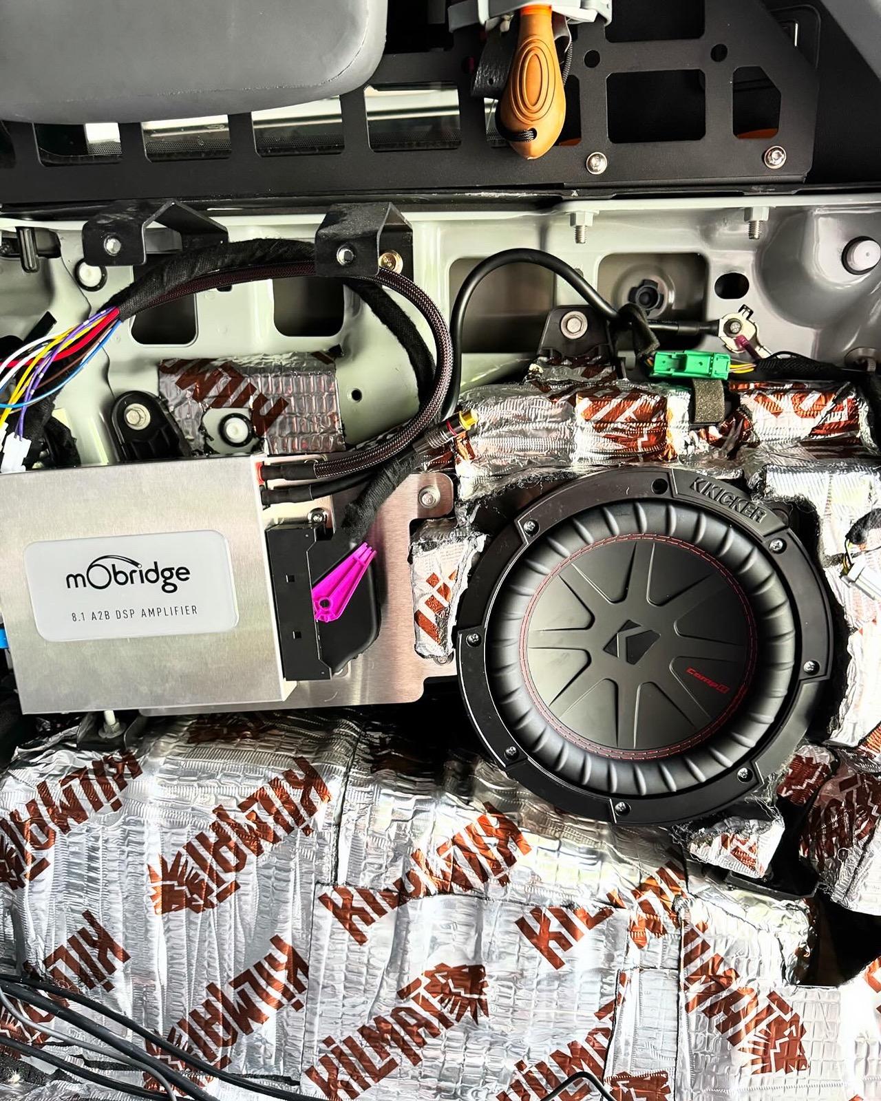

Un fortunately we do not have a tune for the audiofrogs. Have you got a microphone? Happy to help you tune it up further if needed.
Yeah, I did purchase a microphone but that was the one thing I couldn't find how to integrate with the Mobridge software... So I tuned it by ear.
It was the UMIK-1 microphone.
You cant view the mic via our software.
You want to get pink noise playing through the system at a loudish volume and mute all speakers, one by one use REW's RTA viewer (room eq wizard, start with 1/3rd octave if this is your first time tuning) to view the mics input, and then make adjustments in mObridge DSP, you will see this take affect in real time.
