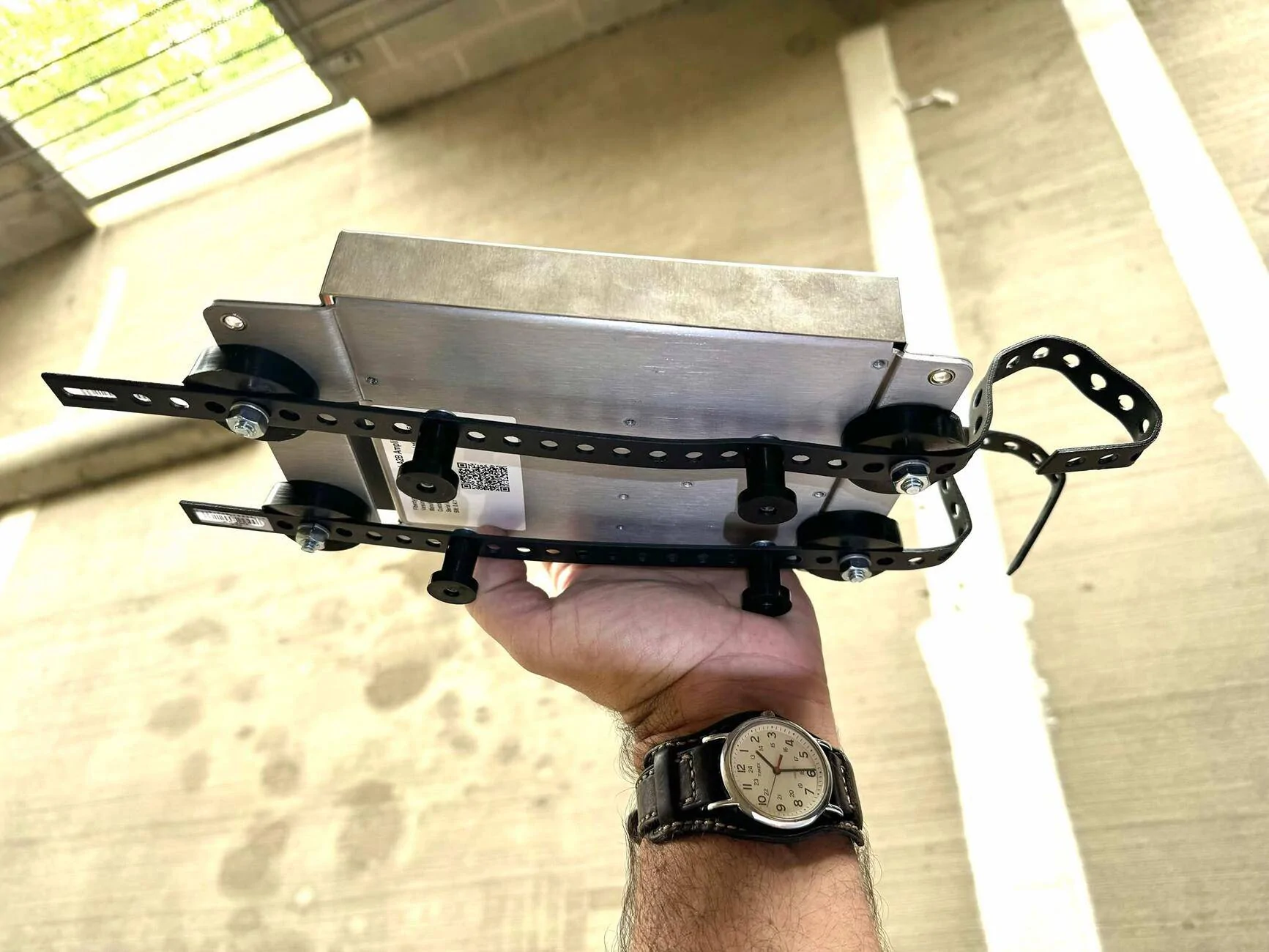

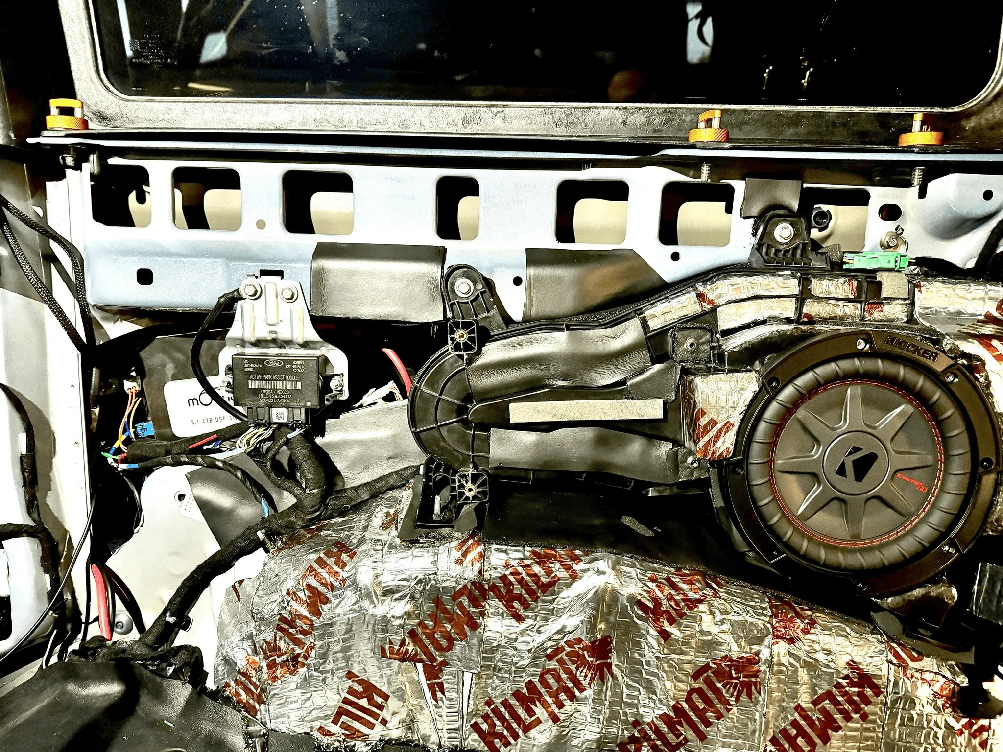

It's a little more tricky in a 2-Door, but it can be done! The Mobridge system was designed for 4D folks in mind.
I managed to shoehorn it into the wheel well space.
Very nice, definitely something on my to-do list down the road. I have a 2-door also so if you have any more pics of how you stuffed the amp in there would be great. Have you had any heat issues as that seems that area is enclosed with no air circulation?

*warning - this is some driveway engineering*
I took it off the mounting plate so it would fit, and had to make a bit of a "cage" to hold it in place with some thick rubber offsets to press against the outer wall of the wheel well.
That area of the wheel well has a big "well" that drops down and if I were brighter, I'd have made a little 3D printed "shelf" for it to sit on and mount to. It's just held in place by the "arms" of the little cage - but it's very solid and doesn't move.
pro tip: you need some industrial-level tools to make a hole in the frame here - tried multiple bits and unibits so I could at least get a bolt in to secure it properly and couldn't make more than a divot , so gave up and went the "cage" route.
The curved parts of the "cage" I bent in place to act as pseudo "springs" to keep the DSP firmly pushed in place in it's little hidey hole.
It stays in place well, absolutely zero issues.
Ford Bronco B & O speaker upgrade. 1733063624810-hs
