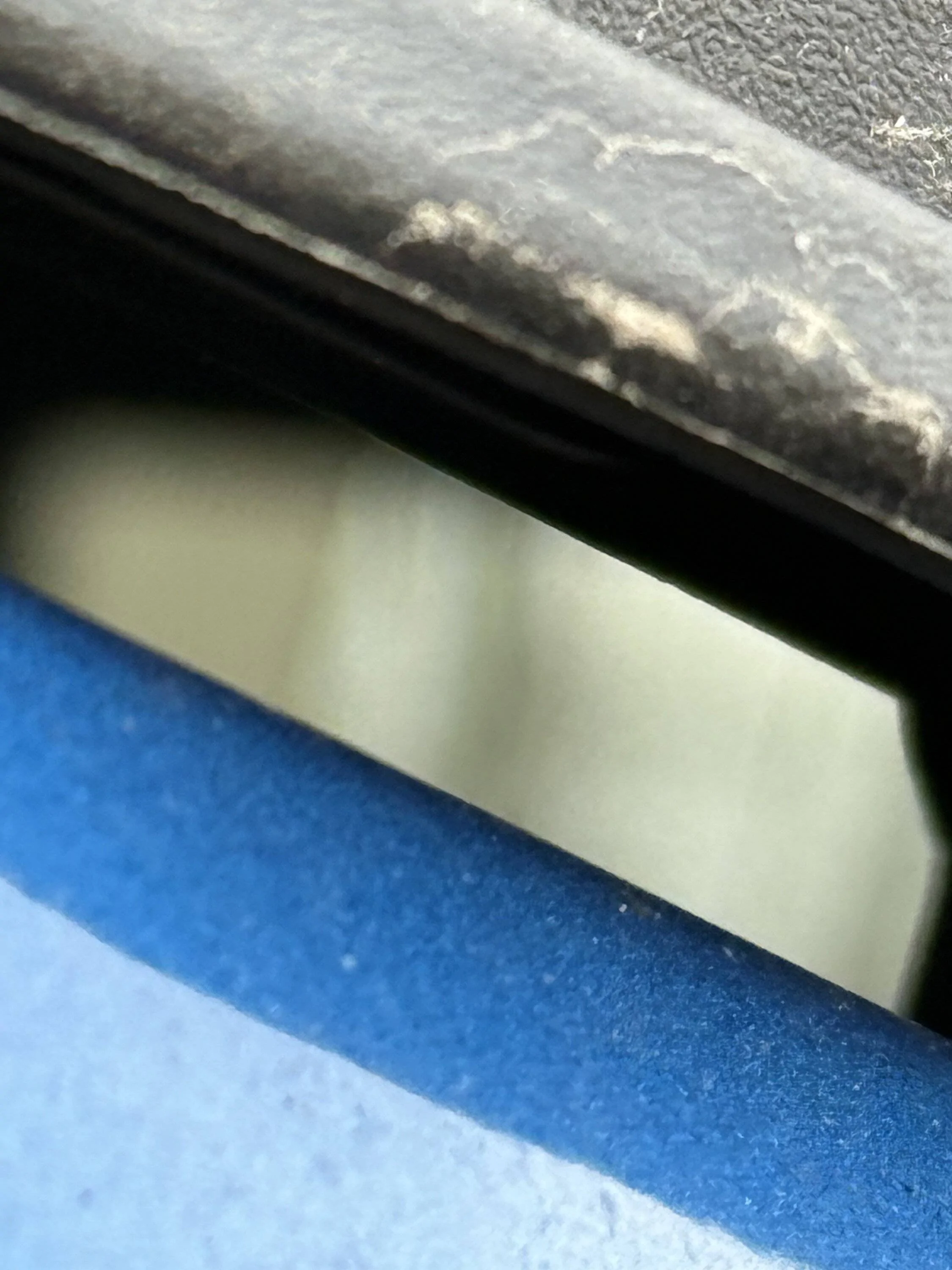

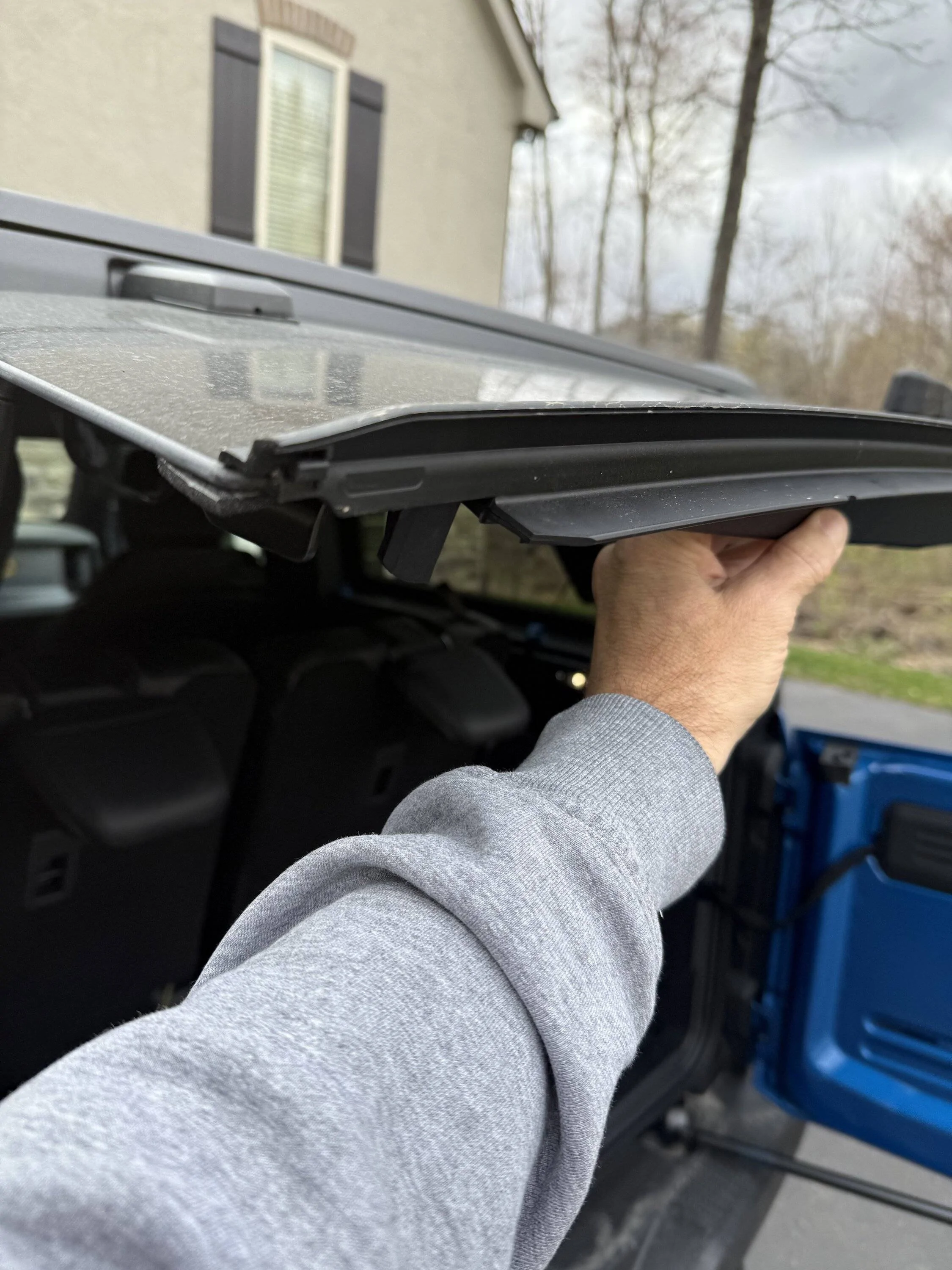

Did the dealer forget insulation on my back window? What does yours look like?
Ford Bronco Back Window Tailgate Insulation IMG_2098
Ford Bronco Back Window Tailgate Insulation IMG_2099
Ford Bronco Back Window Tailgate Insulation IMG_2100

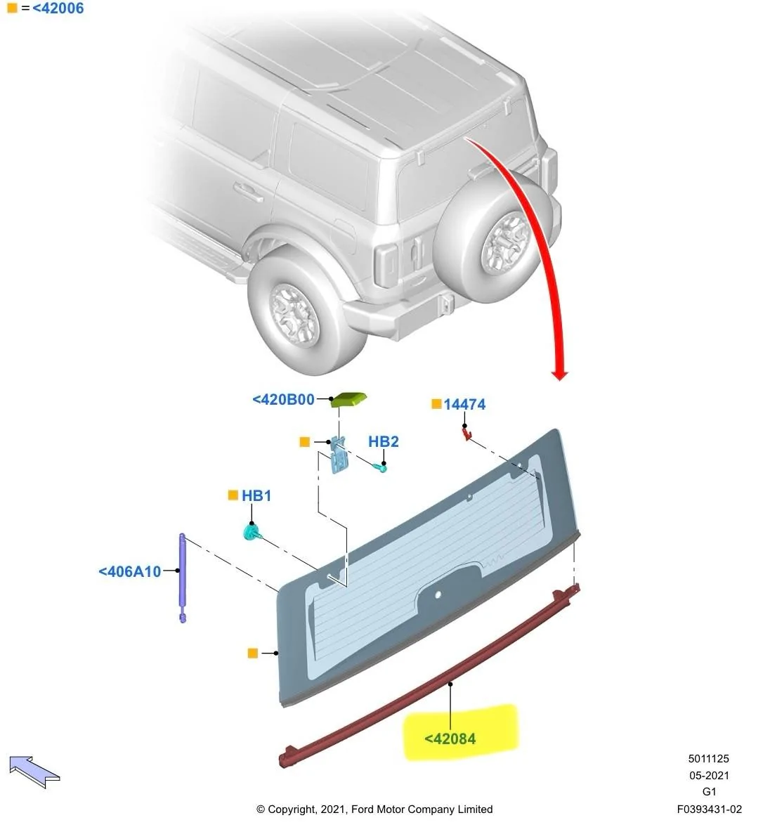

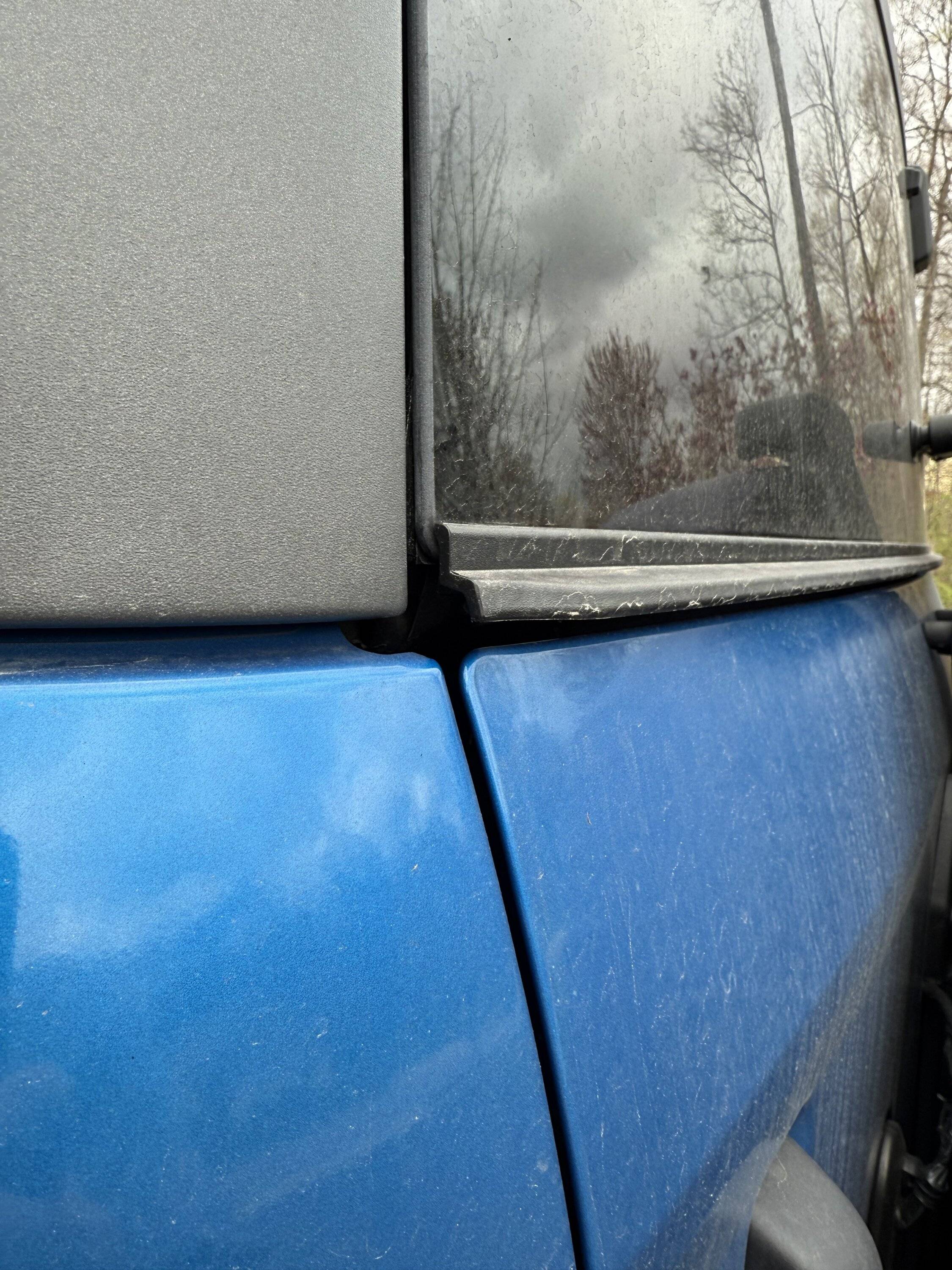

Yes. The lower seal is missing
M2DZ-7842084-A
Ford Bronco Back Window Tailgate Insulation IMG_7279
