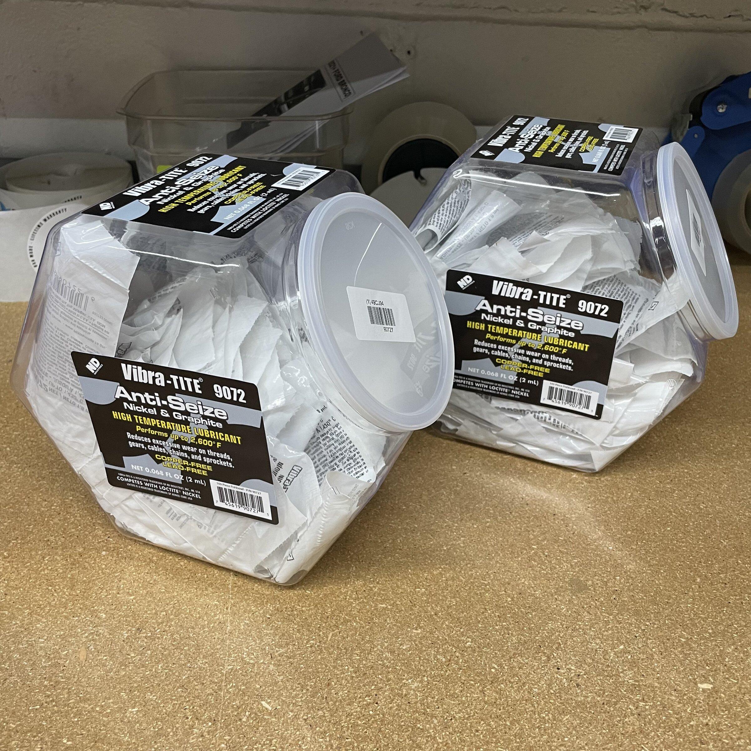

they are not provided by us - it’s part of the Baja Designs hardware kits they include with their lights
we’ve raised these concerns to Baja Designs which is why they are sending us anti seize lubricant to include with the lights - they believe they had a bad batch of hardware

Baja Designs provided us with anti-seize lubricant
All orders for fog kits going out today from our warehouse will include a baggie of anti-seize lubricant
