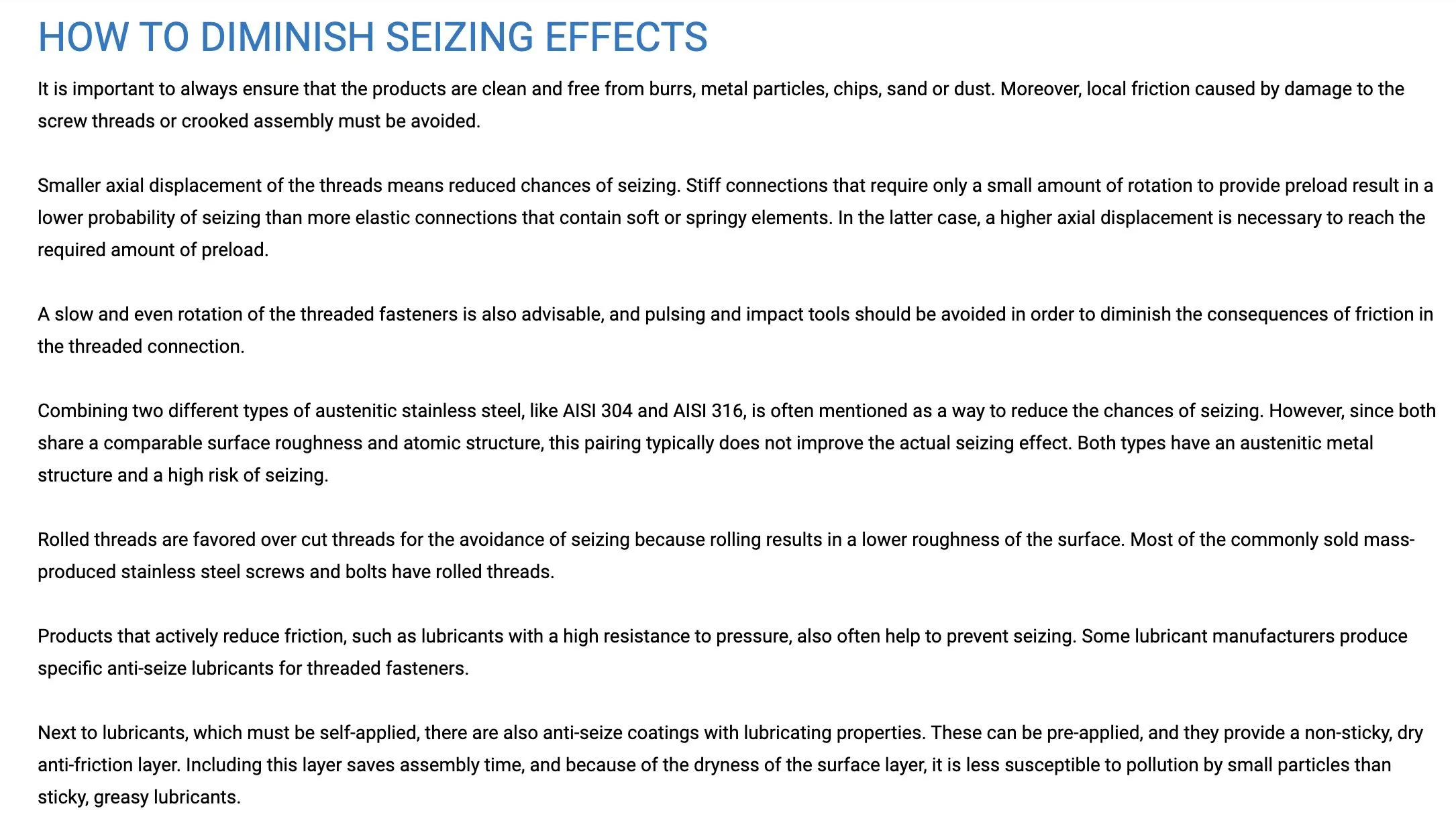

Hold on, the fact is this should have never happened , that’s why they are including anti-seize giz… I have never had a bolt/nylonnut seize in my 45 year life… this is truely pathetic that it’s not being head on addressed by BD or 4x4 considering a 1,000+ purchase !!!
Here's a good article/explanation on the why it happens with stainless steel fasteners and the different solutions. Definitely something that should have been addressed earlier by BD, and can be addressed in a few ways, including different specs on the stainless steel fasteners.
https://www.fabory.com/en/knowledge...teel/the_seizing_of_stainless_steel_fasteners
A couple highlights:
On threaded fasteners (e.g., nuts and bolts), there is a large buildup of pressure on the contact surfaces in the thread flanks, which leads to intensifying friction and adhesion, and it may lead to seizing of the threads. Products made from austenitic stainless steel or aluminum are always more sensitive to this effect in comparison to steel products, which is because since these metals are more ductile and have a crystalline atomic structure. For this reason, austenitic stainless steel fasteners present far more seizing problems than steel fasteners."
Products that purposely affect higher friction in the threads (e.g., lock nuts that exert a clamping force in the threads) greatly increase the chances of seizing.
