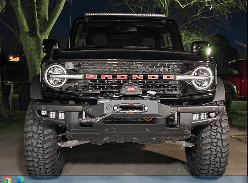

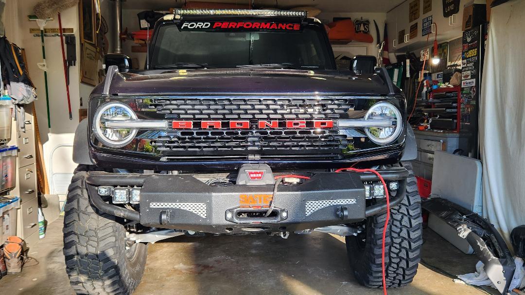

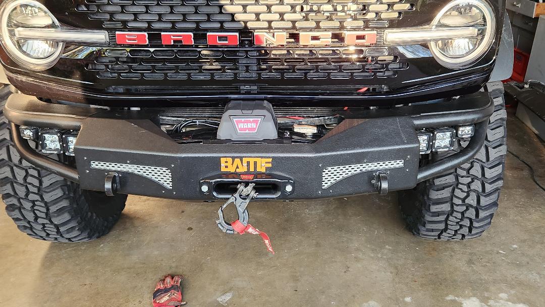

Hi Jerry, thanks for the hook up great deal. The bumper and winch install went very easy.
I used my stock bumper bolts this allowed the bumper to hang off and down and I dropped the winch in place and slide it left and right to gain easy access to tighten all the bumper bolts. Then just bolted the winch down went very quick. As far as the ACC and bumper senses. left all that crap off. I did even know I had the ACC.

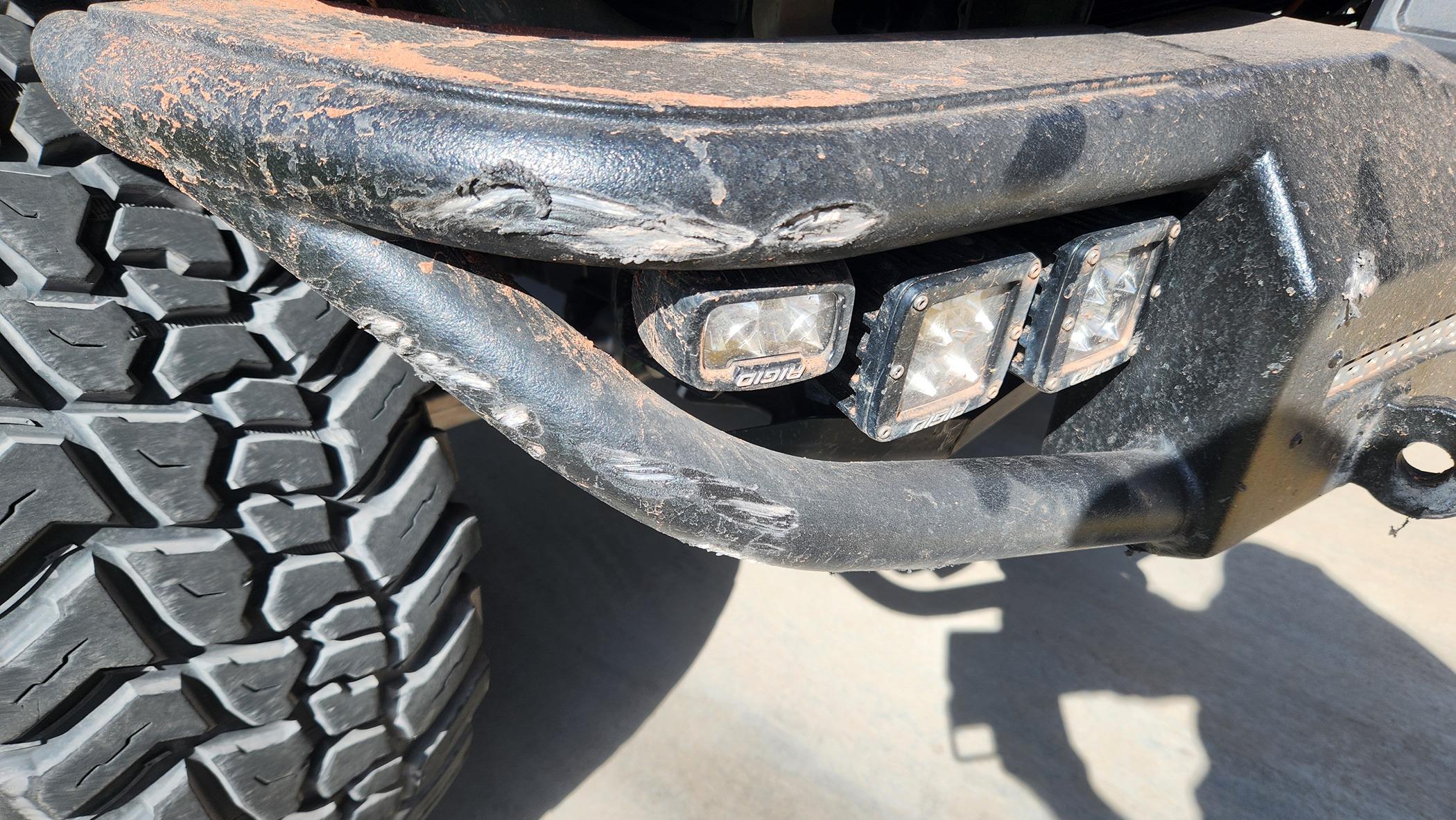

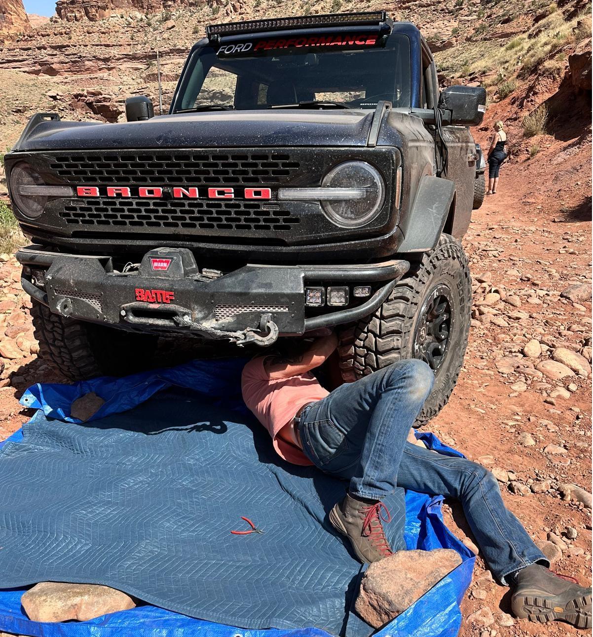

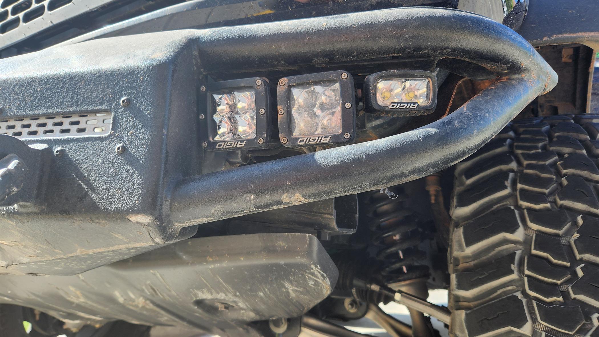

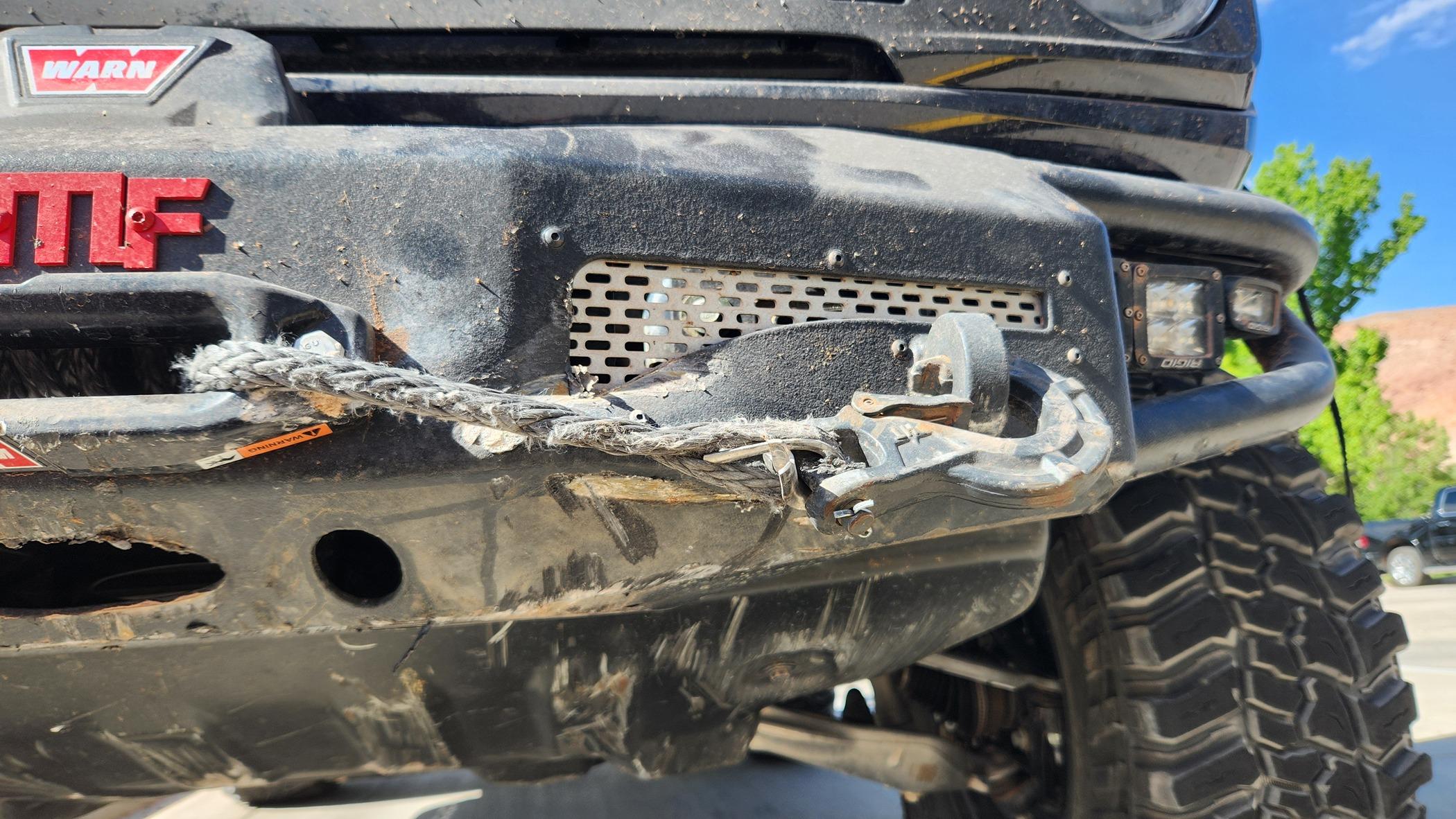

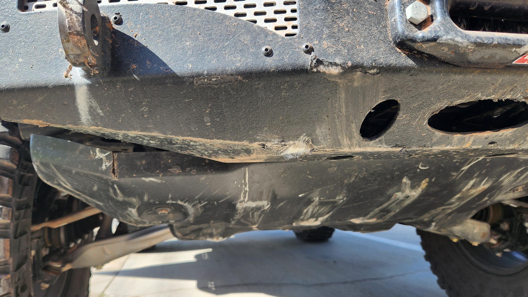

Hi Jerry, like I said the scratched bumper would be used. I was in Moab last week a the bumper took a beating. First photo replace tie rod on Cliff Hanger. Thanks Eric
