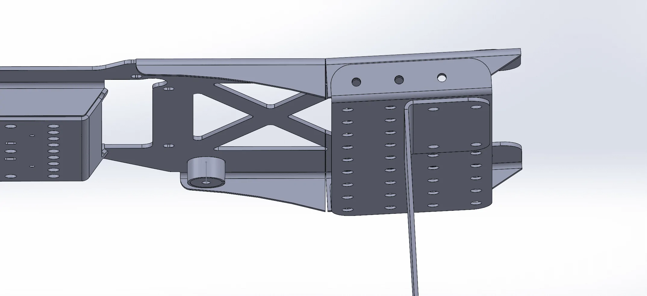

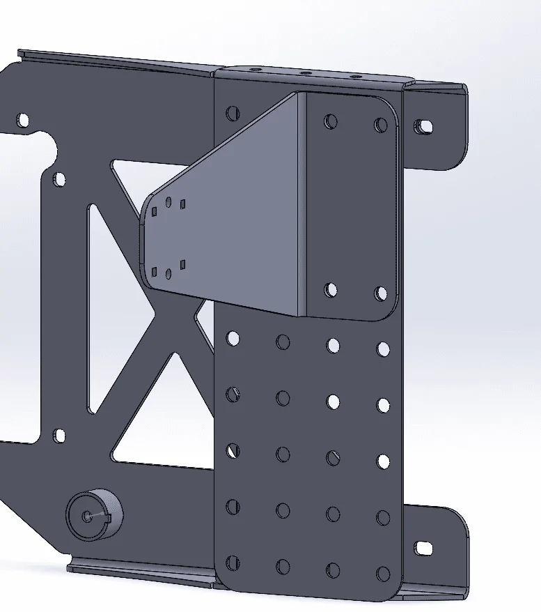

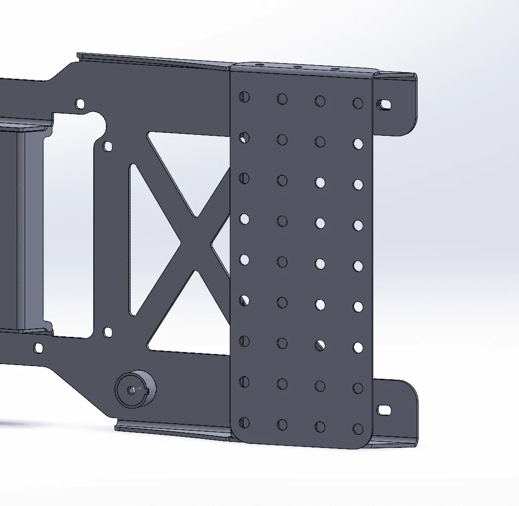

The tail gate bracket now has clearance added for the factory sasquatch wheels an tires. We also added the universal mount plate and rotopax mount to the site. the Jerry can holder as well as other mounts will be on the site shortly.

Did you clearance the center section? My BAMF bracket interfered with mounting my OEM spare tire carrier and I had to file some corners down to try to get it to fit. Eventually I grew tired of filing and cut the center section completely out (because it is not needed for anyone running a spare and it shaved off nearly 10 pounds).

Yes the whole section has been tucked back .375" to also clear the inside of the tire mount.

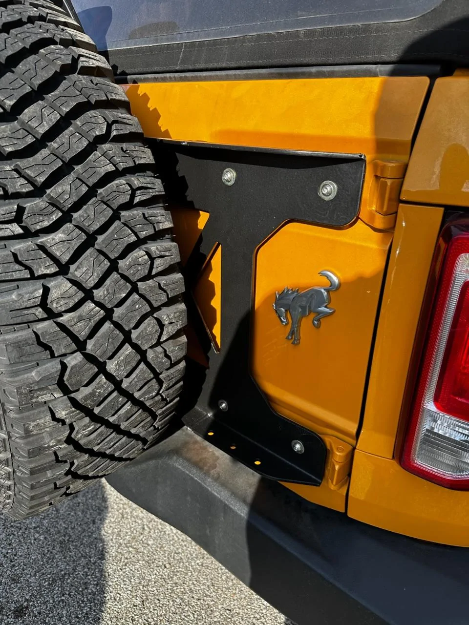

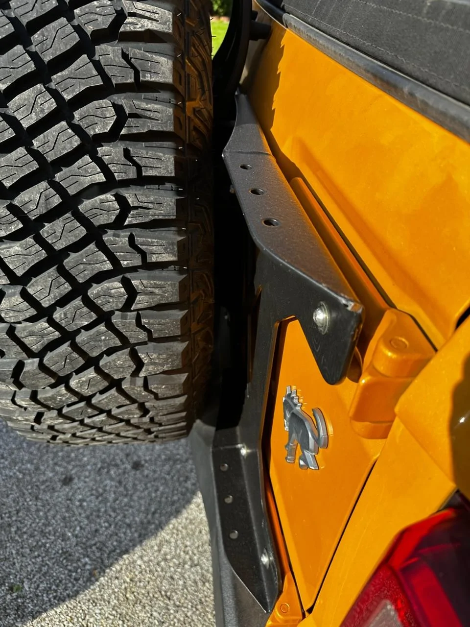

So I installed my reinforcement bracket tonight. Unfortunately it mustve been bent in shipping, it was almost 2.5in to flush from the hinge holes to the tire carrier holes. I bent it back to the best but it's still wonky af.
How do yall center the tailgate afterwards? I'm finding it feels more solid while closing but it's sitting low on one side.
The mount itself is top notch work, and the coating is sweet.

I used shims under the gate and in the sides after removing the spare but before loosening the gate...so when I added the bracket the gate did not move. If you did not do that, add shims under the gate on the sides so it doesn't drop, remove the spare and loosen the carrier and the hinges and adjust the gate level side to side. When you adjust height on the driver side, make it so that the part on the pillar lightly contacts the bottom of the striker mechanism on the gate (the nylon/plastic glide part..adjust the shims accordingly). That way, even though the gate will be slightly higher on the driver side than it is on the passenger side, when your spare is back on the latch will be centered in the striker.

Thank you! I went outside and adjusted everything, got it centered on all four corners and it looks amazing.

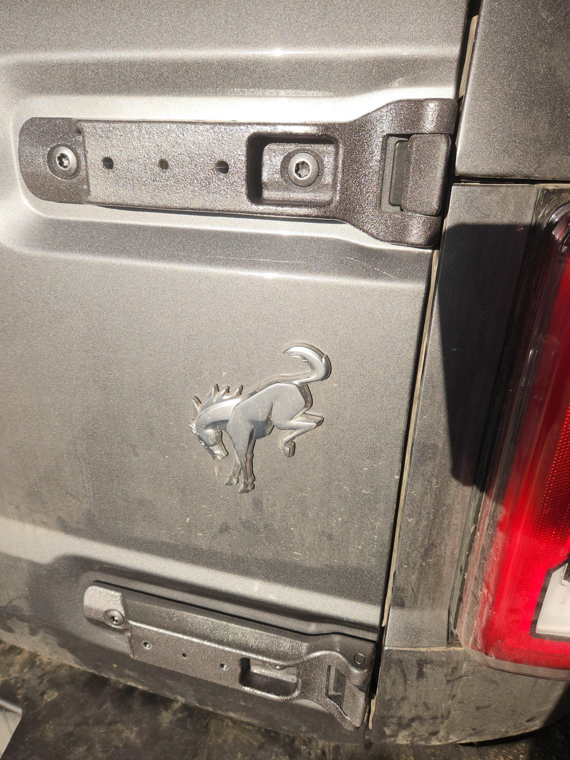

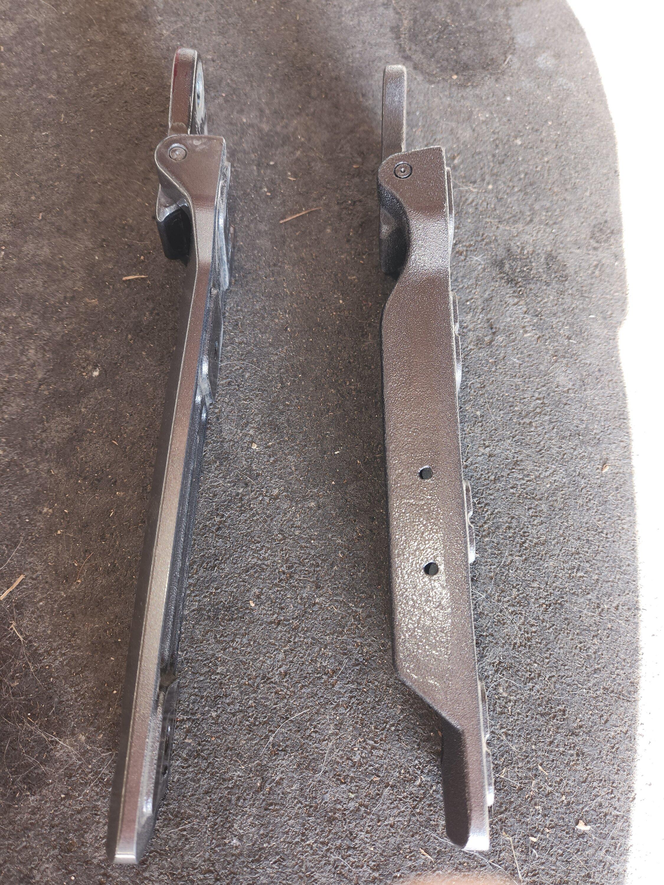

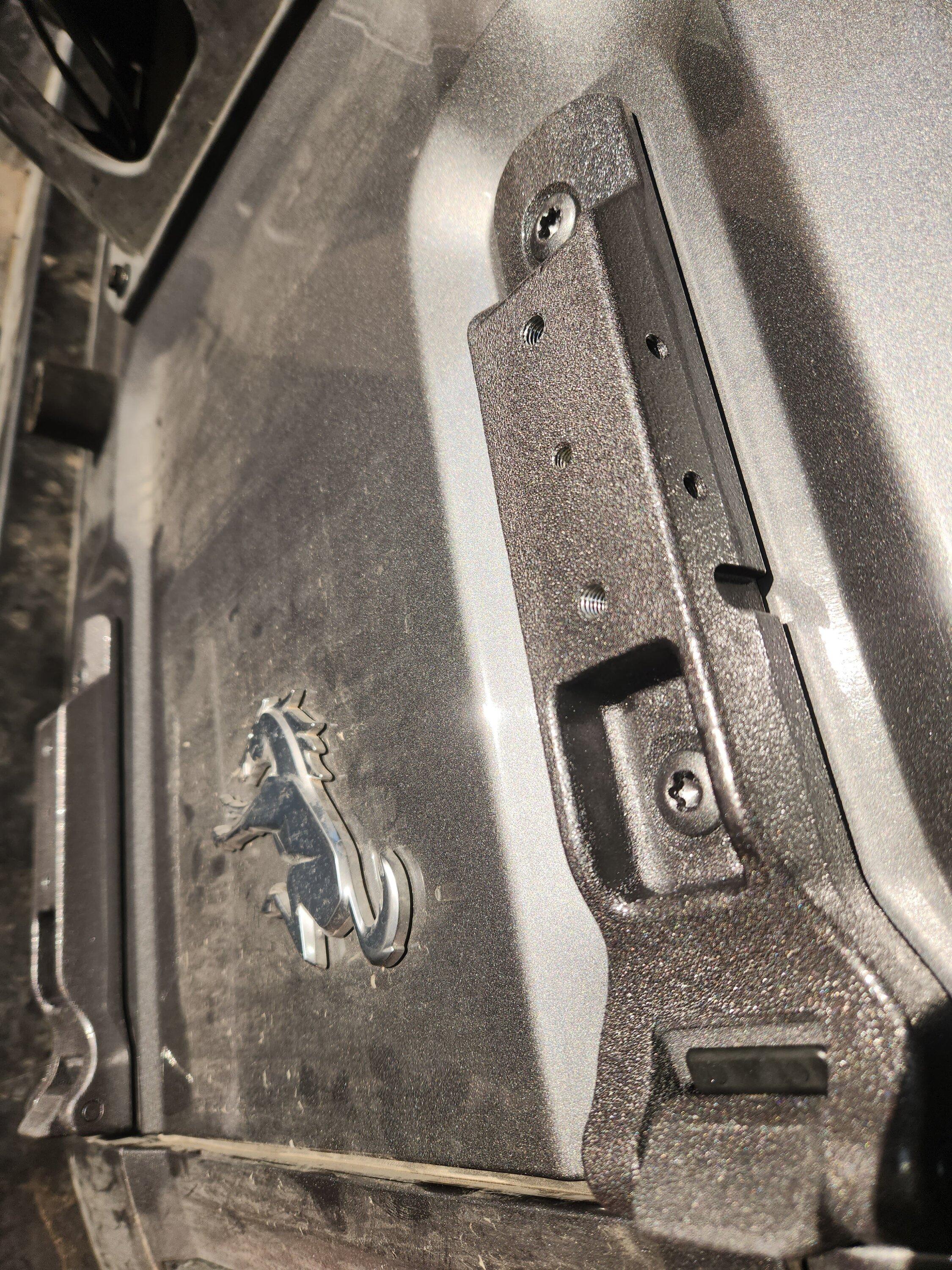

I gave up on the BAMF because of some initial fitment issues (interference with my factory spare and with my tire carrier) but BAMF has since addressed those issues with their newer builds. I also couldn't get past the super large (12x18 mm) slotted holes where the plate mounted directly to the my hinges (because of potential movement/the oversized washers dishing when the bolts were torqued)...and decided to go another direction and upgrade my hinges and have a plate from a different vendor created specifically for those Raptor hinges. I will be able to mount the upcoming Jerry can holder from the same vendor directly on the plate with no additional brackets. These hinges are far more robust than the OEM radiused ones and they provide a flat mounting surface with out relying on the bolts that mount the tailgate to mount the plate. The BAMF plate looks great but for my purposes I was trying to save weight and not have to rely on my tailgate nutplates to serve double duty, hence the hinge swap. The upgraded hinges require a different tailgate plate because they are 1/2 taller than OEM (and that changes the plate angle requirement).

I wonder how hard it would be to get the door hinge pin removed and fabricate a beefier hinge that has a flat surface area and have two dowl pins that can slide the tailgate reinforcement on before bolting? This would be a huge improvement over the BAMF design, if to complicated then I probably will go down the same path as you...

The Raptor hinges are so much easier...the drift pins would be a royal PITA to remove, if it is even possible, and by the time someone fabricated an equivalent he'd have a crap ton of money into it. Ford wants about 600 for both, there is a website I use that sells them for 194 each...IMHO having WAY stronger hinges (which would increase the tailgate capacity if a plate is used) beats just adding weight to the spindly OEM hinges. Check out the difference...if weight concern wasn't a thing the Raptor would not be using them. Ford must have figured out that more weight bouncing around warranted stronger hinges. My plate will weigh 14 (BAMF is like 24), my MFC carrier should be about 5 (BAMF is far heavier but very well built), and a MFC is 6 pounds (Jerry is about 14).

Where can I get this, please share info.... Like these hinges better
