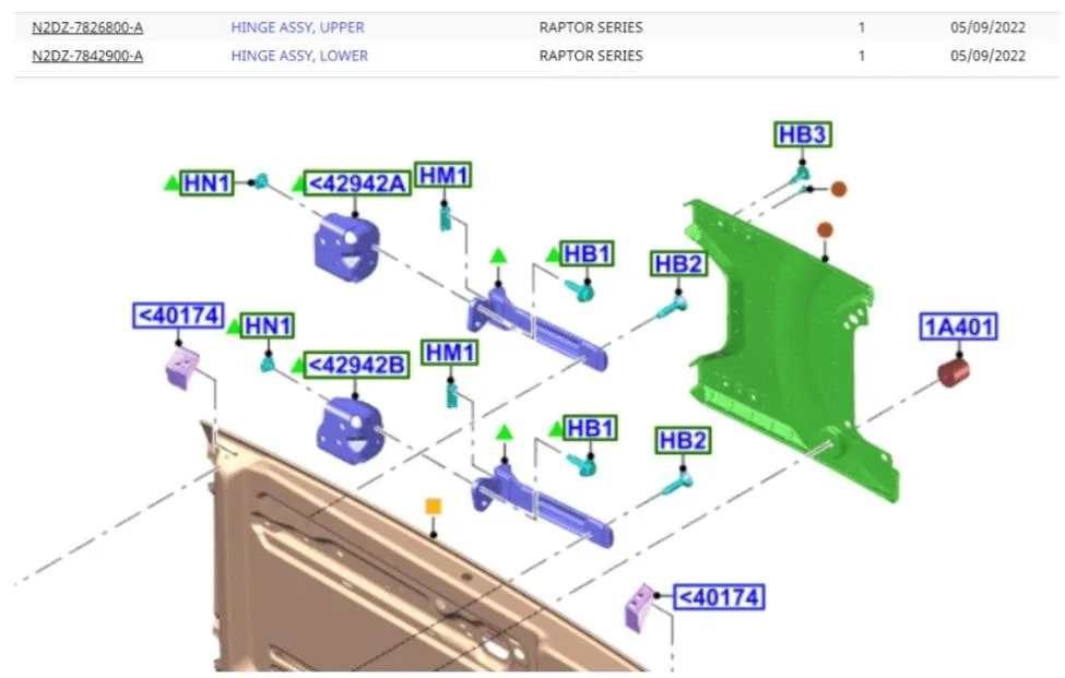

Hey folks! Disclaimer...I went down the rabbit hole of tailgate brackets because I wanted to mount a jerry can to extend my range. Whatever bracket one uses, the overall weight, no matter how well distributed it is, still ends up on the hinges. @flip kindly informed me that the Raptor hinges were in the catalog, and as soon as I found a place that sold them cheaper (by far) than MSRP I snagged a pair. Note that they are sold only as an assembly...but you need only the hinges themselves (they bolt to the included brackets with 3 m8s each). There is also a hinge stop as a separate part. The hinges come coated but not painted, and you can reuse your bolts. Note that the bolts that secure the hinges to the gate are T47s, but they are a tight fit due to paint in your bolts. Also note that the 6 bolts that attach the hinges to the pillar brackets are only M8s...and although the Ford manual indicates the torque should be 30, I know of no M8 that takes more than 22-24...so they may have made a mistake and lumped them in with the larger bolts that attach the main brackets to the pillar. I also made a sheet metal bracket that I used to make a template to bolt to the OEM hinges (with my tailgate shimmed to keep it from moving out of alignment) to (with nuts epoxied on the back of the plate in the exact locations needed to maintain hinge alignment...they HAVE to be parallel in order to function properly). That all said, here are the numbers:
Ford Bronco BAMF Tailgate reinforcement Screenshot_20220816-072047_Chrom
I will then use a tailgate bracket from a specific company that I can drill and countersink the bolt holes and then that will attach directly to the hinges (NOT to the bolts that attach the hinges to the tailgate). Probably overkill, but it satisfies my OCD about things being reliable and secure.
If you are wondering why not just use the Raptor tailgate bracket, it is because it costs 600 bucks and it requires a different spare tire carrier...AND it is not nearly as heavy duty as others.

Did you find them available yet?
flip
Base Sponsor (Level 1)
Phil
4,837
16,030
IN
www.ruxerparts.com
Fords
My hinges are in the paint booth right now. They did the PDI yesterday and pulling the stuff to start putting on. Hopefully I'll have some pics if the raptor under body shield fits along with some other stuff. Still debating on if I want to notch the tire carrier for the raptor brace but definitely going to put PPF between the brace and paint before reinstalling the mount. Should be epic :rolleyes:

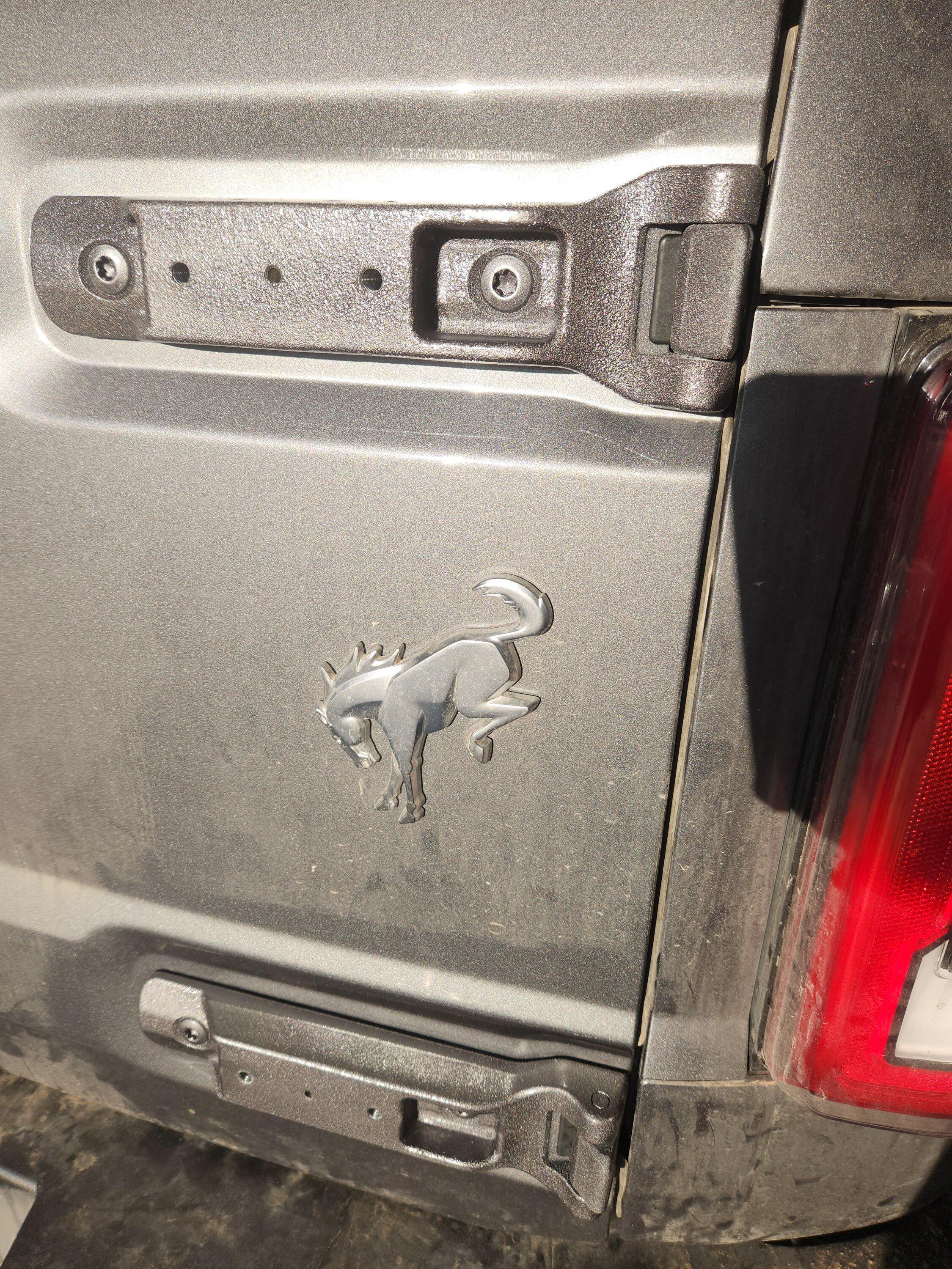

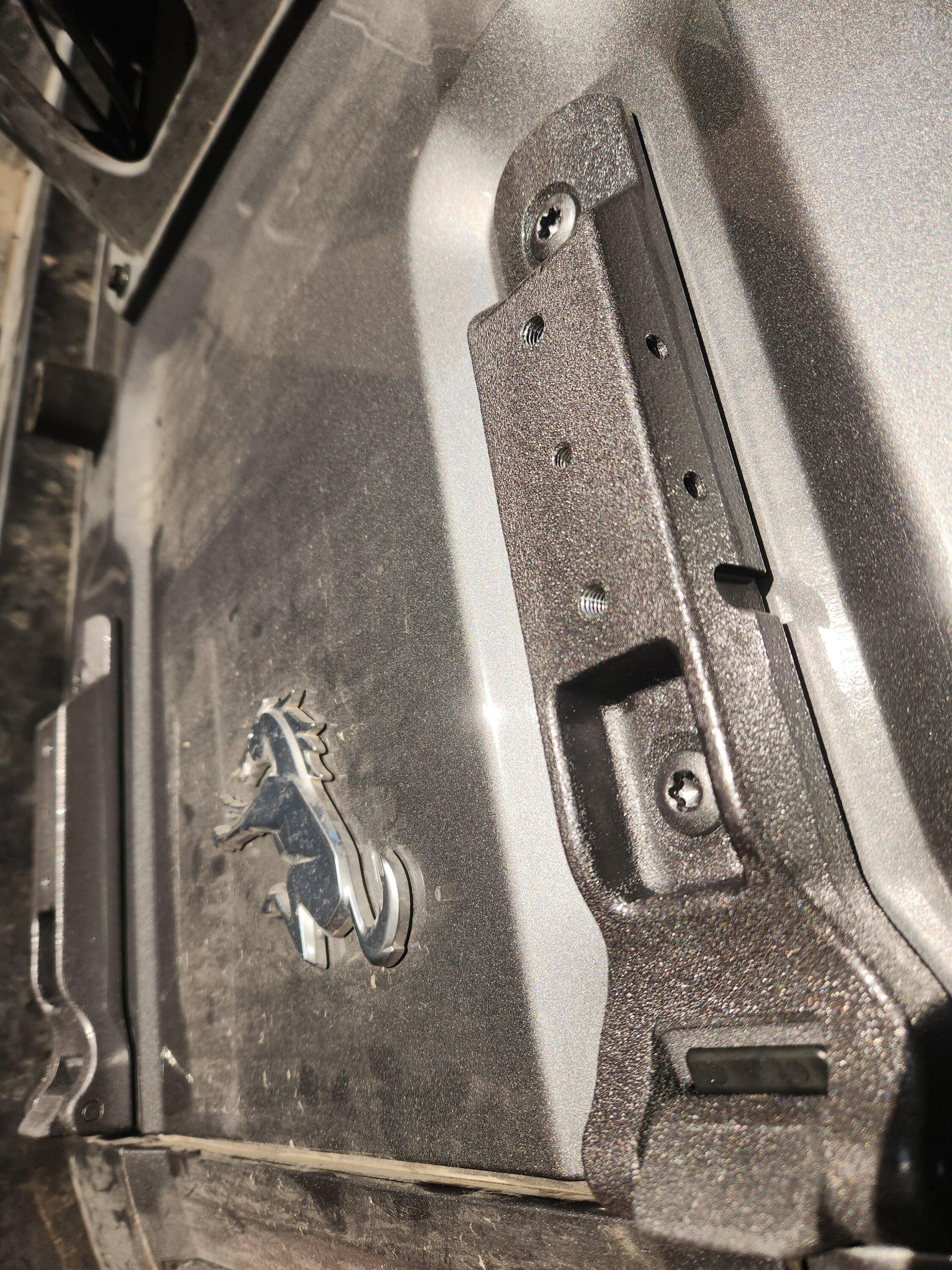

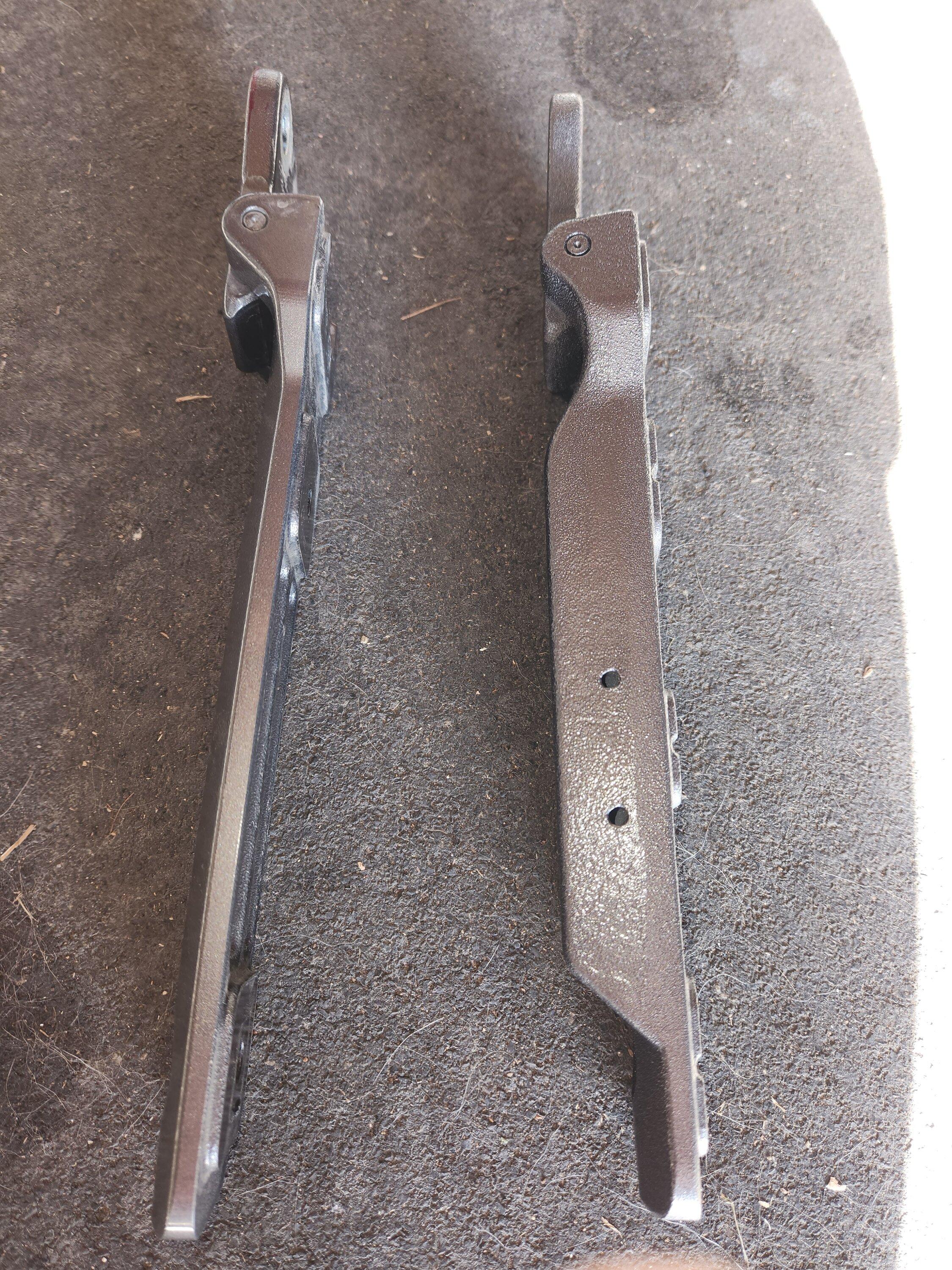

Here they are...Raptor hinges mounted and ready for service. Also a comparison of stock hinge and Raptor hinge. Probably overkill, but now when I mount a tailgate bracket it will not interfere with the bolts that mount the tailgate to the hinges...I will use the 4 m8 threaded holes and not have to stress about alignment/shifting tailgate. The bonuses is that the hinges (with the bracket) will not only distribute weight from the spare but also are way more robust than stock...so I can hang a MFC off the assembly.
