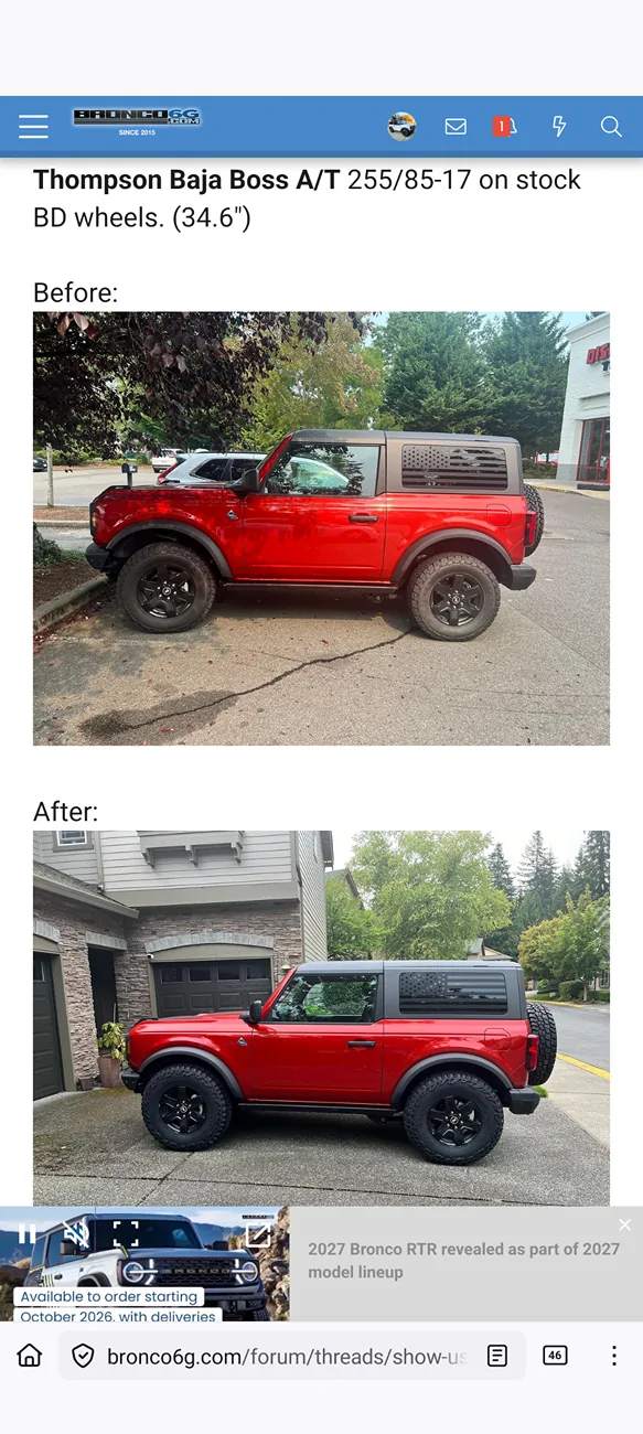

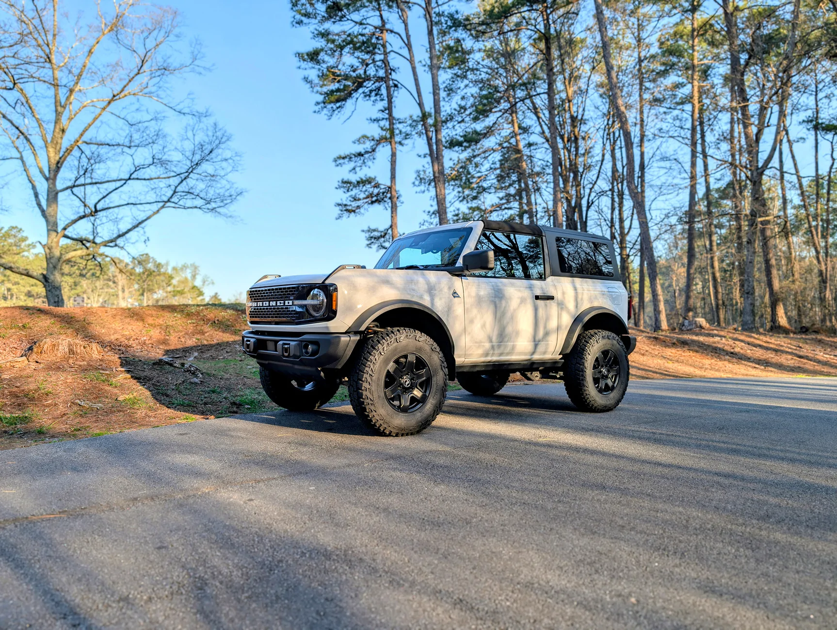

I am very happy with how the Bronco handles on these "pizza cutters," but note that I had them put on shortly after installing a set of Eibach Protruck coilovers with new UCAs and a new adjustable tracbar.
Below is a picture of a stock ride height BD 2 door before and after the MTs. It was one of the posts that convinced me to get the MTs.
A picture of my setup is also below - note that mine is a non-SAS and I'm now lifted about 2.5" over stock and about 1.5" over a stock SAS. I also have spacers to push the wheels out a bit.
