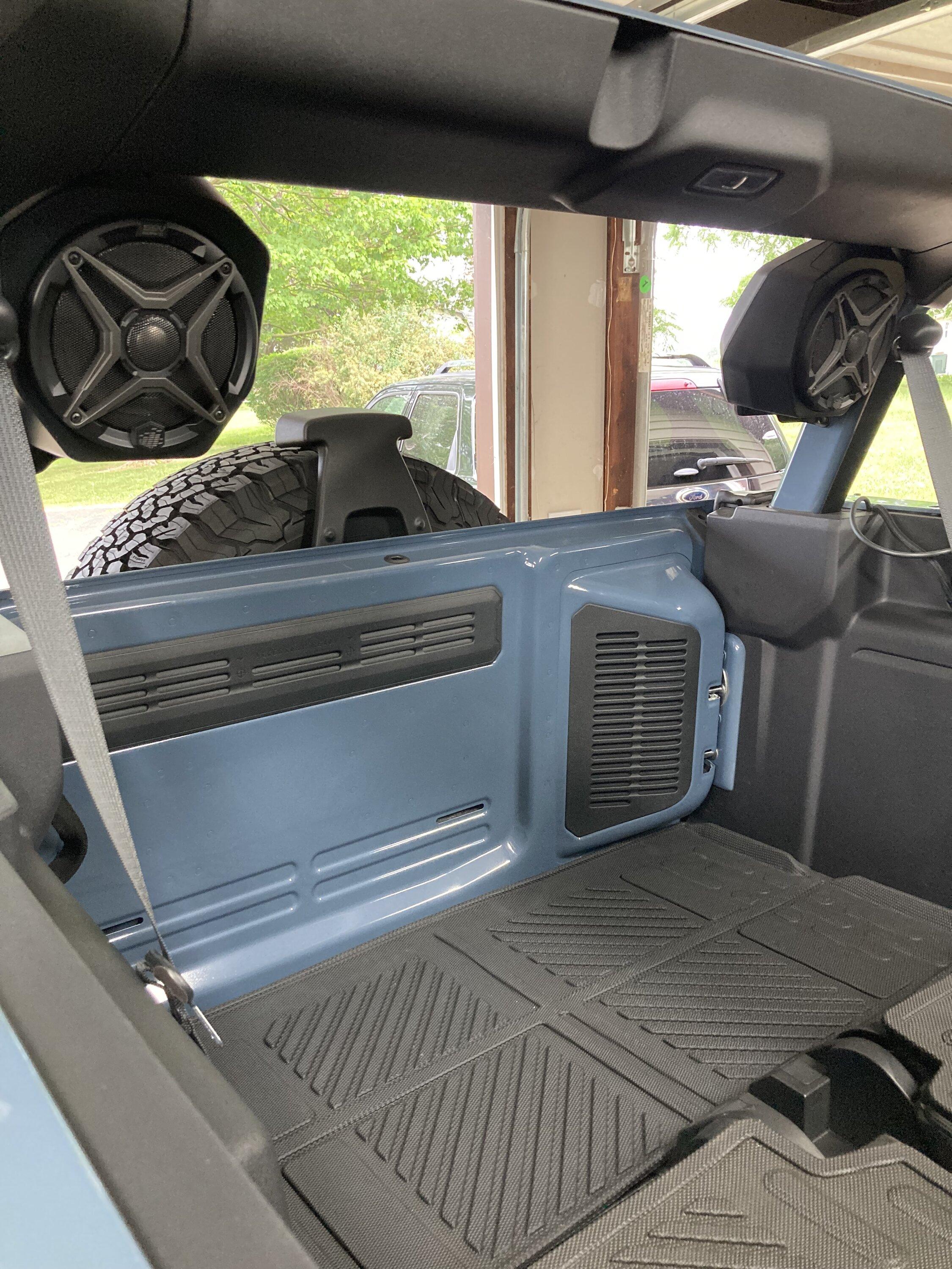

I went with the SSV pods and speakers. All the rest of my speakers were switched with Kickers. I did the Fusion amp and kicker base swap for the fake sub in my 6 speaker set up from Ford. I did the necessary Forscan changes to power the new 6.5 rears and sub. I am happy with the sound but do not know if I could have done better 6.5 pods. Definitely better than the stock, r

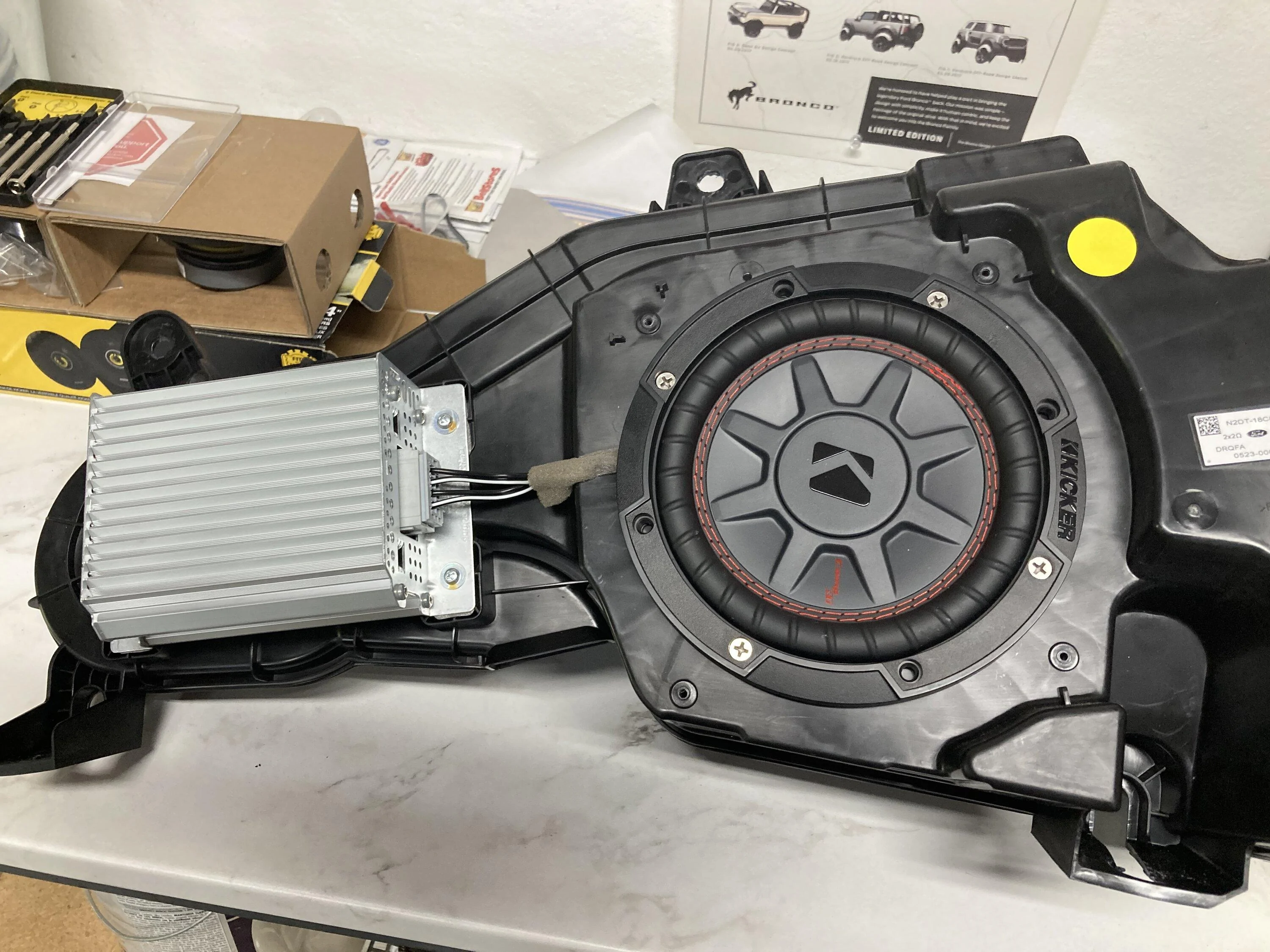

The Ford Fusion amp and Kicker sub.
Ford Bronco Best 6.5 roll bar speakers? tempImagetekXC0
Yeah I've been debating what type of sub I wanna get, there's so many options lol. I don't have the fake sub box so I need to buy one, so I got options I guess. I was also thinking about getting the tailgate mounted one, that seems interesting. Is that pretty much the same thing as the ford sub woofer you think?

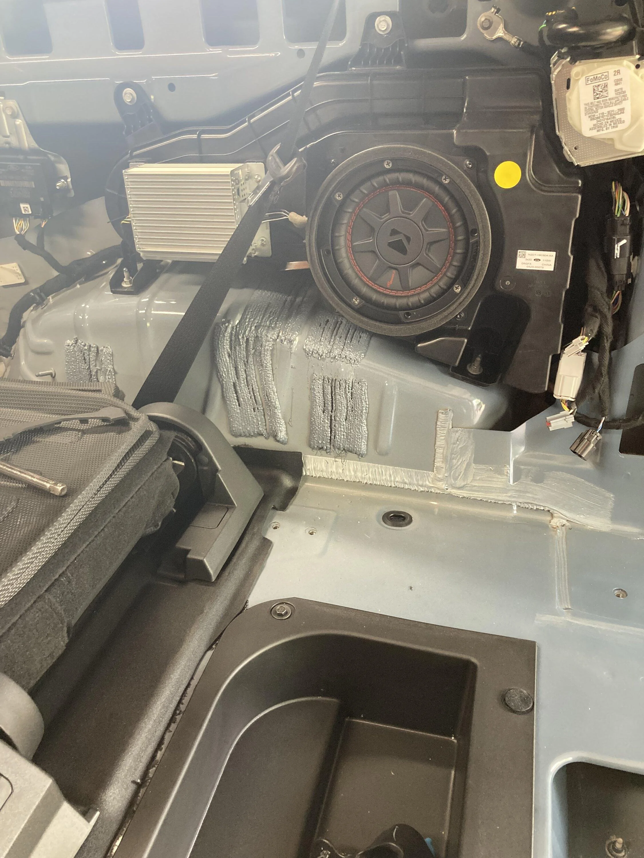

The sub mounts within the rear side panel. I did a minimal sound upgrade. This sounds great if I keep the bass level moderate. If I turn up bass and bass heavy song hits I can get some vibration. If you pull out this panel and the dummy sub may be there. You add the amp and speaker after removing the non usable amp and speaker. That sub enclosure and dummy amp/speakers were in mine.
Ford Bronco Best 6.5 roll bar speakers? tempImage7yESvI

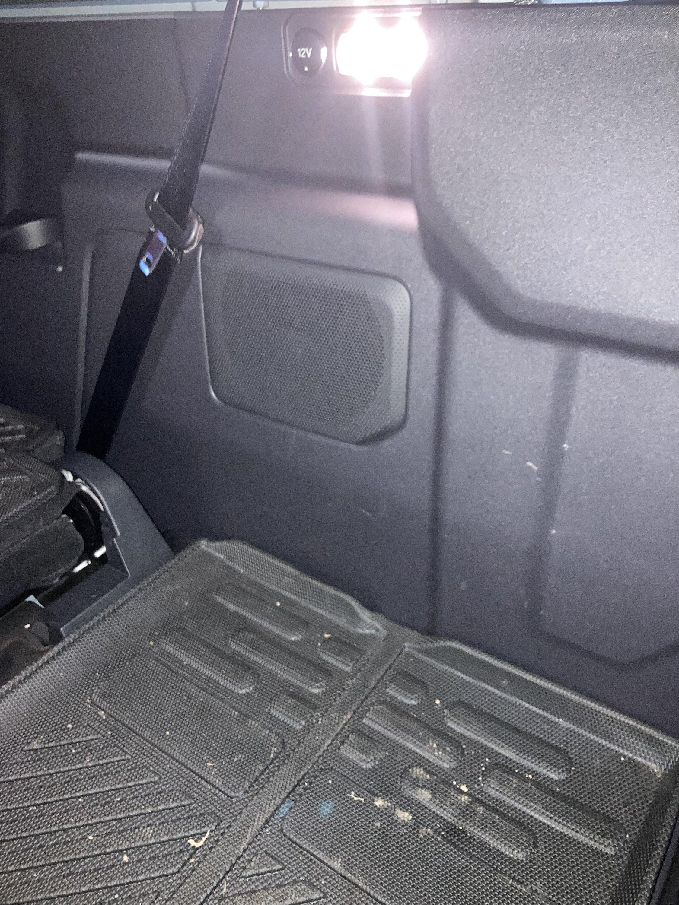

Does your side panel where the dummy sub is located have the little pouch to store stuff or the speaker grill? Just curious. I'll definitely check either way though.
