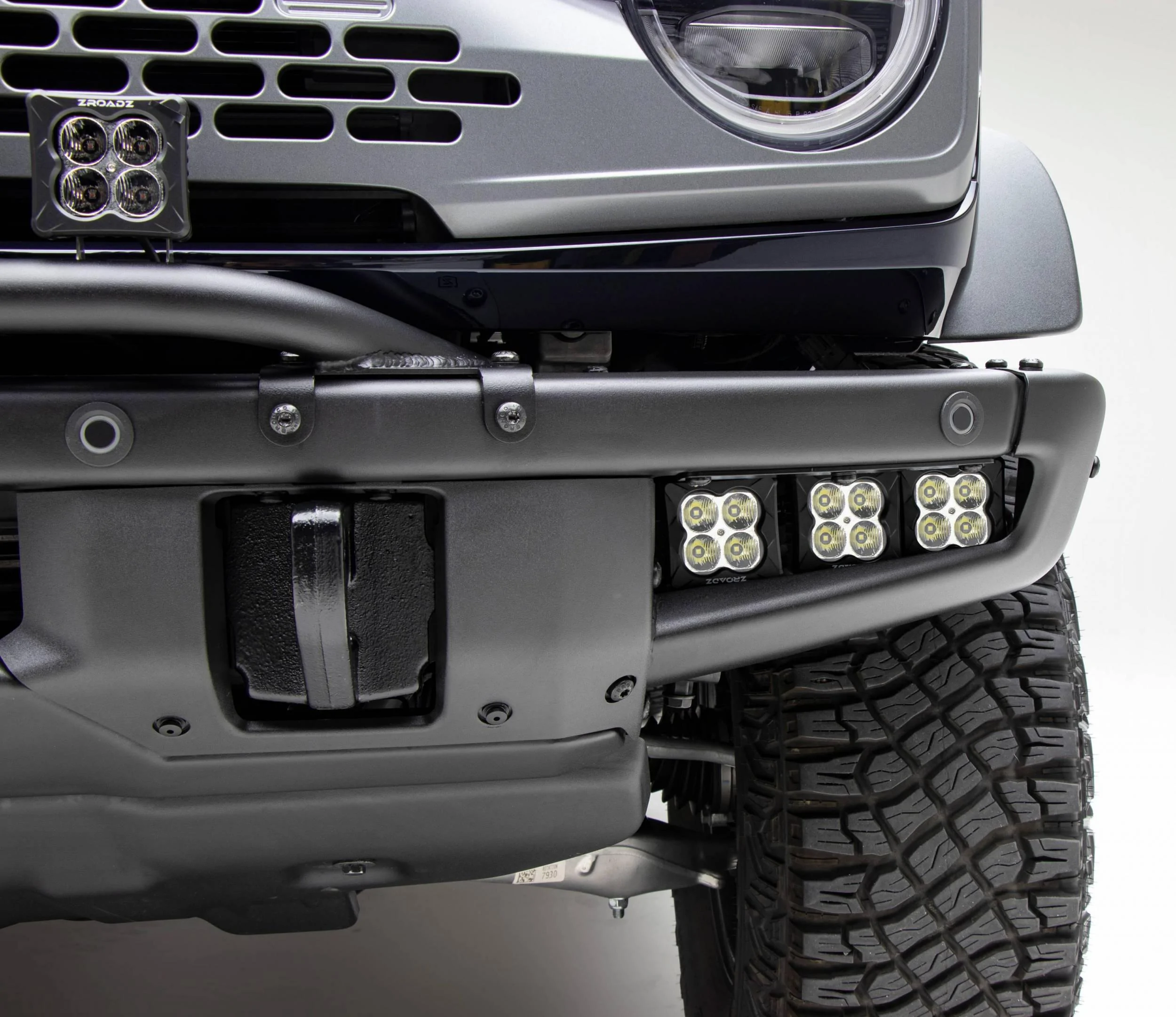

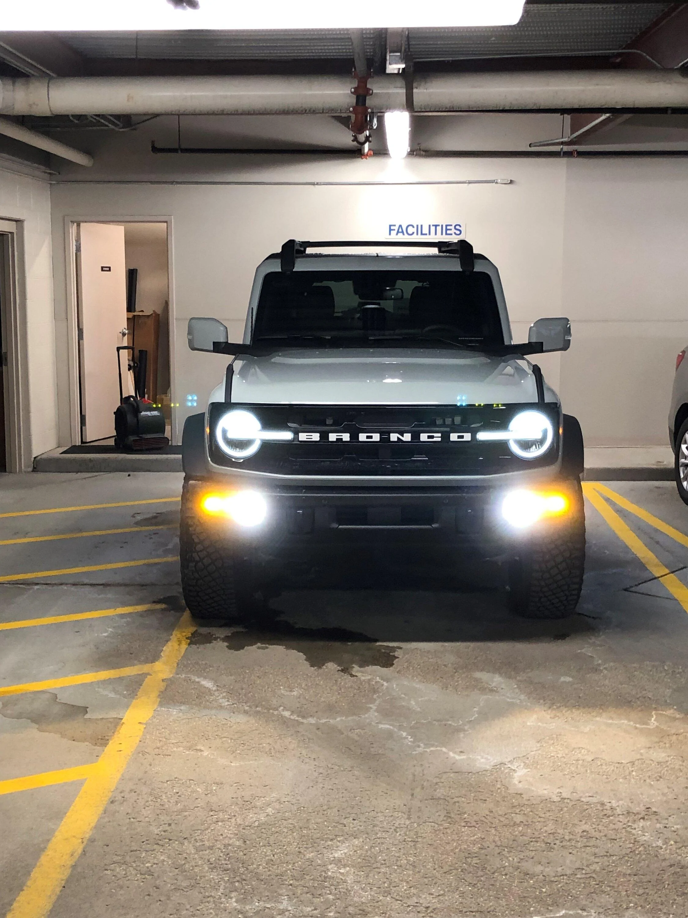

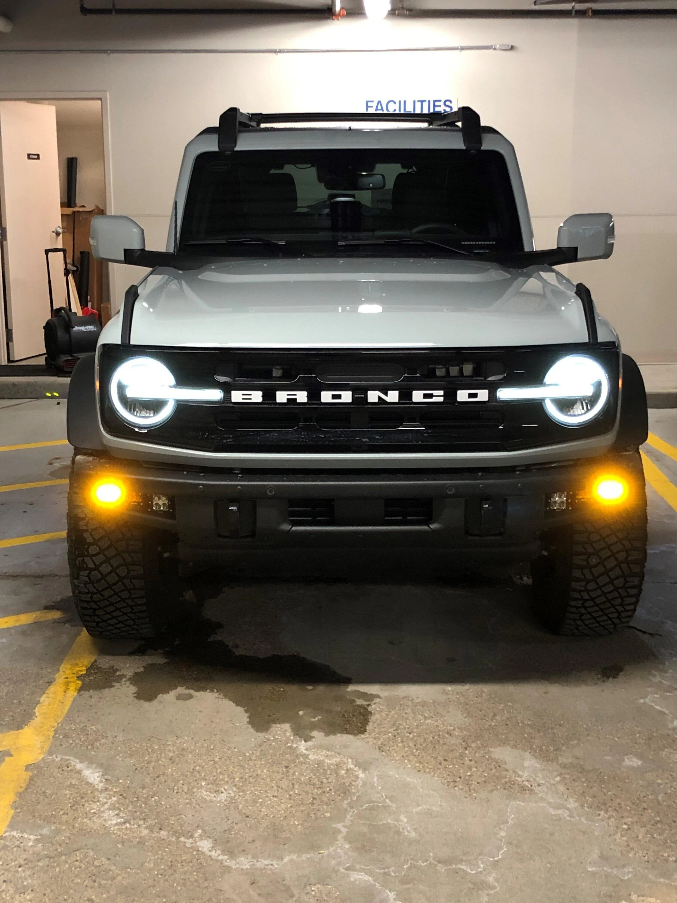

I got the lights that fit in the MOD bumper from Heretic and love them. I have 4 small amber and 2 clear lights in the bumper. I hooked them up the 3 of the AUX switches so I have many options. I can run 2 amber. or 4 amber or 1 amber and 1 clear you see where I am going. The amber makes street signs light up and doesn't blind the driver coming at you. I have 2 more amber lights coming from Heretic that will be my ditch lights. Can't have enough light! By the way Heretic lights are life time warranty.
Ford Bronco Best total light setups you guys have seen? lighting 1
Ford Bronco Best total light setups you guys have seen? lighting 2
Ford Bronco Best total light setups you guys have seen? lighting 3

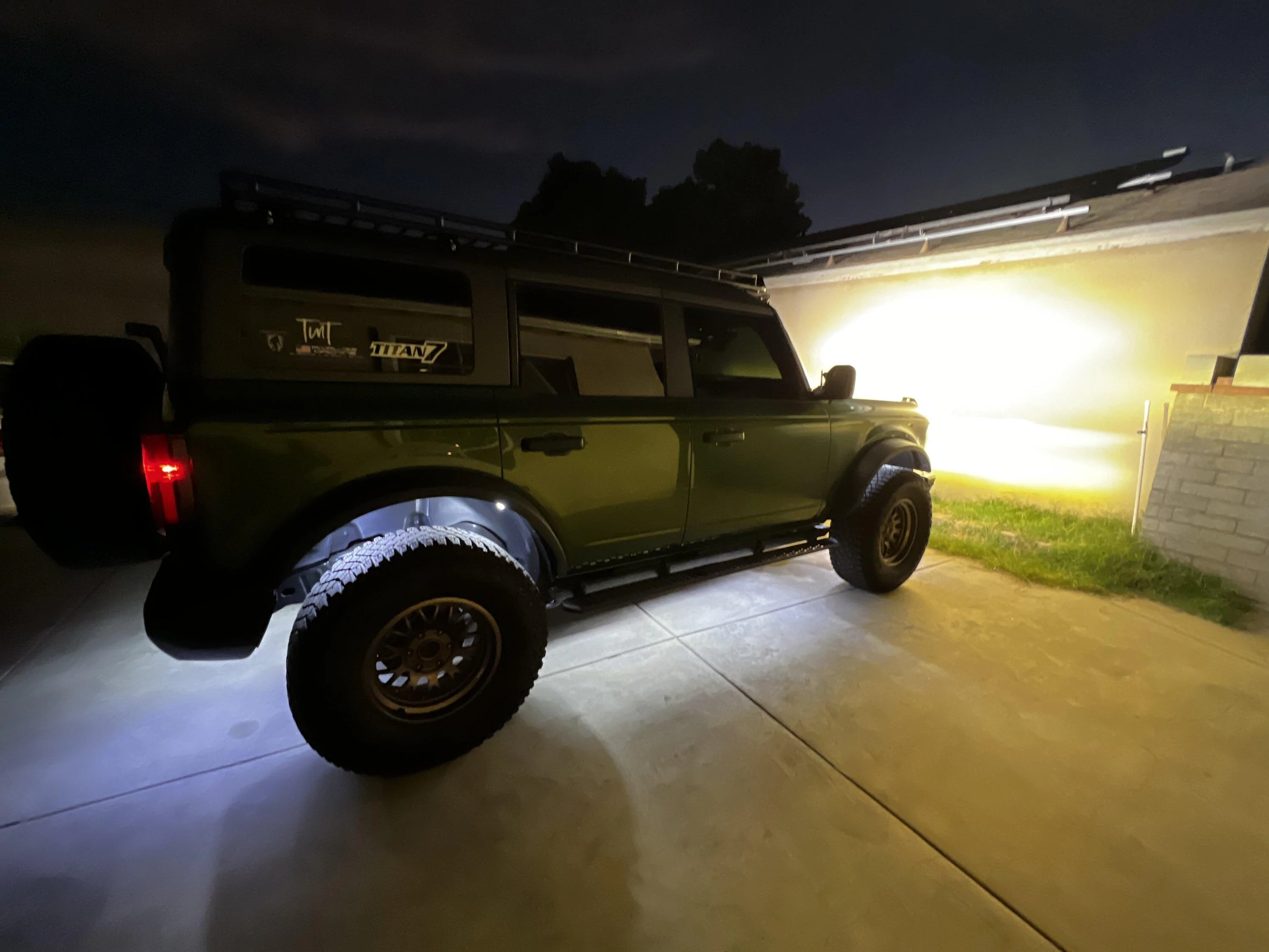

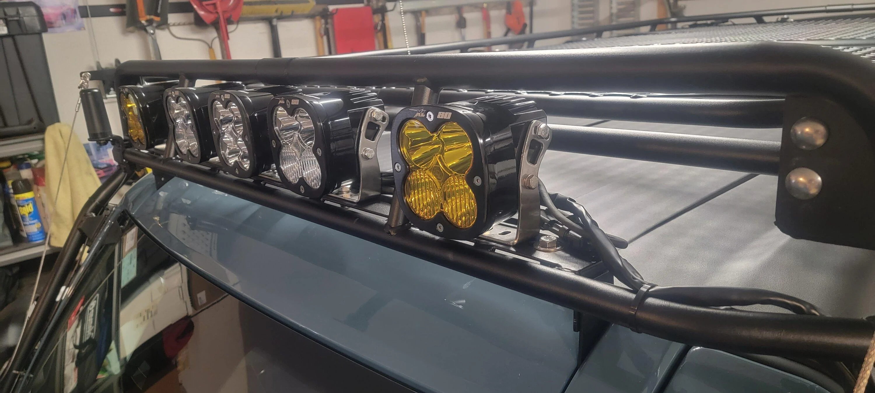

I'm using all 6 of my upfitter switches for my lights. All lights were purchased from forum vendor @4x4TruckLEDs.com
LIGHTING
Roof Rack Baja Designs
  • 2x-XL80 Amber Driving Combo (80w/6A-Aux2{15A})
  • 2x-XL80 Driving Combo (80w/6A-Aux1{25A})
  • XL80 Spot (80w/6A-Aux1{25A})
https://www.4x4truckleds.com/baja-designs-xl80-pair-driving-combo-amber/
A-Pillar Baja Designs
  • 2x Amber Squadron Pro Driving Combo (40w/3A-Aux3{10A})
https://www.4x4truckleds.com/baja-designs-a-pillar-kit-for-2021-ford-bronco/
Fog Light Baja Designs Sportsman
  • 2x-S2 Sport Wide Cornering(12w/1A-Aux4{5A})
  • 2x-S2 Sport Driving Combo(12w/1A-Aux4{5A})
  • 2x-Squadron Sport Amber Wide Cornering (26w/2A-Aux5{5A})
https://www.4x4truckleds.com/baja-designs-fog-pocket-kit-for-2021-ford-bronco-modular-bumper/
Reverse Light Baja Designs
  • 2x Squadron Sport Wide Cornering (26w/2A-Aux6{5A})
https://www.4x4truckleds.com/baja-designs-reverse-kit-for-2021-ford-bronco/
Ford Bronco Best total light setups you guys have seen? 20230125_091611

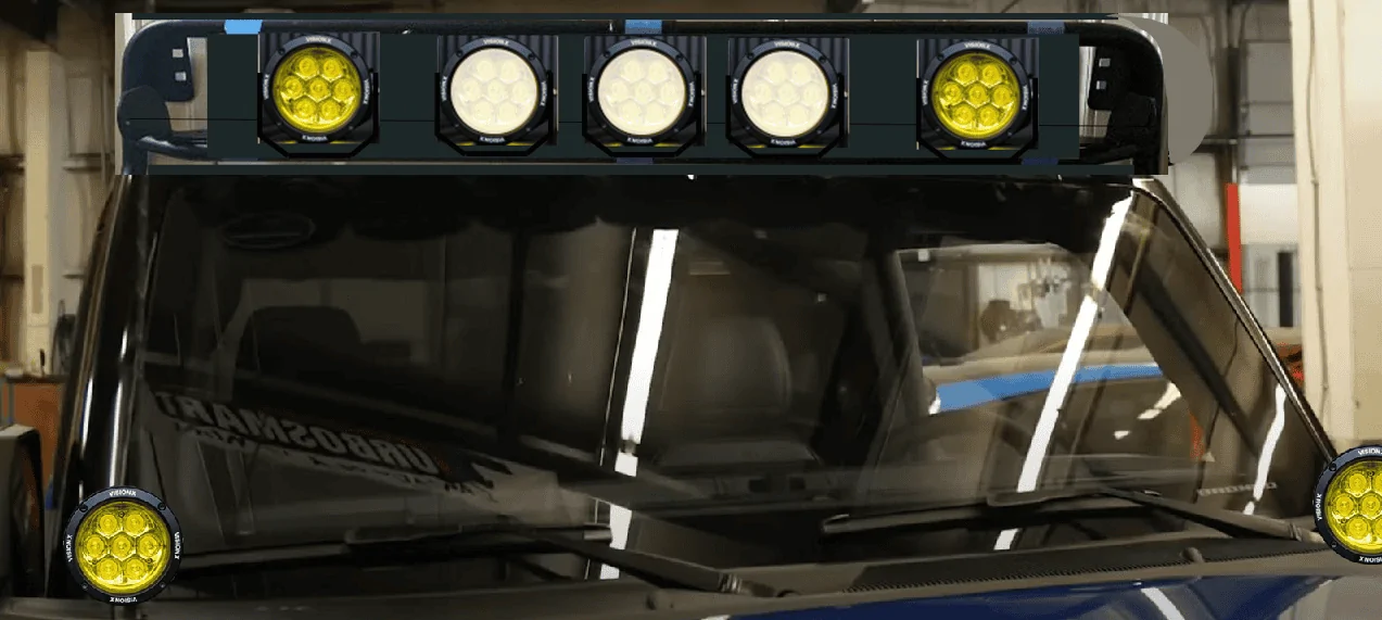

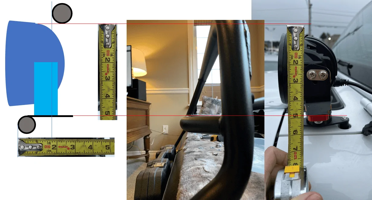

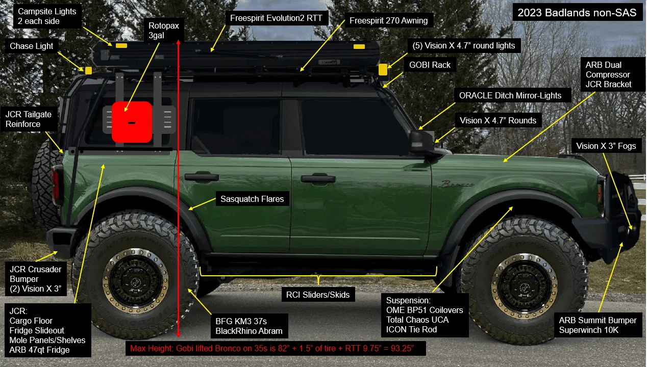

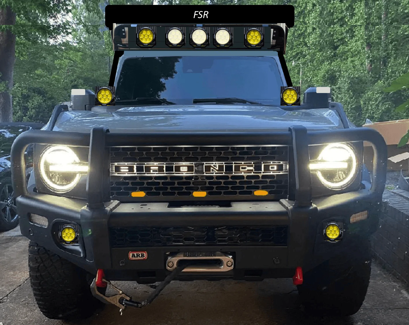

Can I please see more shots of how you fit the lights inside the Gobi head pieace? My plan is to use Vision X 4.7" pods like shown in my photoshopped pic.
Ford Bronco Best total light setups you guys have seen? 1678641869350

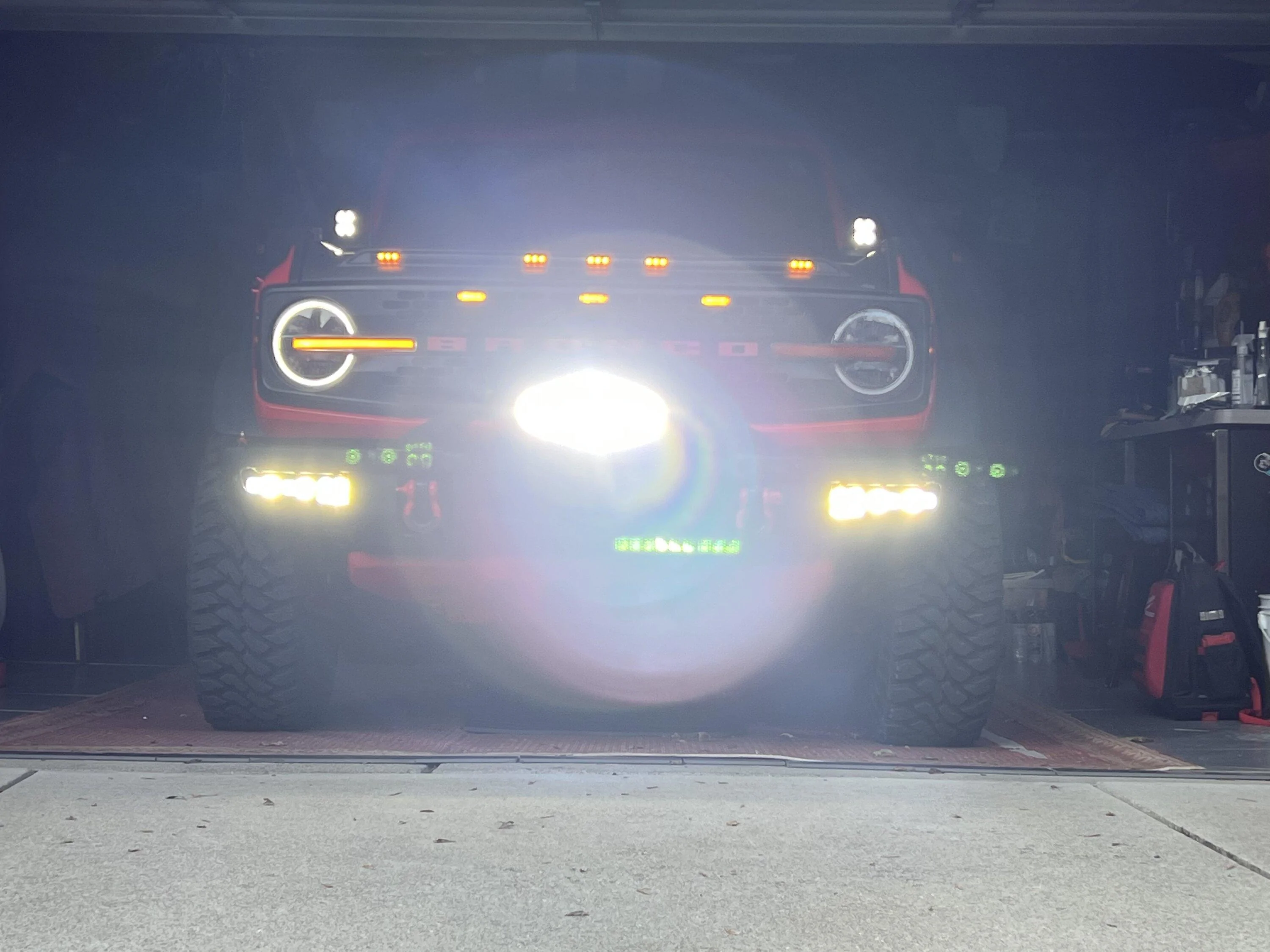

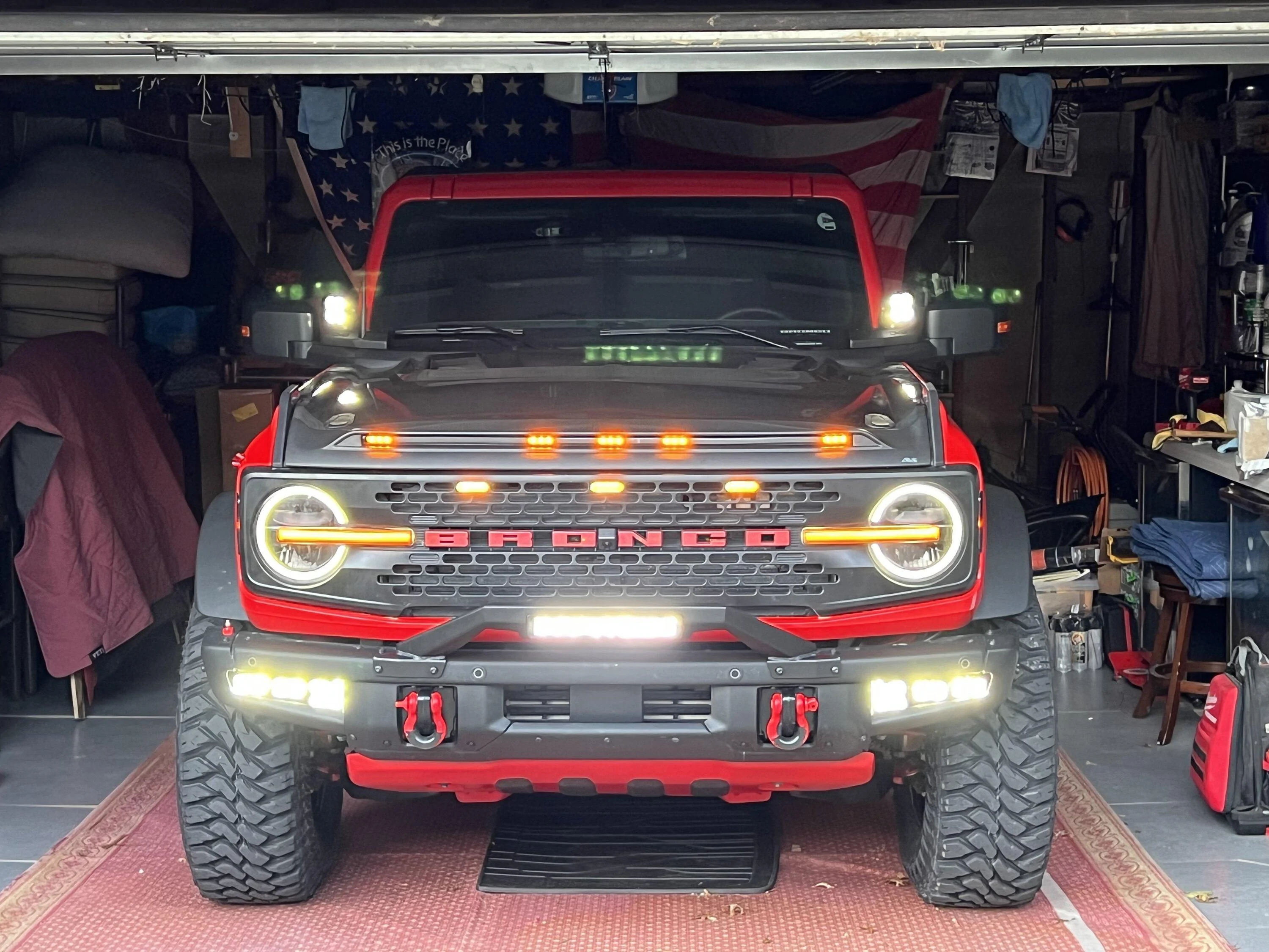

Absolute best setup is @Ground_zero298 as he turns his Bronco into a Japanese Dekotora rig, it's insane!
You have about 275 lights to go until you hit God level.
Ford Bronco Best total light setups you guys have seen? 780D529F-B8BB-440A-A23B-045BDB32D4BD
Waiting for my flexible oled panels to arrive. Shit will be next level
Whole fronts being redone over the next 2 weeks for supercel.

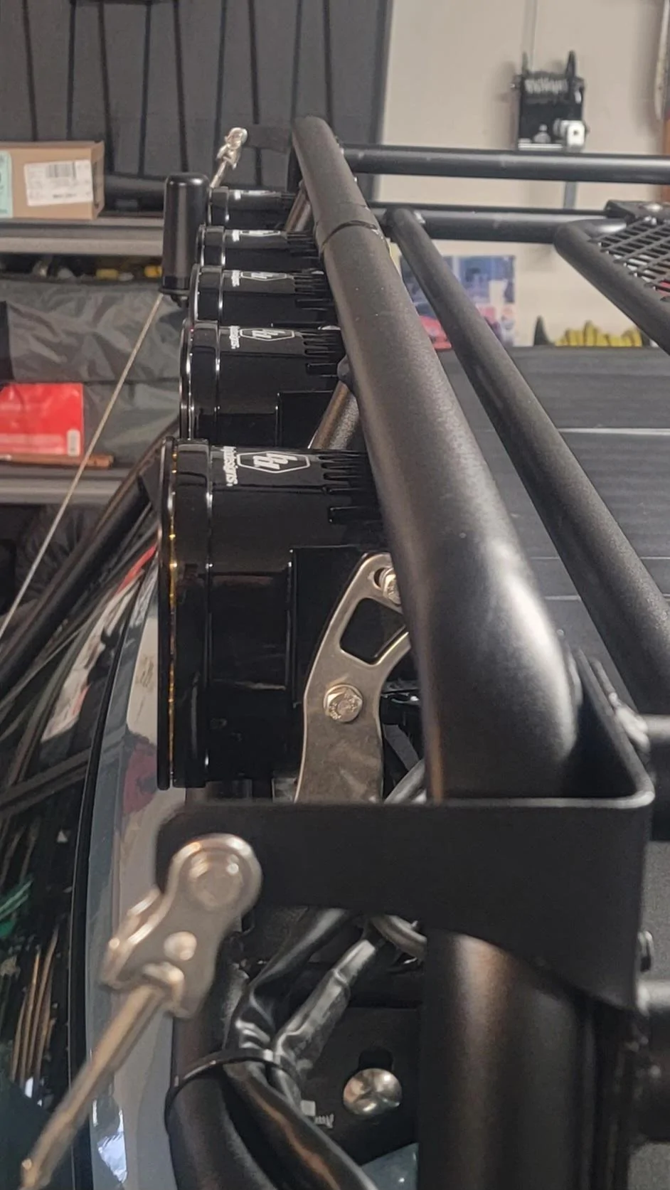

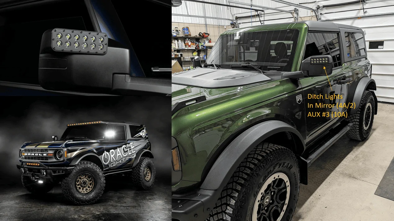

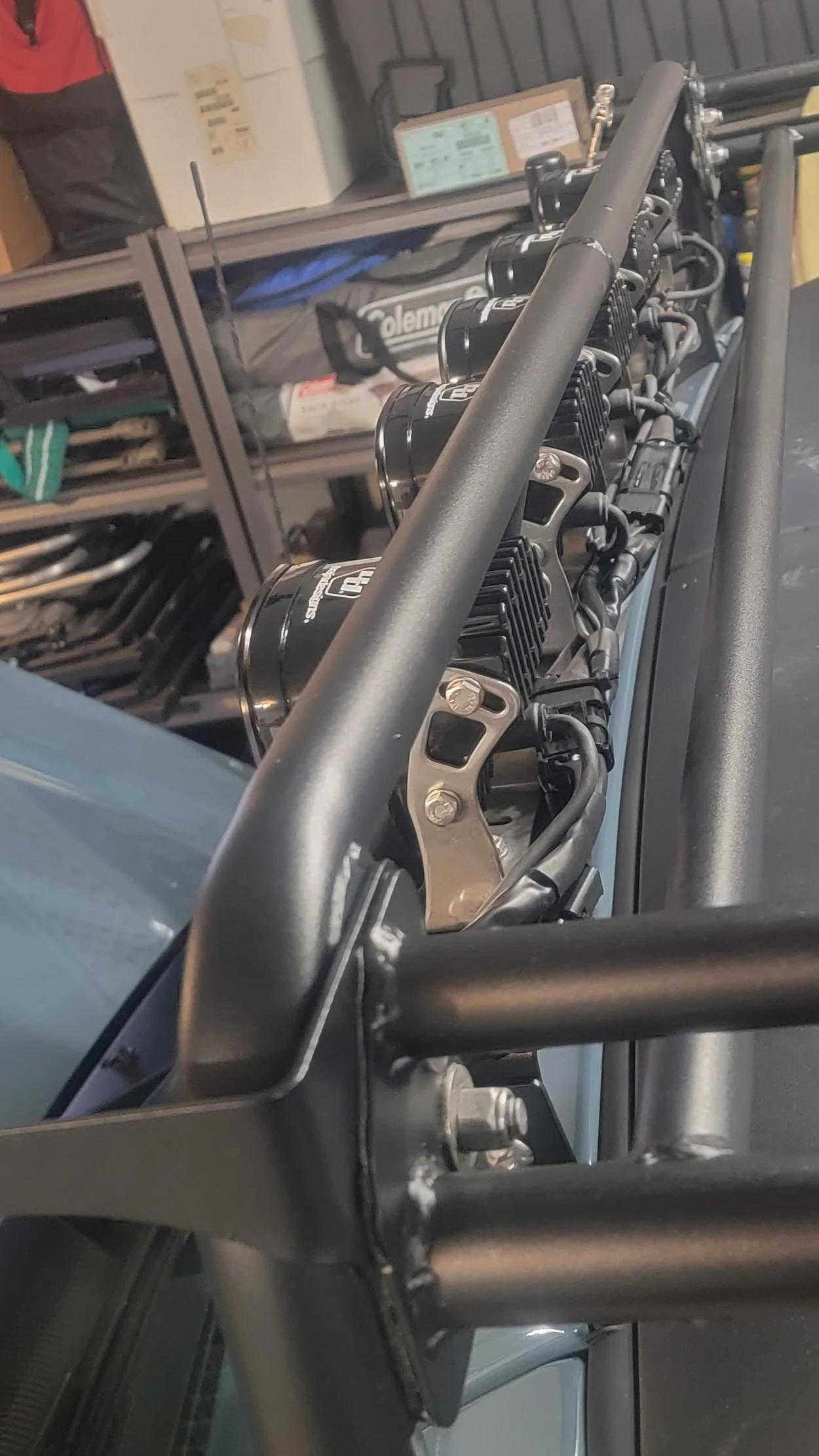

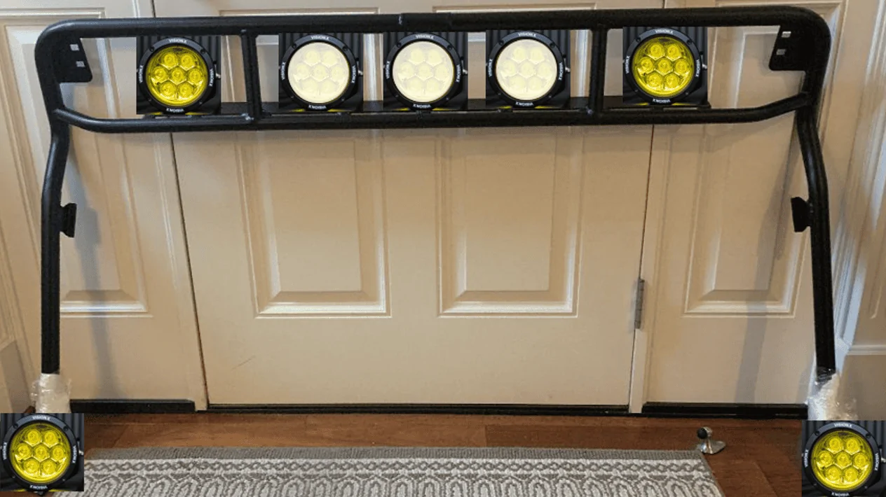

Thank you very much. My lights are 5.28" tall from mounting surface to top of light but they also curve in the back so that'll help. I'm glad I found your pics cuz it's very much my theme, just different light choices. I went thru a long comparison process of pods, bars, etc and landed on my final choice. I like the clears in the center and yellows on the ends to match the A pillar pods. I also have the ORACLE ditch light mirrors. Were you able to use the predrilled holes in the Gobi? I also plan to install campsite lights in my RTT
Ford Bronco Best total light setups you guys have seen? 1678654928216
Ford Bronco Best total light setups you guys have seen? 1678654538318
Ford Bronco Best total light setups you guys have seen? 1678654569966
Ford Bronco Best total light setups you guys have seen? 1678654615192
Ford Bronco Best total light setups you guys have seen? 1678654752570

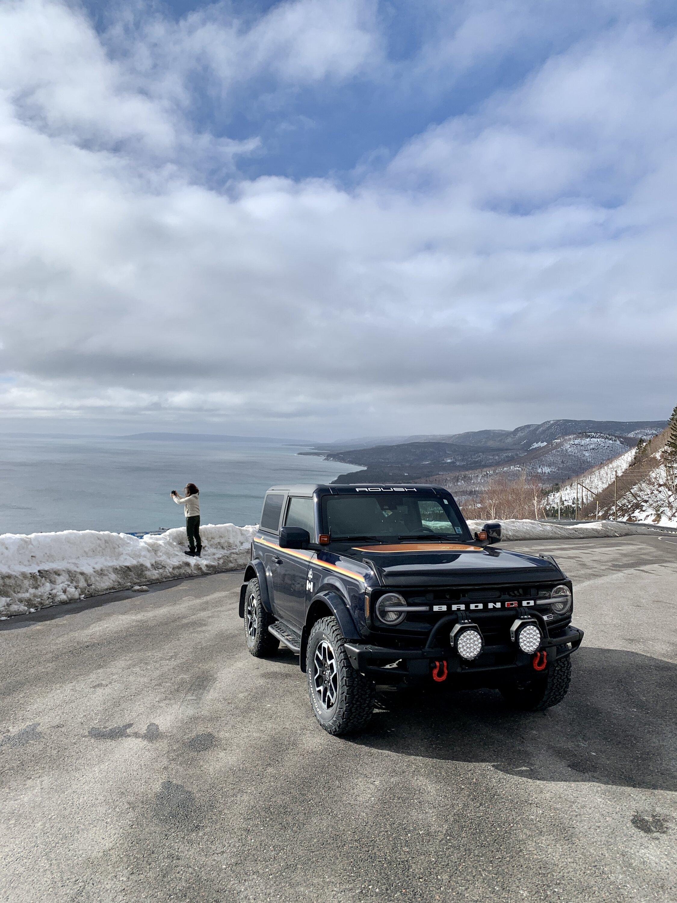

Ford Bronco Best total light setups you guys have seen? IMG_6297

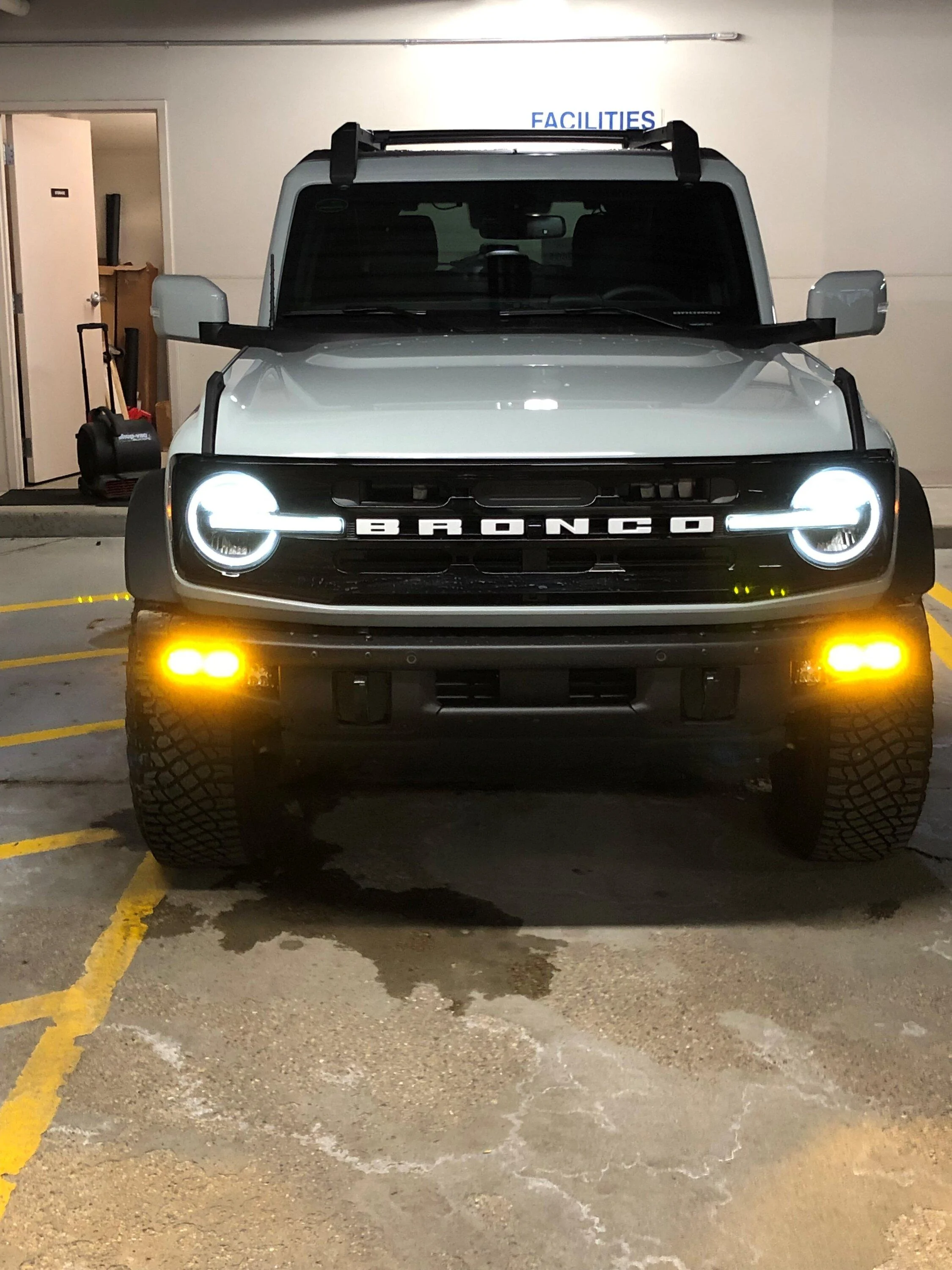

Terlalume ICON driving lights and teralume charge ditch lights (both off in pic) are better value than anything I have seen in North America (Australia). Pic from road trip yesterday. Shipping was quick too. JCG

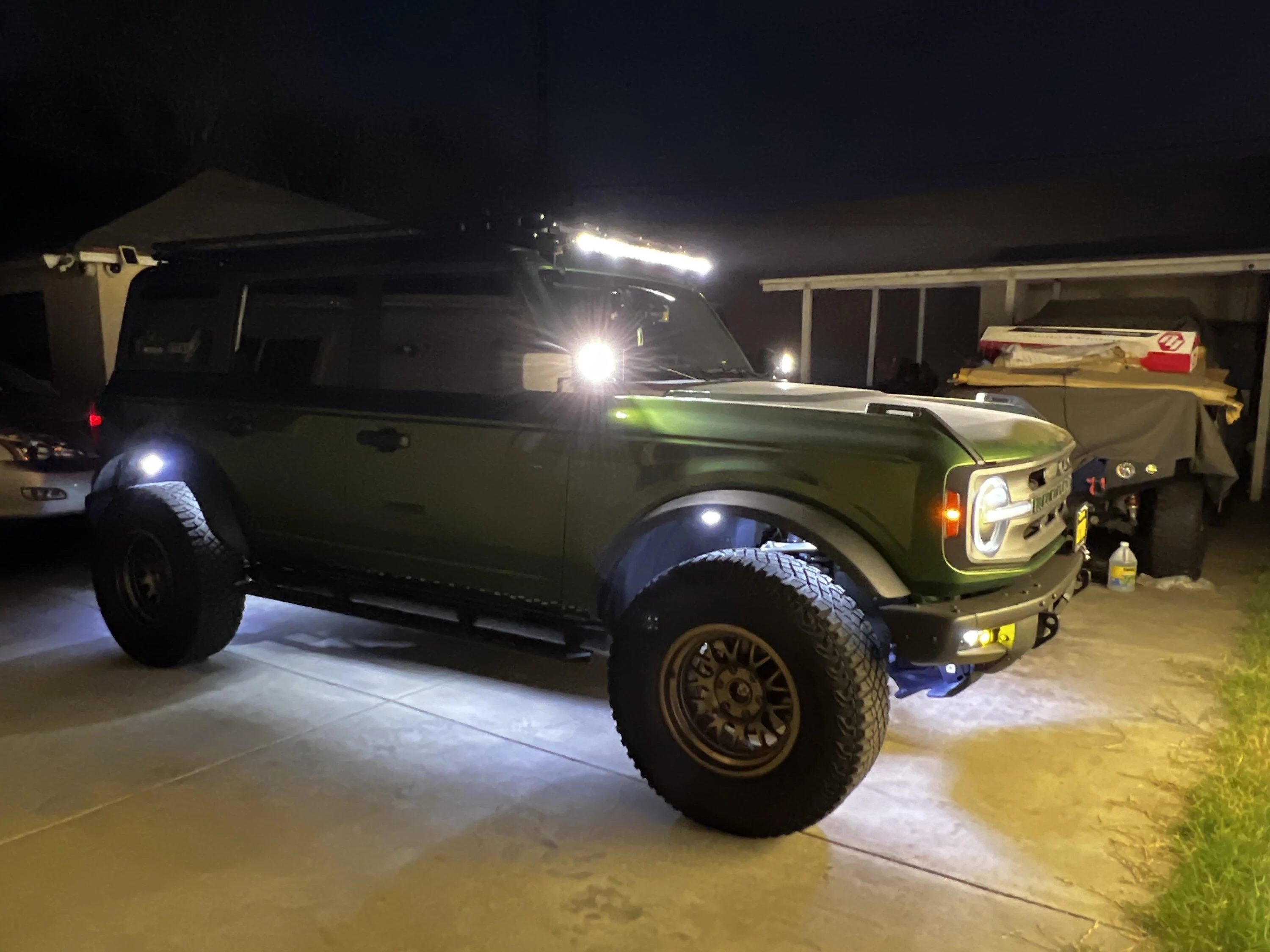

Baja designs all around and switchpro to control it all.

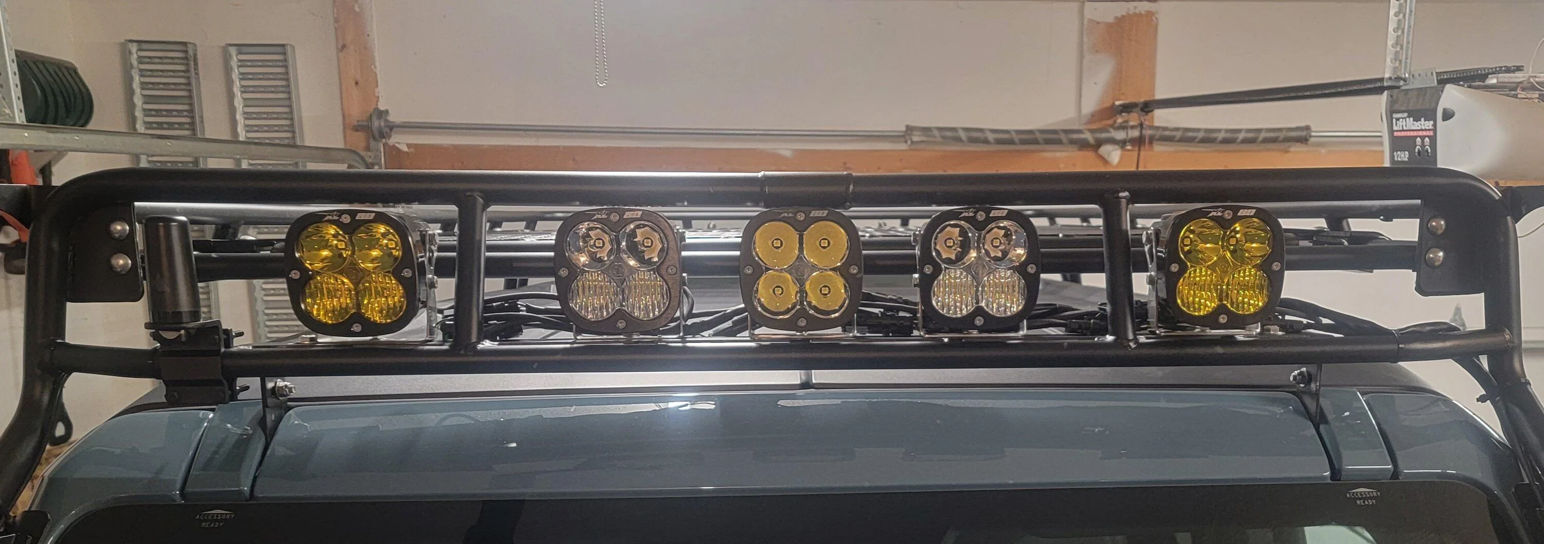

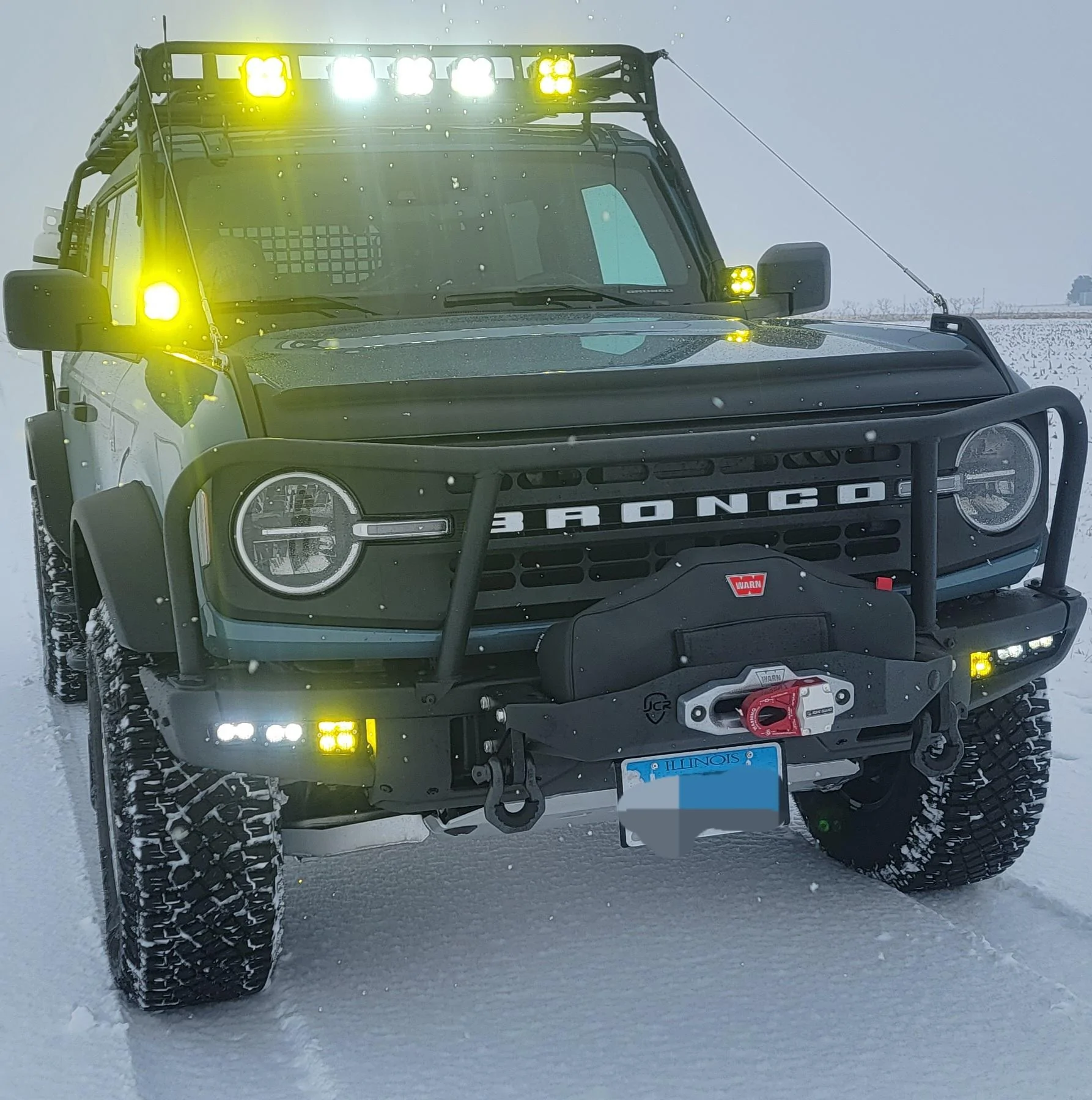

LIGHTING
Ford Bronco Best total light setups you guys have seen? B00A9BBE-7CD6-4835-A2CA-25195A16D92C
What bumper is this? Works really well with the Gobi Rack.
