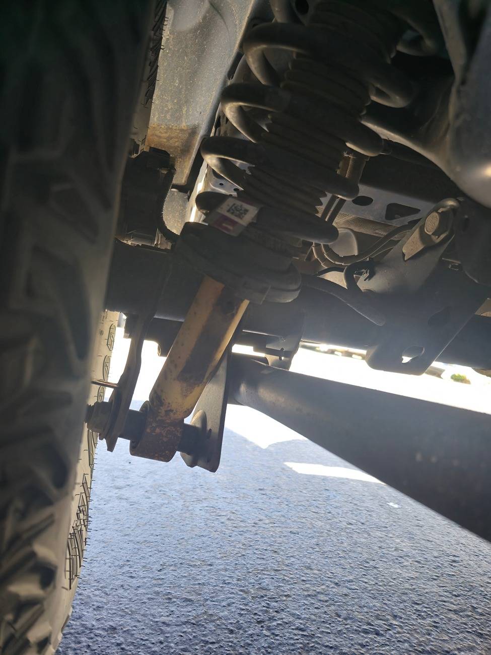

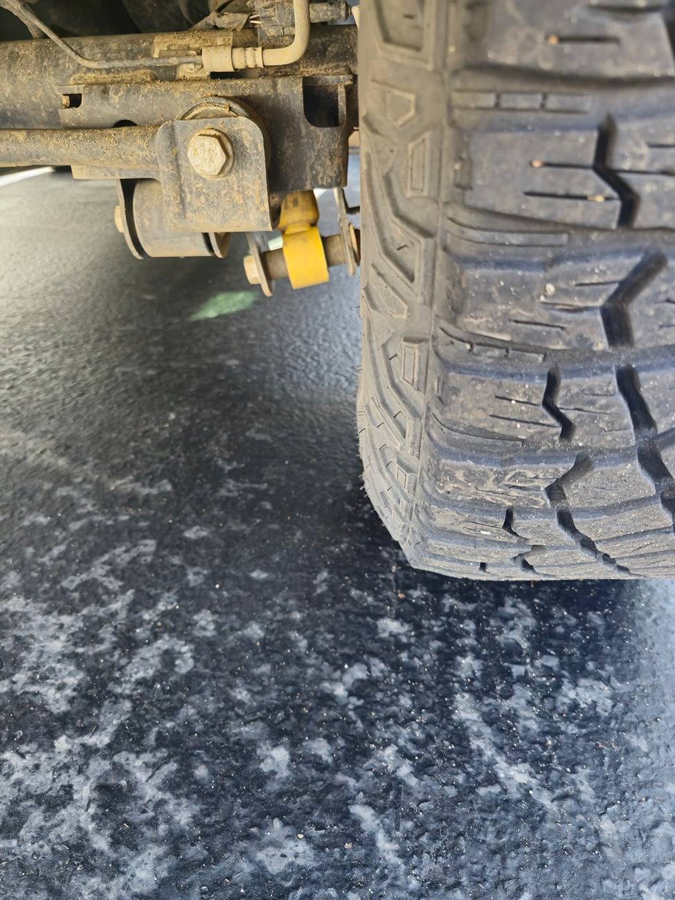

Stopped by dealer. Extended warranty should cover replacing with same shocks. Then when new shocks from recall come in, they will replace again.
Bringing car in on Monday. Service manager will contact Ford about replacing with Hoss 3.0. That would save Ford having to do recall later. See what happens. I don't see any reservoirs on my shocks

Yeah your reservoirs (or at least the one) fell off.
There’s no way Ford will authorize Hoss 3.0 as a replacement, but good luck 👍🏻
