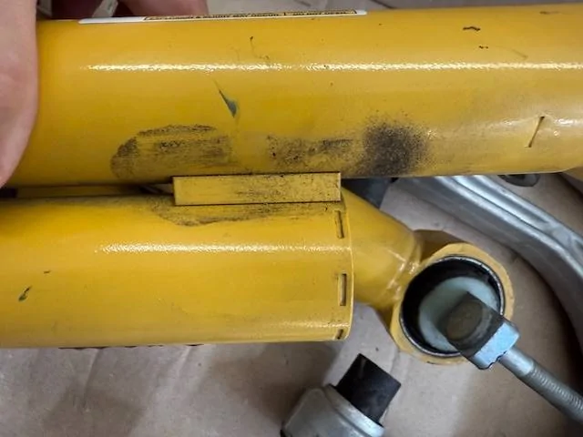

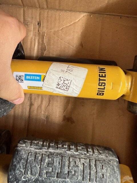

I can't say for sure, but if you look at that photo, the flange I suppose is the part that joins the reservoir to the shock body. It looks like it's about half the width of the other ones. The top of the reservoir also looks different I think, but not sure about that. I think somebody else mentioned they're welded differently (or at all).
If you could take and post some better pictures of yours, we might be able to work it out, but it may not be obvious either.
It’s all about “long flange” (bad) vs “short flange” (good).
You can see that the attachment point is much larger on the failed shocks.
No idea if the new shocks are “better”.

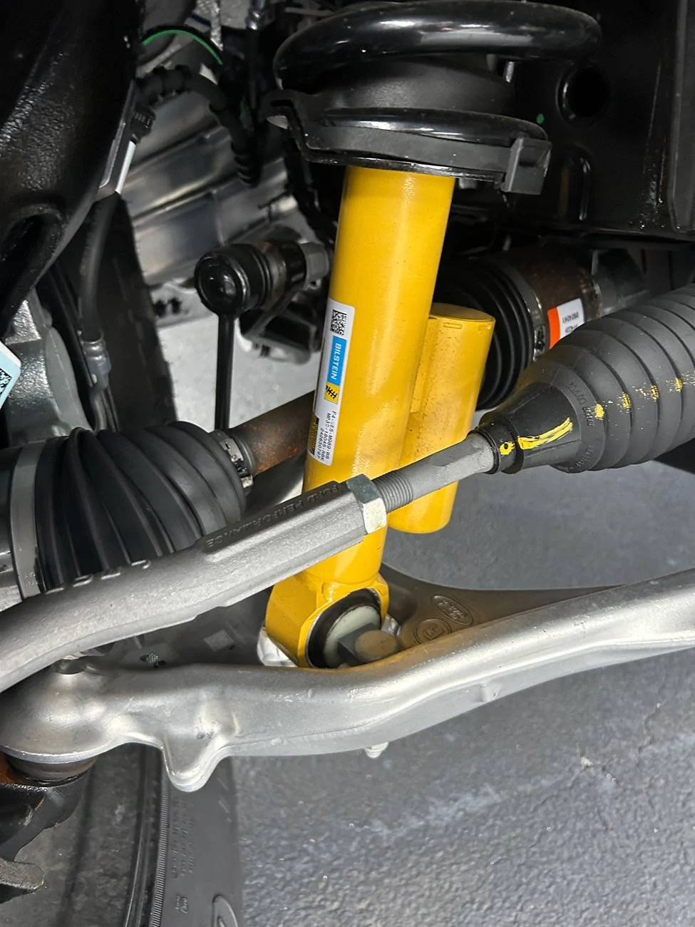

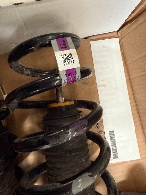

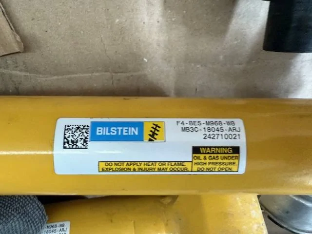

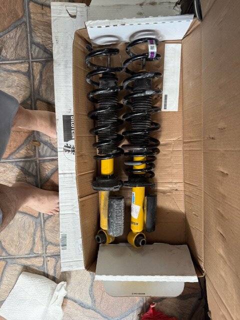

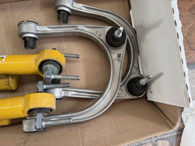

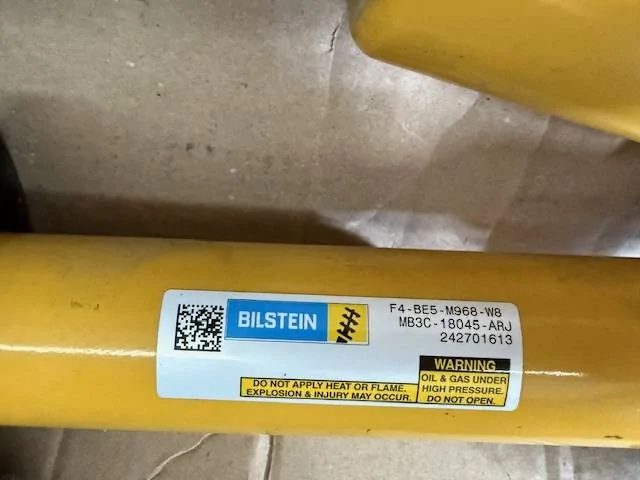

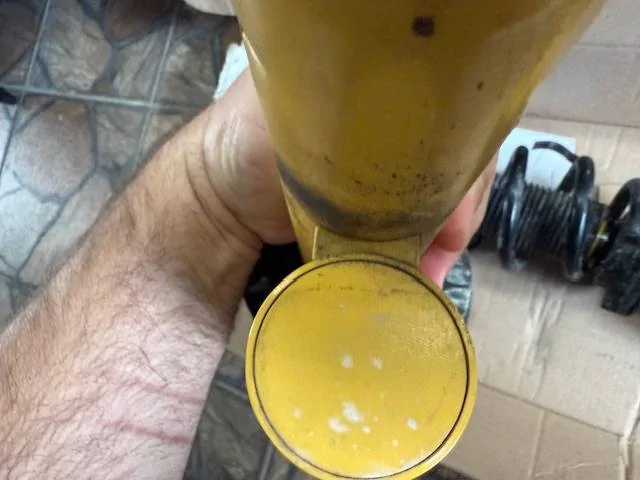

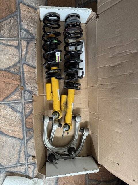

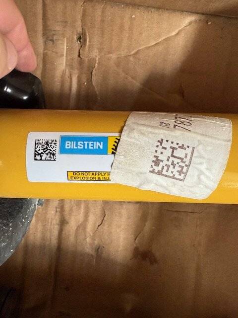

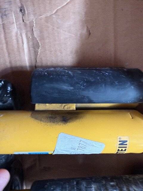

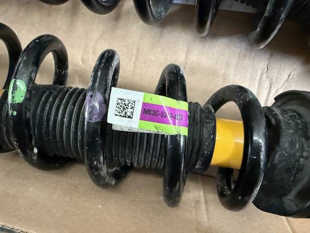

I took these off a few weeks ago and installed Bilstein 6112. My non sas badlands 4door has a build date of 10/24.
Ford Bronco Bilstein Shock recall IMG_0280
Ford Bronco Bilstein Shock recall IMG_0281
Ford Bronco Bilstein Shock recall IMG_0282
Ford Bronco Bilstein Shock recall IMG_0283
Ford Bronco Bilstein Shock recall IMG_0279
Ford Bronco Bilstein Shock recall IMG_0278
Ford Bronco Bilstein Shock recall IMG_0277
Ford Bronco Bilstein Shock recall IMG_0276
Ford Bronco Bilstein Shock recall IMG_0275
Ford Bronco Bilstein Shock recall IMG_0274
Ford Bronco Bilstein Shock recall IMG_0273
Ford Bronco Bilstein Shock recall IMG_0272
