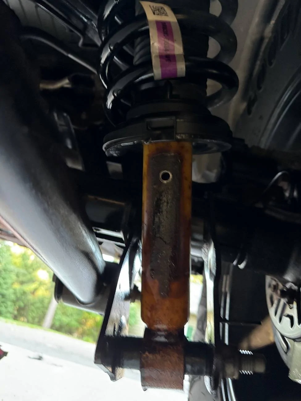

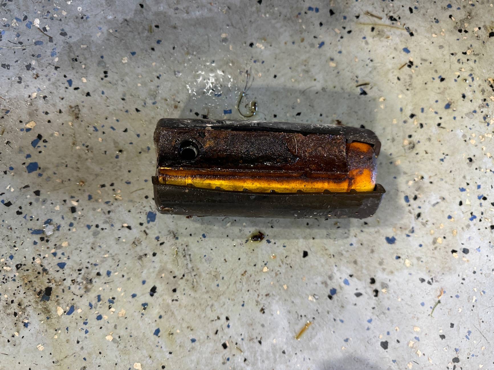

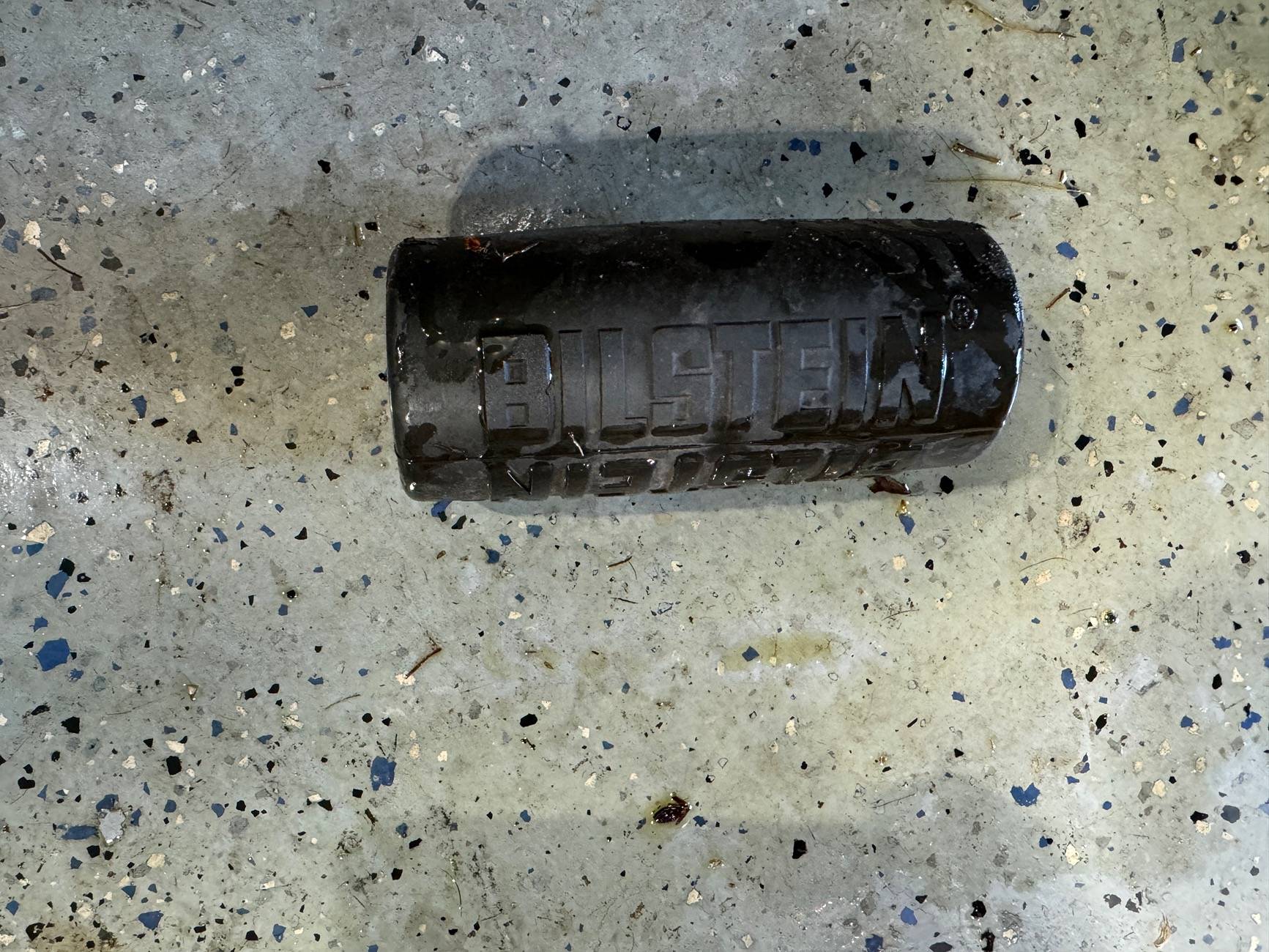

I just came out into my garage to find my diver-side rear reservoir laying on the ground as well. 2021 with 21,400 and basically a pavement princess as well. WHAT IS HAPPENING???
Since your avatar picture and your location assumes your pavement is covered in sodium chloride for 6 months out of 12, I’d say it’s the on road salt more than than the off road dirt portion.

That’s good! You may want to stay out of Wisconsin. We put more salt than snow on the roads.
Pretty crappy that these would fail from rust when not driven in salt. Mine sits all winter inside. I guess there will be some 6100’s in my future.

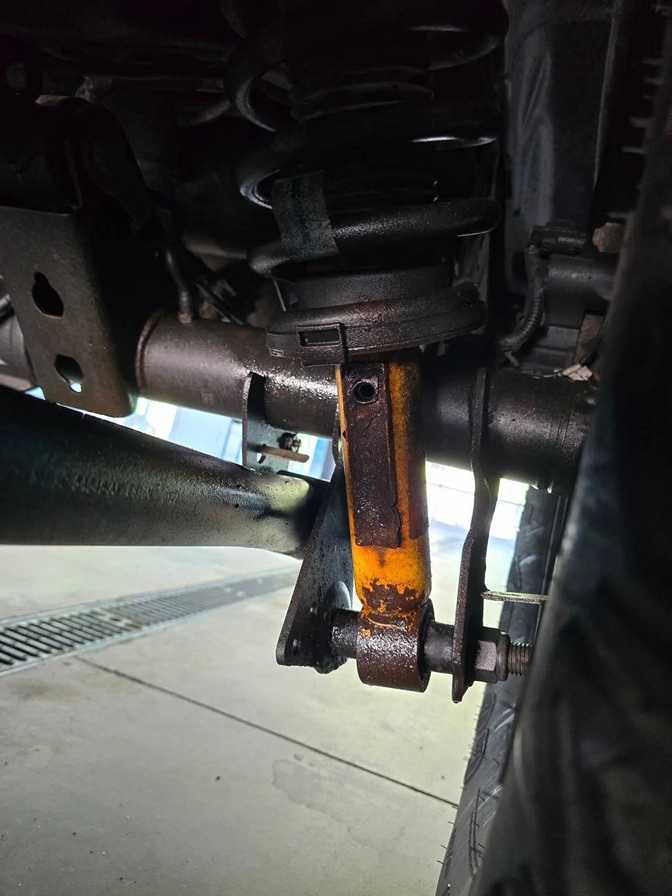

My rear reservoir on drivers side fell off also. I'm waiting to hear Fords response from the dealership. My 2022 Badlands Sasquatch is still in the service department and upon their inspection they notified me that the passenger side reservoir was in bad shape and will need to be replaced as well. As a Ford owner I'm concerned and disappointed my Bronco is only a year and a half old pavement princess with 20,500 Miles. I pray Ford and Bilstein resolves this issue. Despite this issue I still believe my Bronco is better than any Jeep I owned in the past. As one owner to all other 6G owners take time to look under your vehicle and inspect your rear shocks. Look for corrosion, a loose / missing
rubber reservoir or any signs of a leaking shock. For the sake of safety this issue can be very dangerous for an unexperienced driver or for someone not aware of the shock failure. God Bless.
Just an update, Ford replaced both rear shocks with no hassle. It took 3 weeks but they did provide me with a nice loaner Expedition. I am concerned that it was the exact same part as the ones that failed. However I will remain vigilant and hope it does not reoccur.

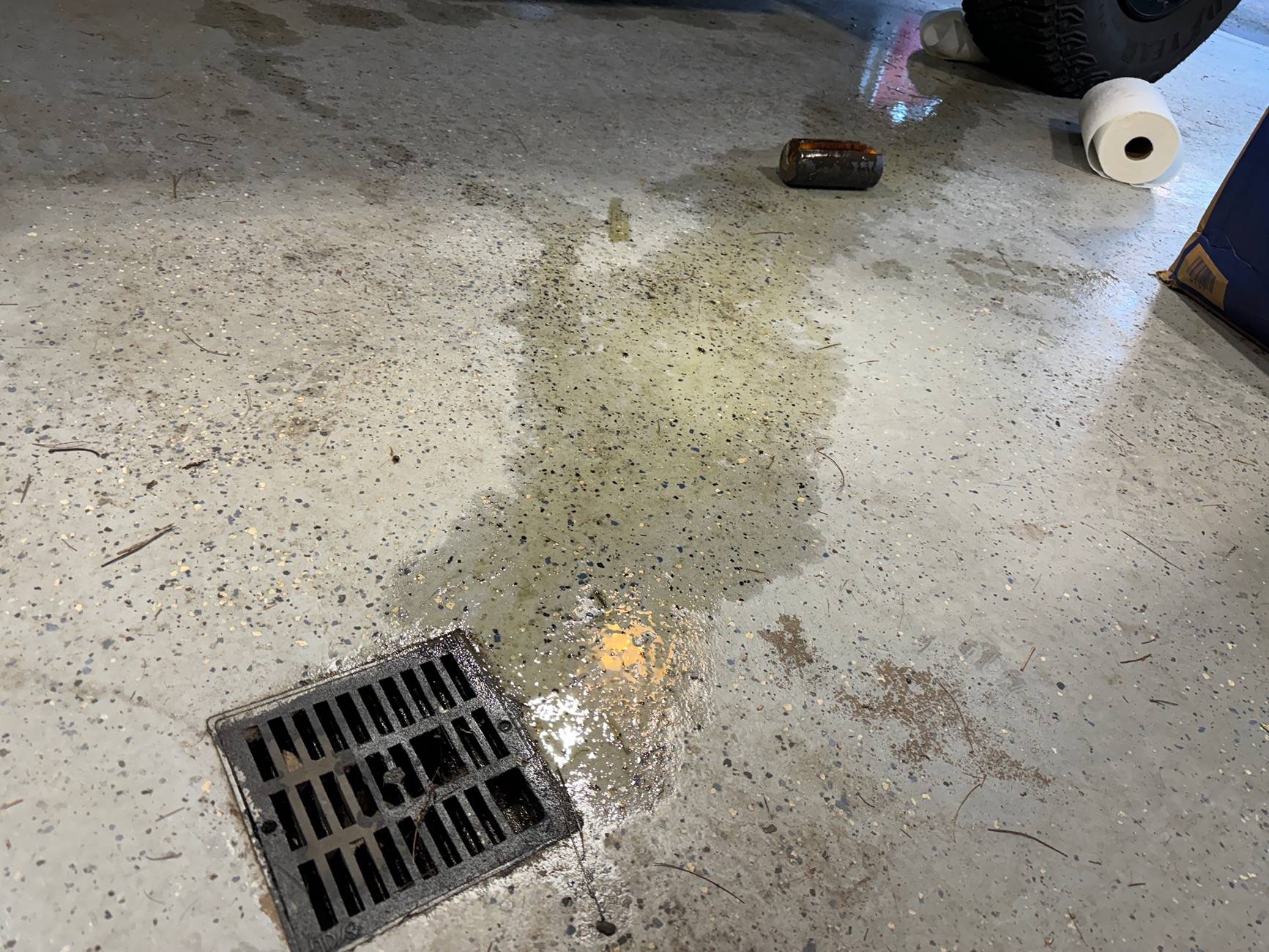

As much as a bummer as it is, at least you know your garage is sloped properly towards the floor drain 🤠
