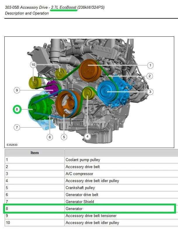

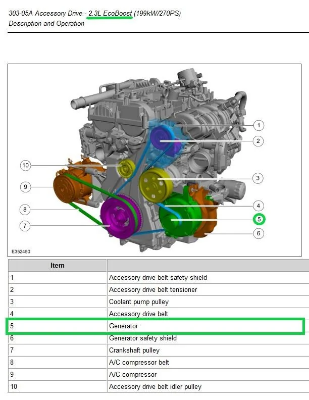

I've tried to look at pics to compare the two and it seems like the alternators are approximately the same height.
That’s correct. The physical location of the Generator (i.e., the name Ford uses in the Technical Service Manual, because the name "Alternator" was actually a Chrysler trademarked name in 1960) is not that different vertically between the two engines, although it is a little lower on the 2.7L V6 engine, and it is located on the passenger's side of the 2.7L V6 engine versus the driver's side of the 2.3L I4 engine.
Judging by the two alternators relative to the two crankshafts, it looks like the 2.7L V6 alternator is at least 4” lower than the 2.3L I4 alternator…
