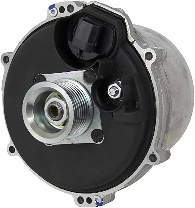

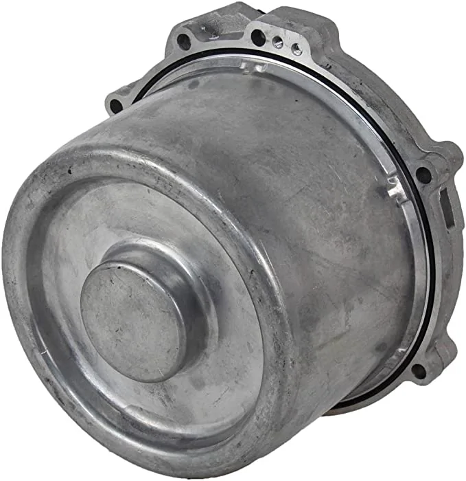

Now that you're a fancy distributor, how do you feel about stocking BMW parts? This might be a good time to point out that BMW has used sealed water-cooled alternators on a few eras of cars. For example, the 2004 745i which is 180A. It mounted into the engine block for cooling but if an eastern Washingtonian was to machine or cast a water jacket with cooling ports for the alternator to sit in with tabs to mount it to a Bronco engine, he might have a waterproof alternator solution.
Ford Bronco Bronco broken. Need an alternator ASAP. 61oJtaawj4L._AC_SX679_
Ford Bronco Bronco broken. Need an alternator ASAP. 61UIqocdhRL._AC_SX679_

🤷‍♂️ Have to try something if the vents all get plugged up. Other than grabbing a replacement for the 5 hour drive home. There has to be a solution other than not have fun.
