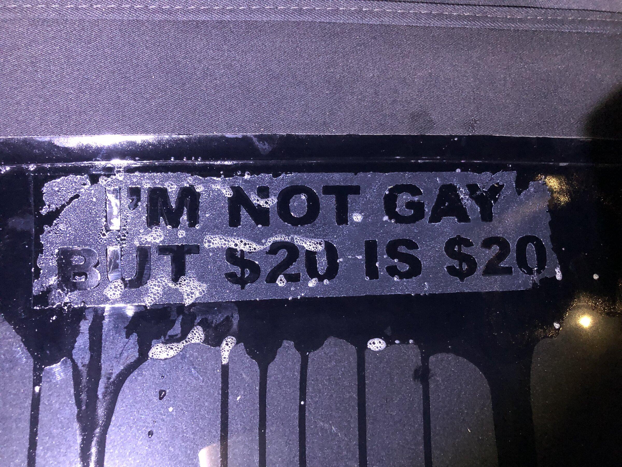

I’ve had my Bronco for four months. Tonight I parked a a buddy’s office lot to watch my kids in the Christmas parade downtown. Buddy evidently arrived there later and placed a profane bumper sticker onto my rear vinyl window as a joke. Right after using his sleeve to “clean” a spot for it on my gritty, dirty window—scratching it all up in the process. I pulled the sticker off upon discovery. The adhesive, however, will not come off.
I know acetone and petroleum-based cleaners are no-no’s that will damage the vinyl. So, I can’t use GoofOff. I tried a Maguier’s citrus-based product that didn’t do jack shit. So, is my window ruined, or what can I do?
I’m about to have to remove the back windows in freezing temps until I figure out how to safely remove the sticker since I can’t go driving around with it. See pic. I don’t mind the content of the joke, which is sophomoric but mildly humorous. It’s the fucking up of my window that I’m pissed about.

I read that you should not use alcohol.

Use a citrus based adhesive remover, it works faster and better than anything. Its natural and won't harm plastics. Denatured alcohol works on most adhesives and also won't harm plastics. 100% isopropyl alcohol is better, but its harder to find. Paint thinner will work but tends to leave a residue. DO NOT use lacquer thinner or acetone as you know. I then suggest giving you're friend a swift nut tapping, or at least covering all of his windows with shoe polish to teach him a lesson.

Tried citrus. It didn’t help at all.

I don't think what you used is sub par. I"ve wrapped several vehicles and always use a citrus base, but Its also purchased from a wrap supplier. I've used some lowes products with good luck as well. let me do quick search and will post back.

I used Maguier’s. It says it works on vinyl.
