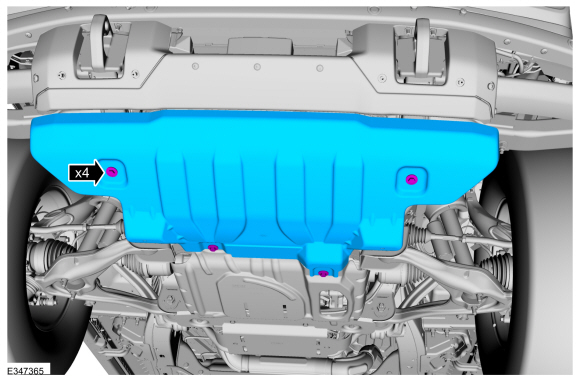

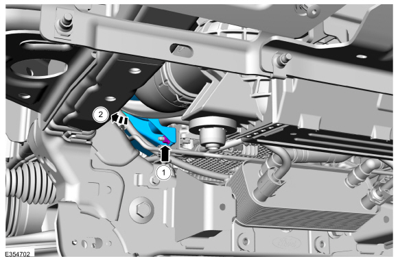

  1. Remove the bolts and the front skid plate.
    Torque: 22 lb.ft (30 Nm)
Ford Bronco {thread} {filename}
Ford Bronco Bronco broken. Need an alternator ASAP. video
Ford Bronco Bronco broken. Need an alternator ASAP. Hel

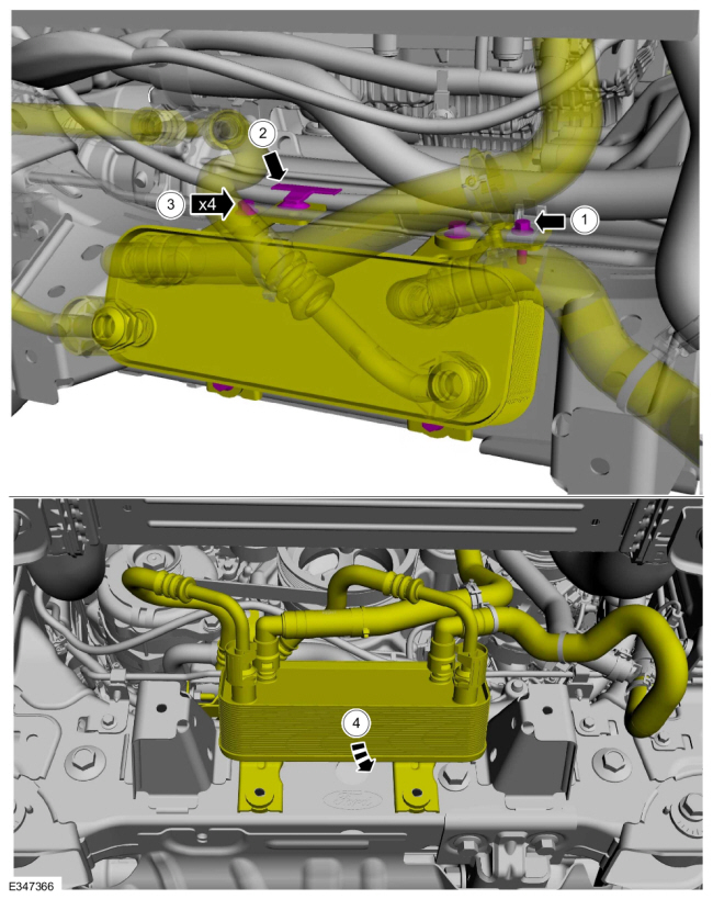

  1. NOTE: Use a suitable wire or wire tie to support the transmisson fluid heat exchanger.
    Position and support the transmisson fluid heat exchanger.
    1. Remove the transmisson fluid heat exchanger line bracket bolt.
      Torque: 177 lb.in (20 Nm)
    1. Separate the wiring guides.
    1. Remove the transmisson fluid heat exchanger bolts.
      Torque: 159 lb.in (18 Nm)
    1. Position the transmisson fluid heat exchanger aside.

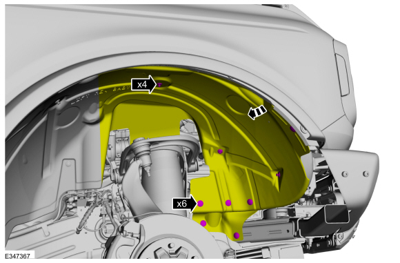

  1. Remove the pin-type retainers, the push pins and position the fender liner aside.

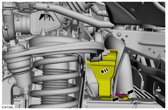

  1. Remove the generator splash shield.
    • Remove the lower generator shield nut.
      Torque: 18 lb.ft (25 Nm)
    • Position the generator shield off the generator.

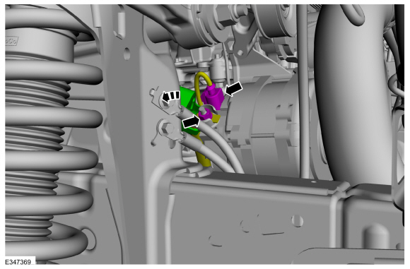

  1. NOTICE: When installing the B+ terminal nut to the generator, finger-start the nut before tightening or component damage may occur.
    Disconnect the generator electrical connector. Position the B+ wire protective cover, remove the nut and position the B+ wire.
    Torque: 155 lb.in (17.5 Nm)

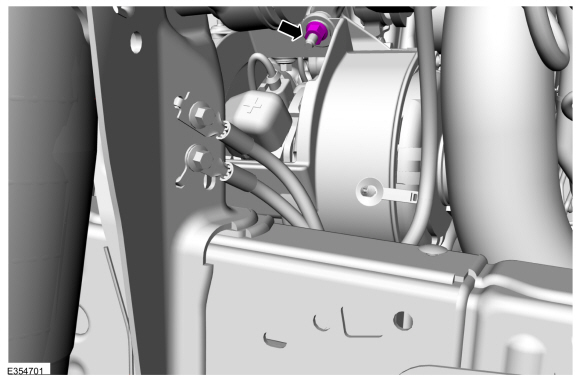

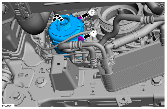

    1. Remove the generator bolt.
      Torque: 35 lb.ft (47 Nm)
    1. Remove the generator stud nut and the generator.
