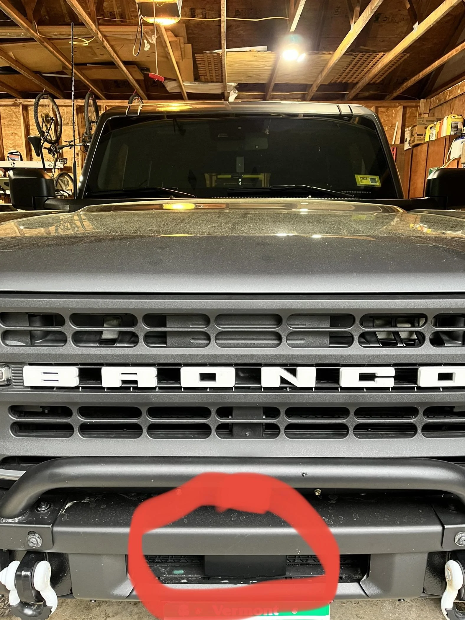

I have a black diamond with mid and sas package. So no front camera.
but where are the sensors for collision avoidance and such.
are they up in the mirror?
Essentially I want to know if there is anything in the plastic housing where the I think the ACC sensors would be in models equipped with it.
If I get a winch do I need to worry about relocating anything on my model?

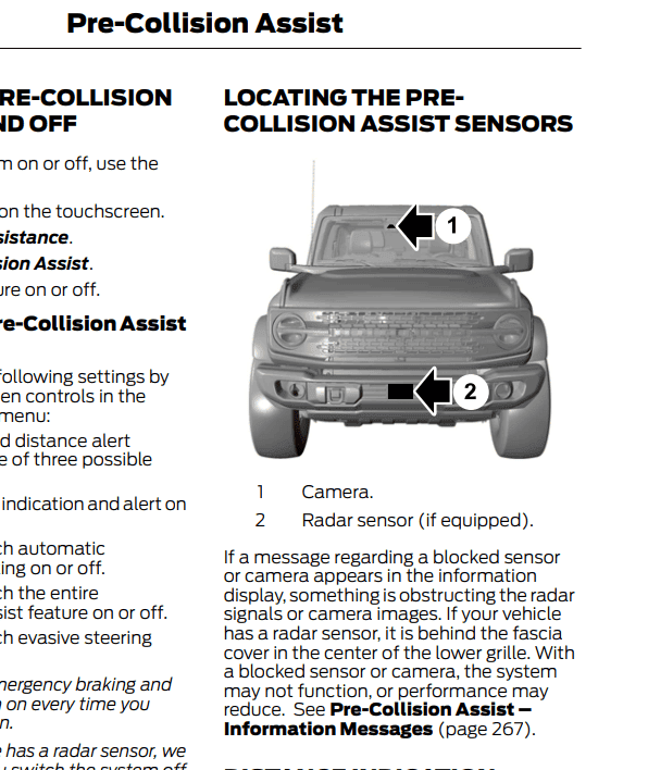

cover the plastic plate with a piece of food grade aluminum foil.
it'll give an alert on the dash if the pre-collision sensor is in there
when you fire up the vehicle.
