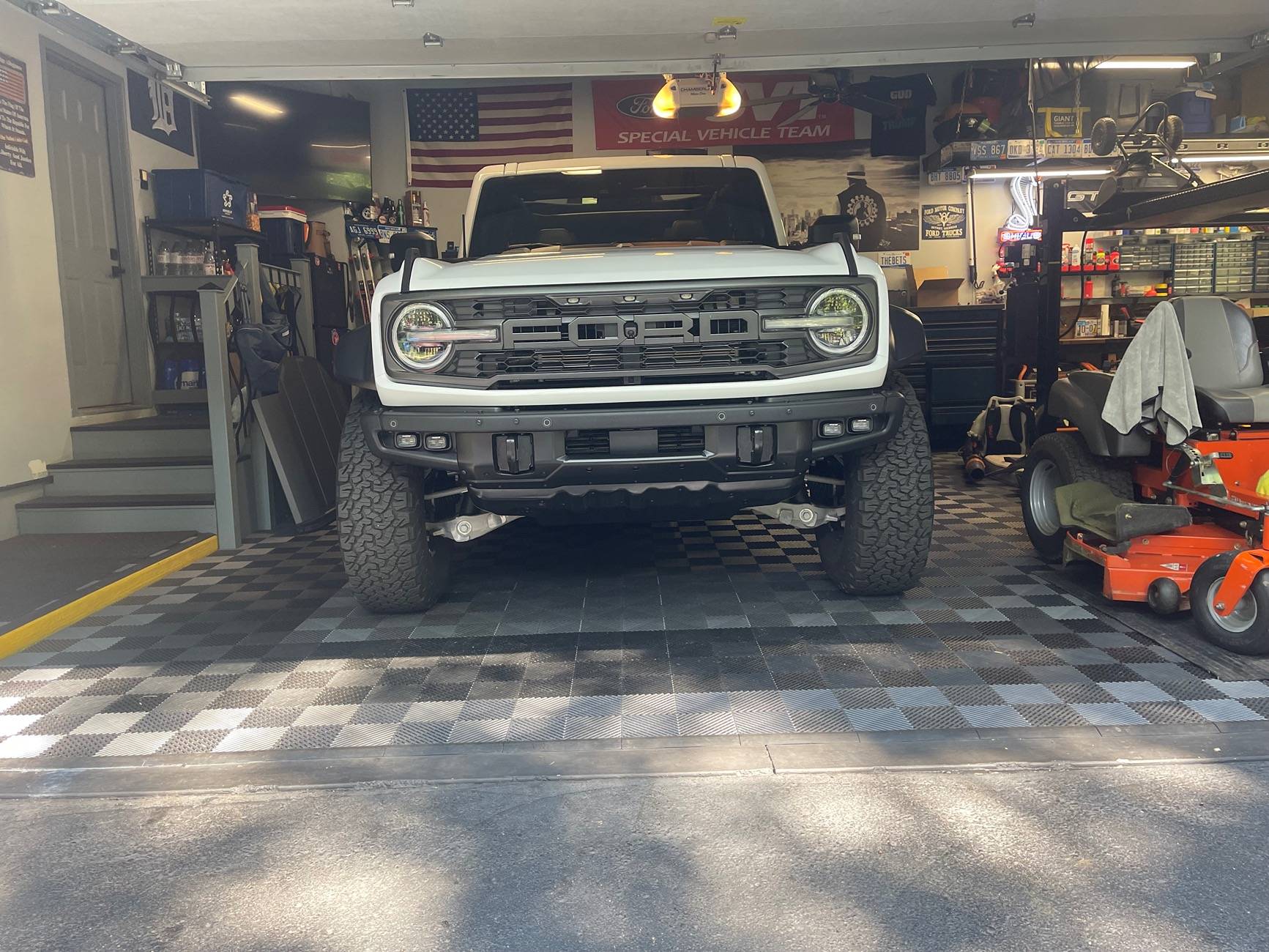

Seems a number have done this and each in their own way. I wanted to use as much OEM hardware as possible and worked with my favorite Ford parts guy to track down hardware from the new for 2024 Bronco Raptor Black Appearance Package. I started by finding the VIN for a Raptor equipped as such and getting it to him so he could peruse the HVBOM and come up with some part numbers and prices for these two areas...
Ford Bronco Blacked out bash plate and bumper sections ance_package_8_2560x1440%20highlighted%20pieces-X4
Bash plate - forget it as it was over 2k. Backup plan for that part was to paint as others have done. I wanted the two "hooks" as I figured the coating on the OEM pieces would be better than paint, etc. And I wanted the plastic trim piece in black as again, I figured it would be more robust than painting the original silver piece.
Ford Bronco Blacked out bash plate and bumper sections 20240906_122330-X5
Ford Bronco Blacked out bash plate and bumper sections 20240906_122920-X4
Ford Bronco Blacked out bash plate and bumper sections 20240906_123740-X4
Ford Bronco Blacked out bash plate and bumper sections 20240906_140041-X4
Ford Bronco Blacked out bash plate and bumper sections 20240906_124423-X4
Plastic piece was perfect. The black hooks...coating was shit. Chips galore, barely a single coat on them. I chose to eventually coat them with POR15.
Ford Bronco Blacked out bash plate and bumper sections 20240906_133153-X4
Ford Bronco Blacked out bash plate and bumper sections 20240906_151451-X3
Install was relatively straightforward.
Ford Bronco Blacked out bash plate and bumper sections 20240906_162645%20copy-X3
Ford Bronco Blacked out bash plate and bumper sections 20240906_163044-X3
I did have to pull the bumper off to get at the tiny screw holding each hook in place (thanks Ford!). Be sure to disconnect the wiring harness connector on the driver side of the bumper in order to be able to lower the bumper assembly down and out of the way.
Ford Bronco Blacked out bash plate and bumper sections 20240906_171615-X3
I degreased the silver bash plate, dried it off, warmed it up, and painted it with SEM Trim Black (2 cans).
Ford Bronco Blacked out bash plate and bumper sections 20240906_181046-X3
Ford Bronco Blacked out bash plate and bumper sections 20240906_220313-X3
Ford Bronco Blacked out bash plate and bumper sections 20240907_125712-X3
Ford Bronco Blacked out bash plate and bumper sections 20240907_131316-X3
Just for shits, I placed the silver one back on...
Ford Bronco Blacked out bash plate and bumper sections 20240907_131600-X3
Nope!
Ford Bronco Blacked out bash plate and bumper sections 20240907_133522-X3
Ford Bronco Blacked out bash plate and bumper sections 20240907_134010-X5
Very happy with how it turned out. Lesson learned, save money and just paint your hooks as the black hooks aren't coated as well as our original silver ones were.

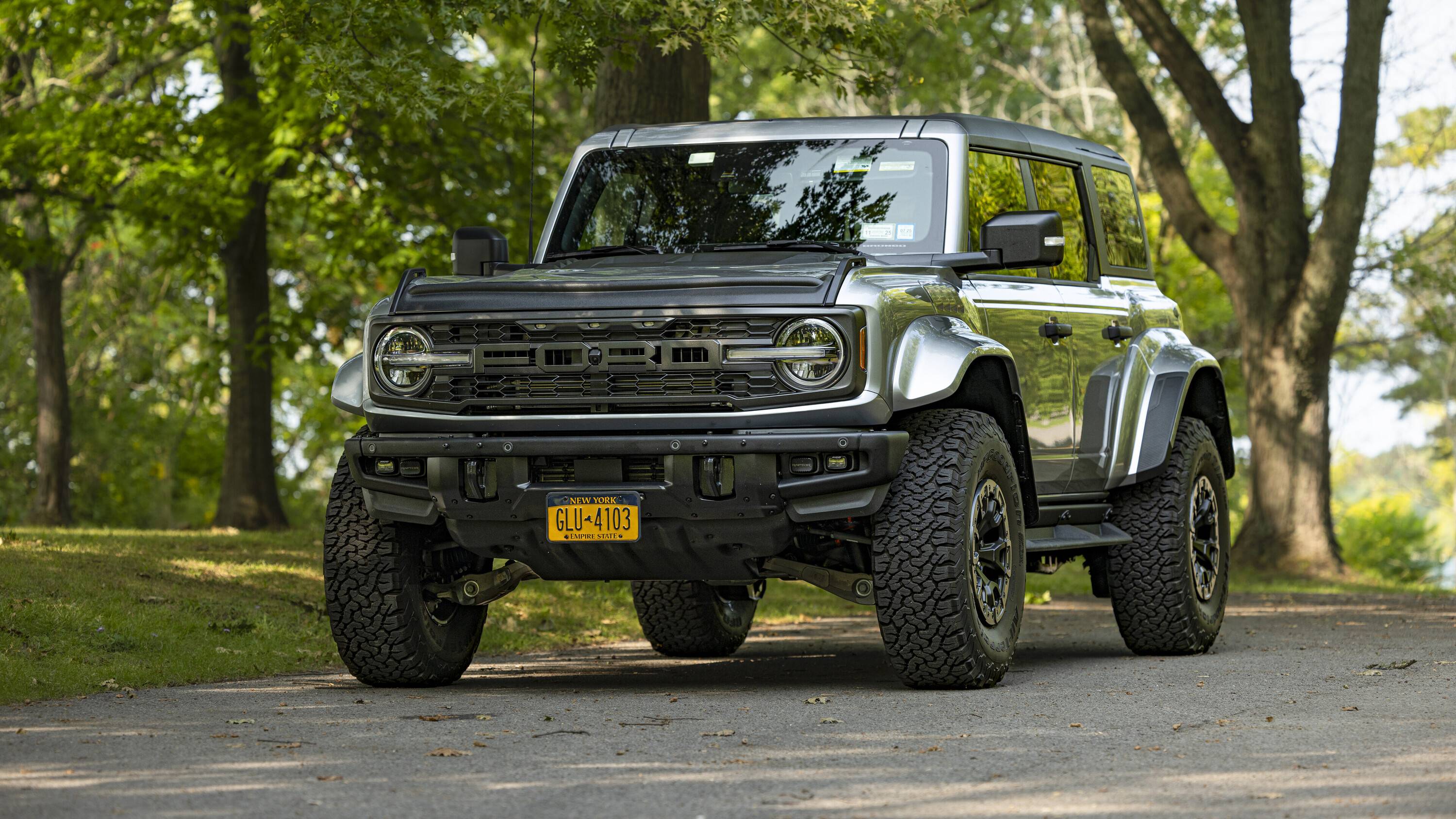

Damn, Iconic Silver on the Braptor looks super sick, esp w that color matching you did. Solid!

Thanks man. To be honest, I felt guilty about posting a phone shot. I'll get higher quality photos from my Canon R5 soon.
You know, I go back and forth with this one. The silver plate/hooks/fascia did break it up somewhat. They brought detail down low when seen from the front, such as the ribbing on the bash plate. When blacked out, it kind of becomes a sea of darkness and that detail is gone. Your eyes focus higher up now, on the actual truck. Kind of a weird brain thing - maybe it's just me and some good old cognitive dissonance, don't know. I just have to adjust to it.

Looks fantastic!! Should come that way stock! Great minds think alike.
