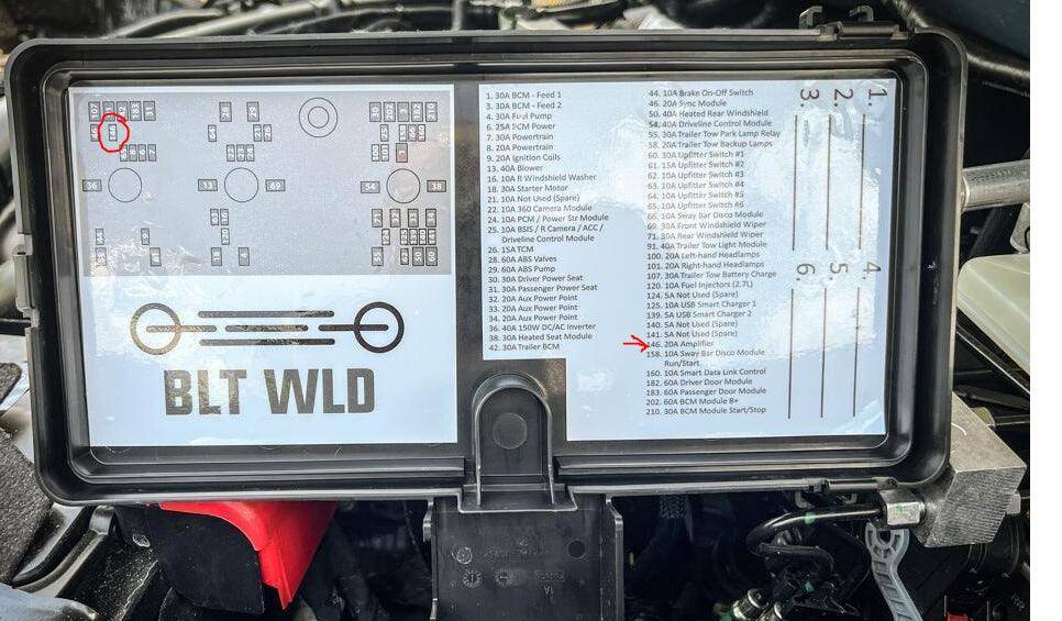

I thought i screwed my amplifier up.. we have had like 3 solid weeks of rain, and the connector to the amp was drenched. put a fuse in, and instantly pop. i pulled the rear apart, disconnect the amp. blasted it all with air to push the water out, gave it all a good dose of dielectric grease to seal it up, reassembled, installed new fuse, and was good to go.
Check fuse #146 under the hood.

Thank you yes I checked the fuse right when my speakers stopped working. Actually brought my car to the dealership about a month ago because the only speakers that worked was the front center and the two rears. They said it was my acm. So i brought my car back in today to have the acm replaced and when they went to power it all up they said the amp was blown.
