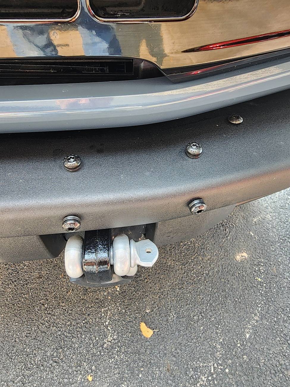

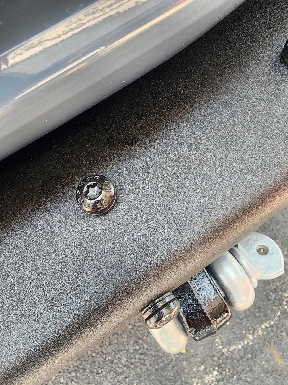

Does anyone know what size torx these woukd be. AT40 is to small and T45 is to big.

V1Rotate Well-Known Member First Name Bryan Joined Oct 18, 2022 Threads 9 Messages 931 Reaction score 2,308 Location Brevard, NC Vehicle(s) 2022 Wildtrak Your Bronco Model Wildtrak Clubs Sep 10, 2024 #2 They’re torx plus. There’s a little bit of overlap with regular Torx sizes as you get bigger but you’re going to want to pick up a set
Kasavias Member First Name Alex Joined Dec 4, 2023 Threads 0 Messages 9 Reaction score 8 Location Austin, TX Vehicle(s) '24 Bronco Your Bronco Model Badlands Sep 10, 2024 #3 Torx Plus 40 (TP40)

MNBigfoot Well-Known Member Joined Nov 13, 2021 Threads 10 Messages 4,002 Reaction score 9,025 Location MN Vehicle(s) F150 Your Bronco Model Base Sep 10, 2024 #5 Fordified1 said: That size isn’t included in the tool kit? Click to expand... I believe the kit has TP30 and TP50.
