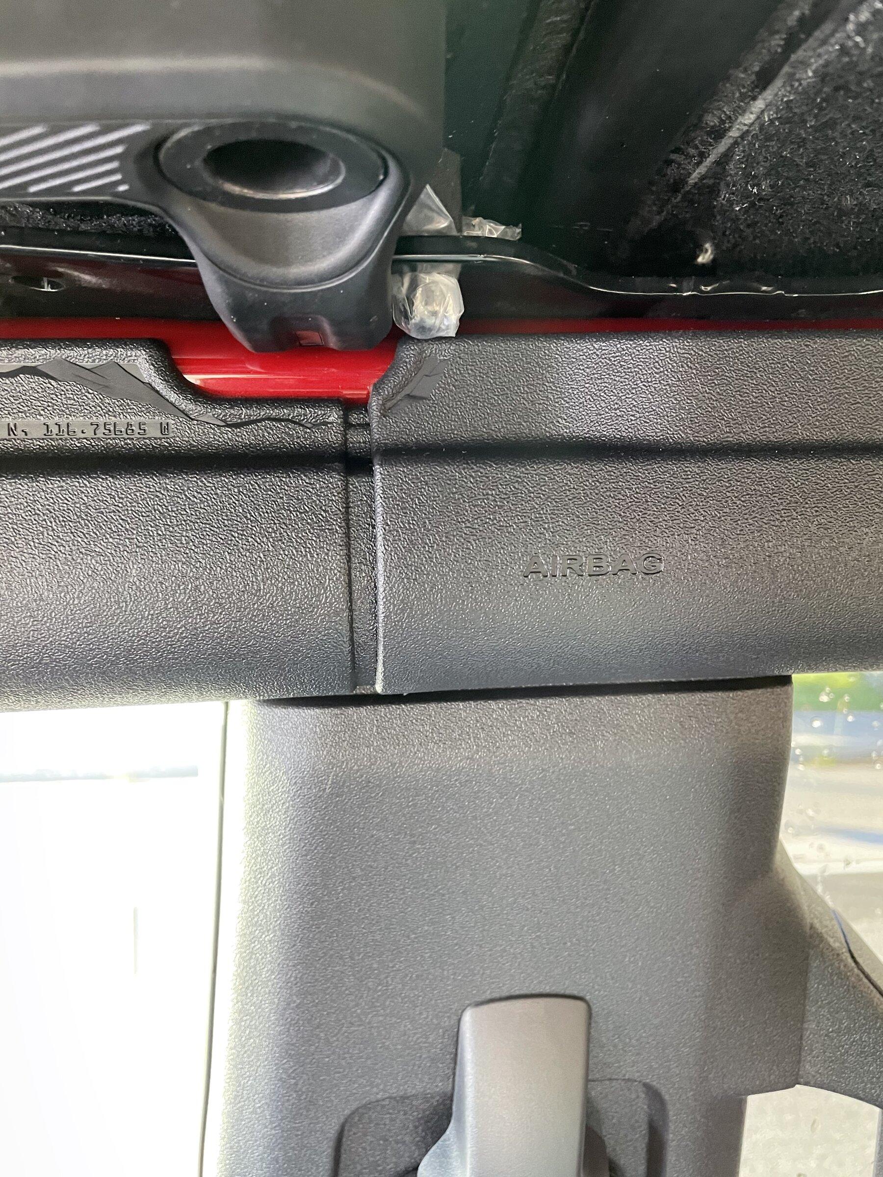

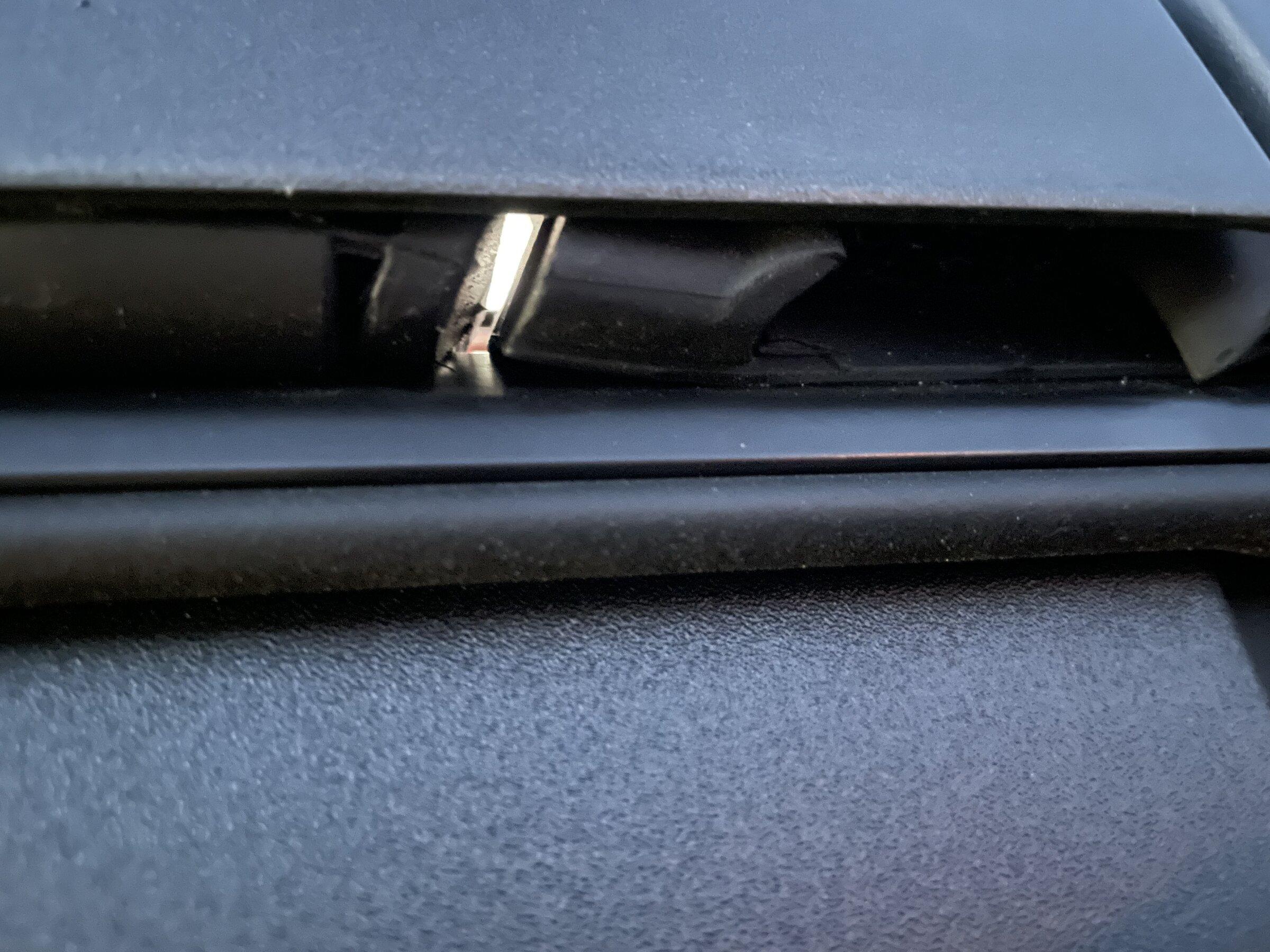

Took delivery of our First Edition late November, here is what our hardtop looks and sounds like… anyone experiencing the same thing?
Yes my FE MIC 2.0 has all those issues and more. I described it as garbage the hour I took delivery, and that was on appearance alone. The rattling didn’t start until 1,000 miles. My top has all the known issues, snakeskin, delam, glue overspray, carpet fuzz raining down, headliner cut by a kindergartner, gaskets that were cut by a kindergartner, and more I’m probably forgetting. Oh ya huge gaps in the gaskets that cause crazy wind noise.

I can’t help you on all that. But the good news is the rattling can be easily fixed. It’s the guide pins. There are many ways you can dampen them, the easiest and what i do is wrap them in electrical tape. My first fix when diagnosing the problem was literally some plastic wrapper from the garbage. Fixed it perfect.

Exactly the same issues on mine.. I’ll give that Electrical tape a try. Thx man
