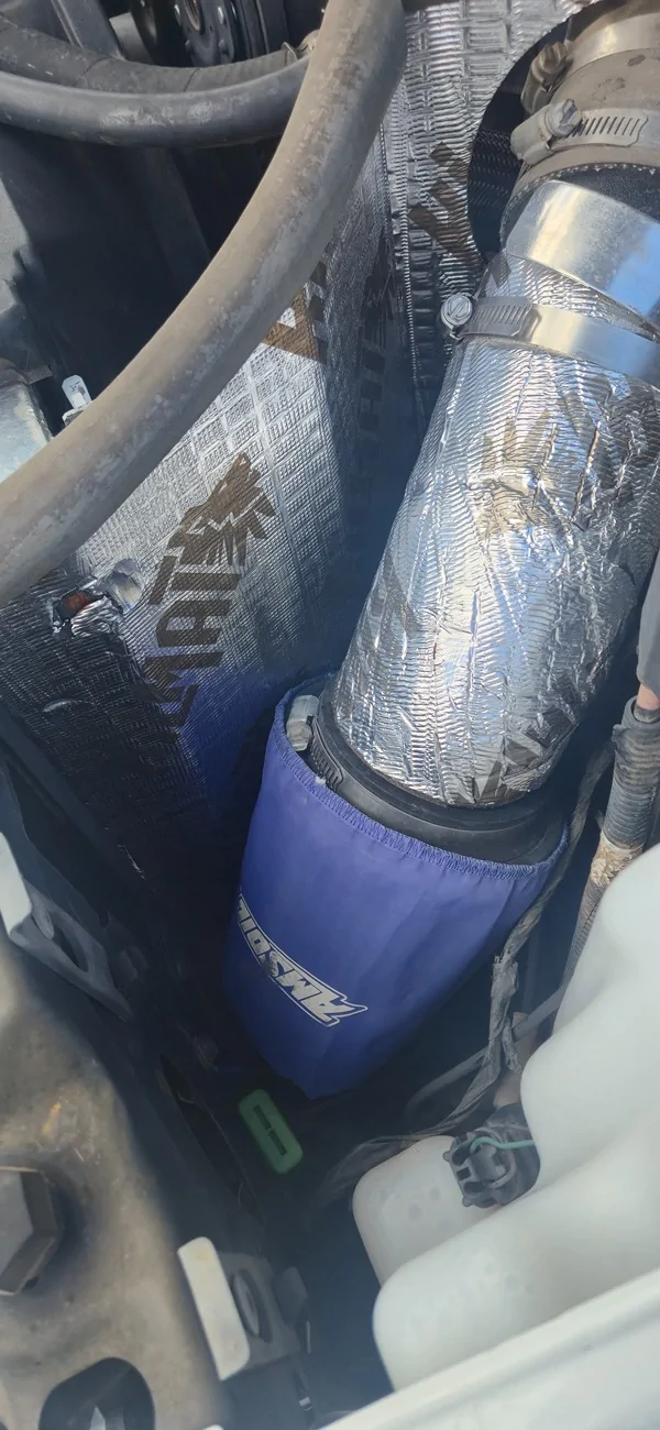

That's weird.. This is what I'm running in the factory airbox.
Ford Bronco Bronco Reusable Air Filter Options 1000012240
https://volant.com/products/powerco...dOn3Xa9DS6lpGLYgrqiOahMQANcUVKCSDmM9f9gohAOao
https://volant.com/products/pre-fil...p04vNoEdVyGGsP8nnHiT0ESTmXzE-LF18QOC0N0I2PKwk

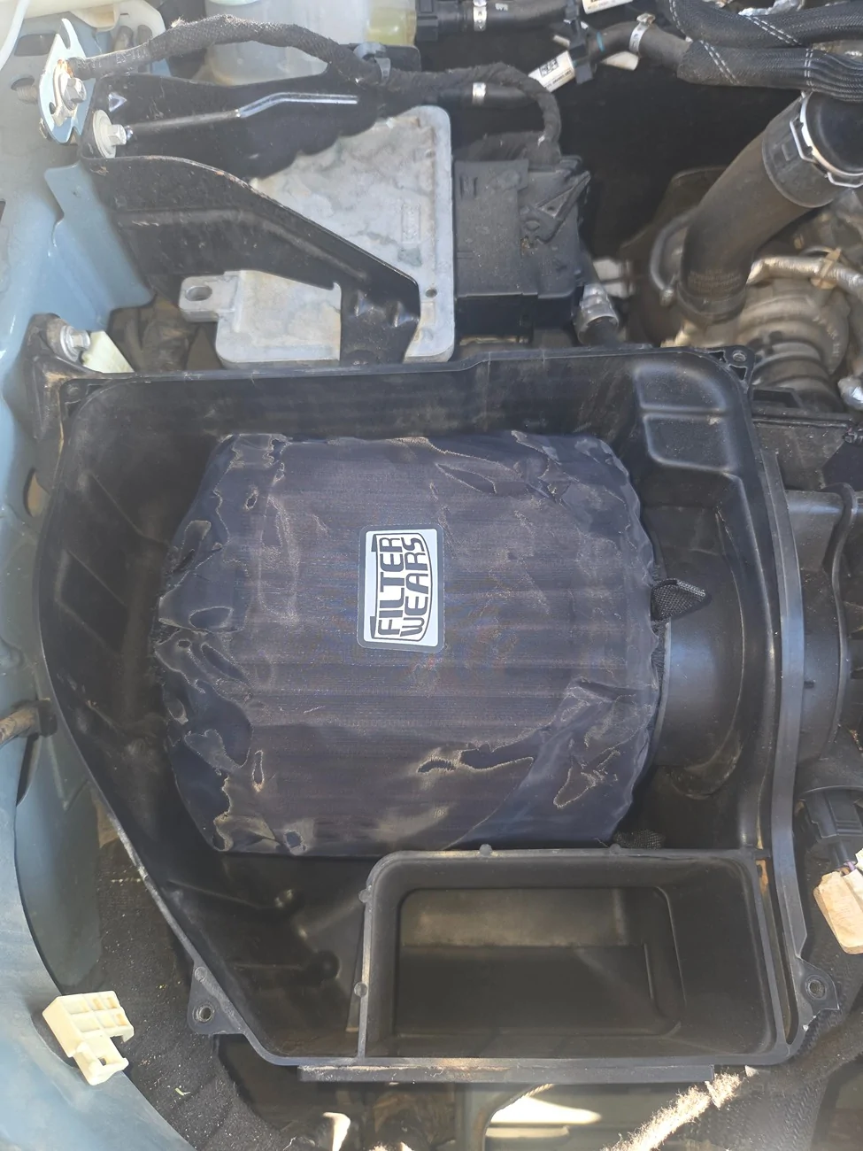

Stroppe
Over the life of the vehicle;
What dollar amount is saved over buying paper filters?
Nothing measurable to an extent it can be called value.
Sales brochure knowledge...isn't.
Buy a pre-filter.

I decided to just add a filter sock for now. If anyone else is looking FilterWears recommended this filter sock to me for the K&N E-0634 as its the closest match they had. I may modify it a bit for the open end so it dosesnt potentially move and expose the filter. If more filters become available or more information for off road use on the ones I was looking at then I may swap out the K&N.

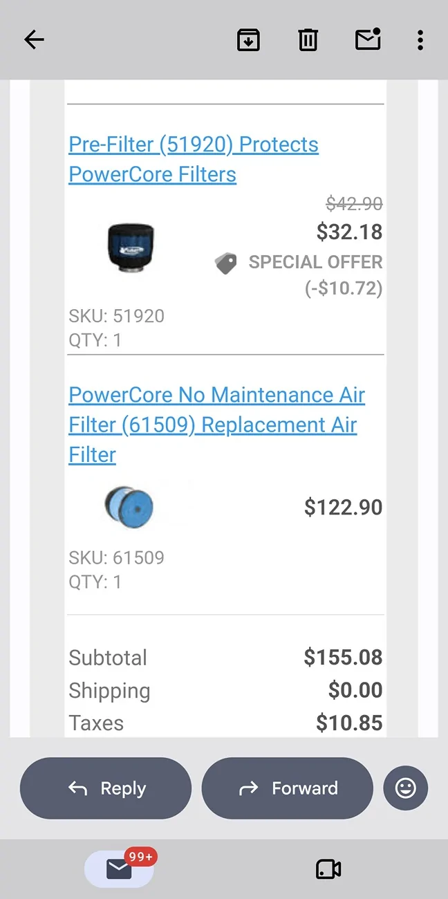

I have about 30k miles on and off road so far with it with the 2.7l. Haven't had any issues so far knock on wood.
Update got the pre filter fits pretty good will see how things go:
Ford Bronco Bronco Reusable Air Filter Options 1000024226
Also side note Mishimoto got back to me and said its all private information. They wouldn't share how many layers, what material, or how efficient their washable oiless air filter is. Just knowing that they are definitely out of the running.
