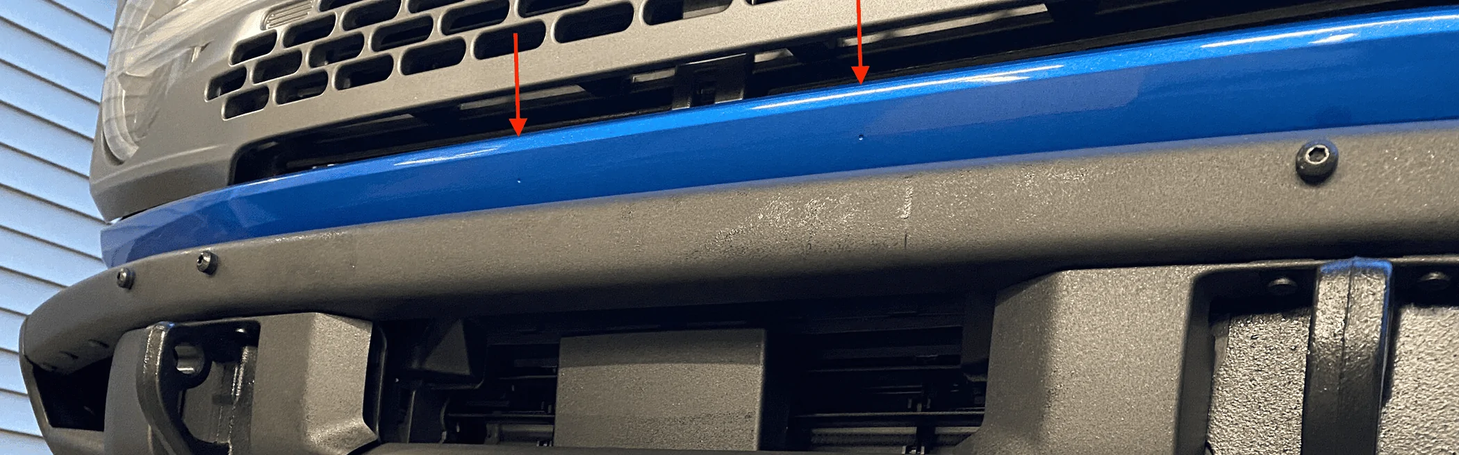

Believe it or not, they're actually supposed to drill into the trim piece. That's the official Ford-approved license plate mounting location.
If you look at that trim piece there is actually two little dimples in it to show dealerships exactly were to drill.
(Borrowing a photo from @Roger123's Bronco).

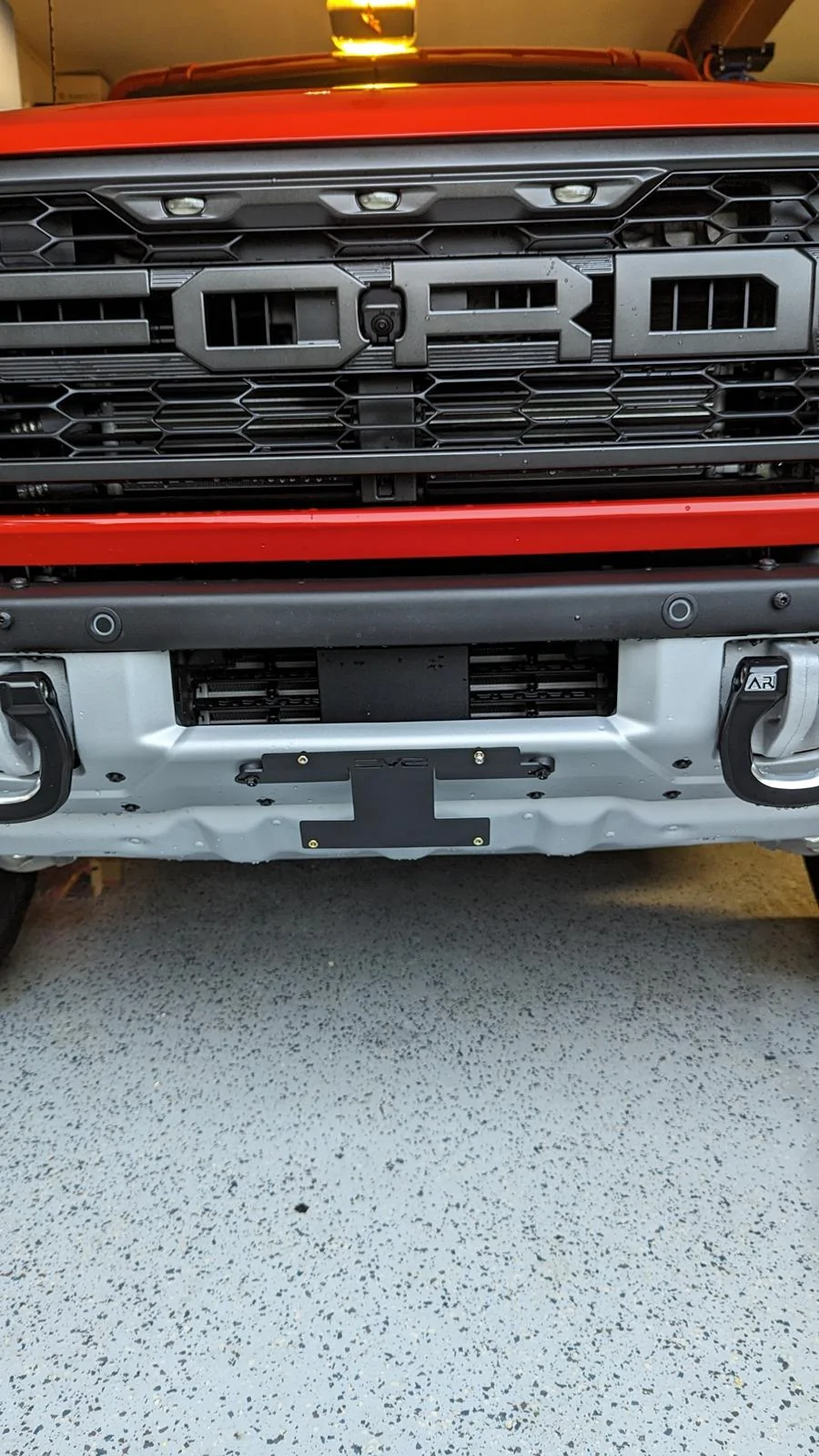

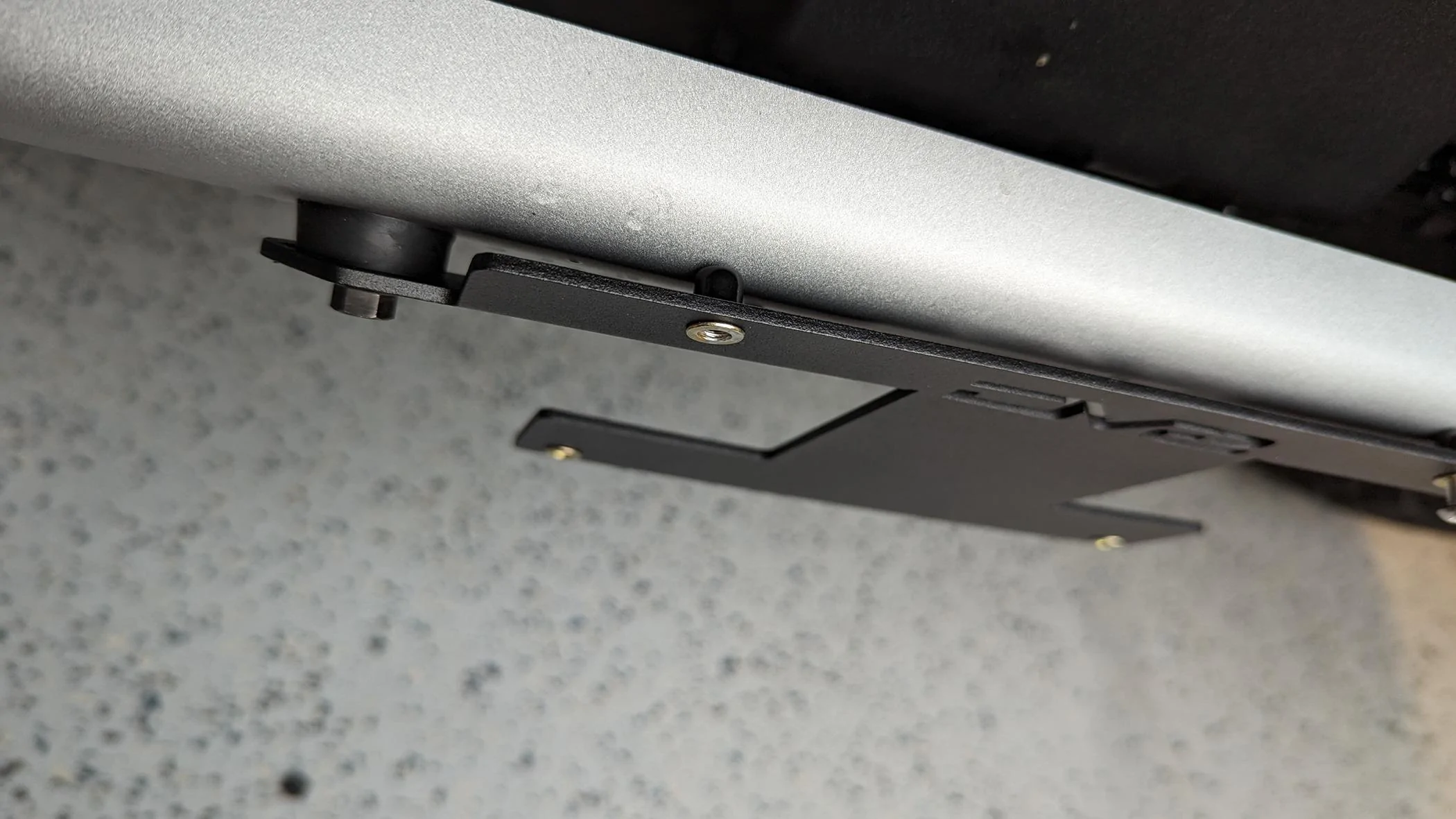

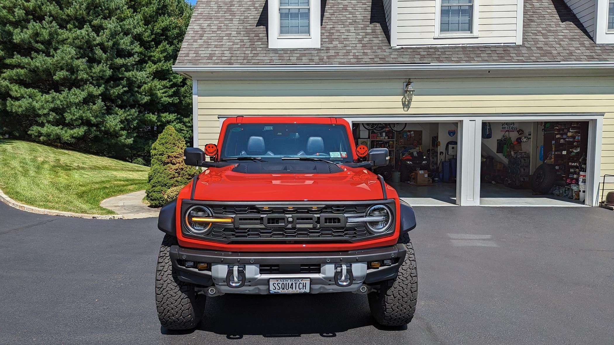

@DV8offroad makes a great one (yes it is already angled to follow modular bumper lines) - needs some spacers to fit Raptor but all items easily sourced on Amazon. Also - I installed rivnuts to make it a cleaner attachment than nut & bolt.

I used the same bracket and picked up new bolts and plastic spacers at Lowe’s. Looks far better than the stock location And bracket

Pretty sure these were the bolts - but I may have used something else - easy enough to take the existing Bronco Bolt to home depot and get it 1/2" or so longer
https://www.amazon.com/gp/product/B0BWY22SWS/ref=ppx_yo_dt_b_search_asin_title?ie=UTF8&th=1
For license plate into the rivnut:
https://www.amazon.com/gp/product/B09DL4S31P/ref=ppx_yo_dt_b_search_asin_title?ie=UTF8&psc=1
To cover the rivnut back end so it doesn't rub on bumper:
https://www.amazon.com/gp/product/B0B4G1F84B/ref=ppx_yo_dt_b_search_asin_title?ie=UTF8&th=1
