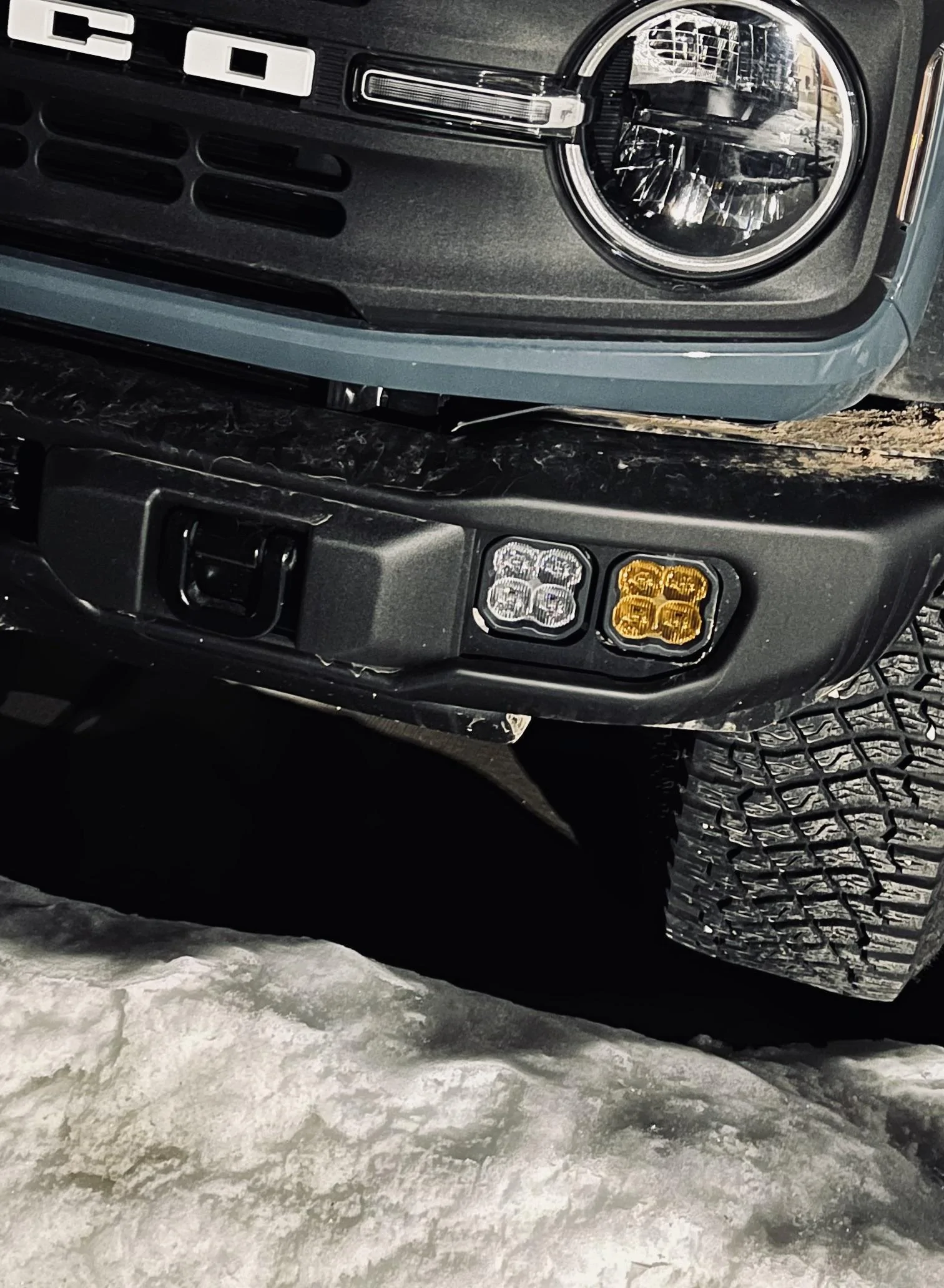

The Diode Dynamics lights from 4X4truckleds.com are great! These lights got me through a few blizzard commutes in December and January. The ambers are hooked up to my fog light switch and the whites are on my Aux switch #3.
Ford Bronco Capable Bumper LED conversion. IMG_3318

Good to hear, looks great too. I’ve got those from the same vendor sitting in a box right next to a capable bumper I’m going to install. Now all I need is my Bronco (It should be here in a few weeks!).

That's great! I installed mine with the tires on; the video always shows a really cool shop with a lift and a bajillion tools. We have the tools though ;) So crawling on a cold concrete floor in December was not fun. Instructions were straight forward. I ran the wires for the aux lights on the passenger side up behind the headlight and wire tied it along the other wire loom across the back of the radiator on the frame for a cleaner look. I think the instructions just say to run the extra wire up across the top of the bash plate. Hope your Bronco arrives soon--the wait is worth it!

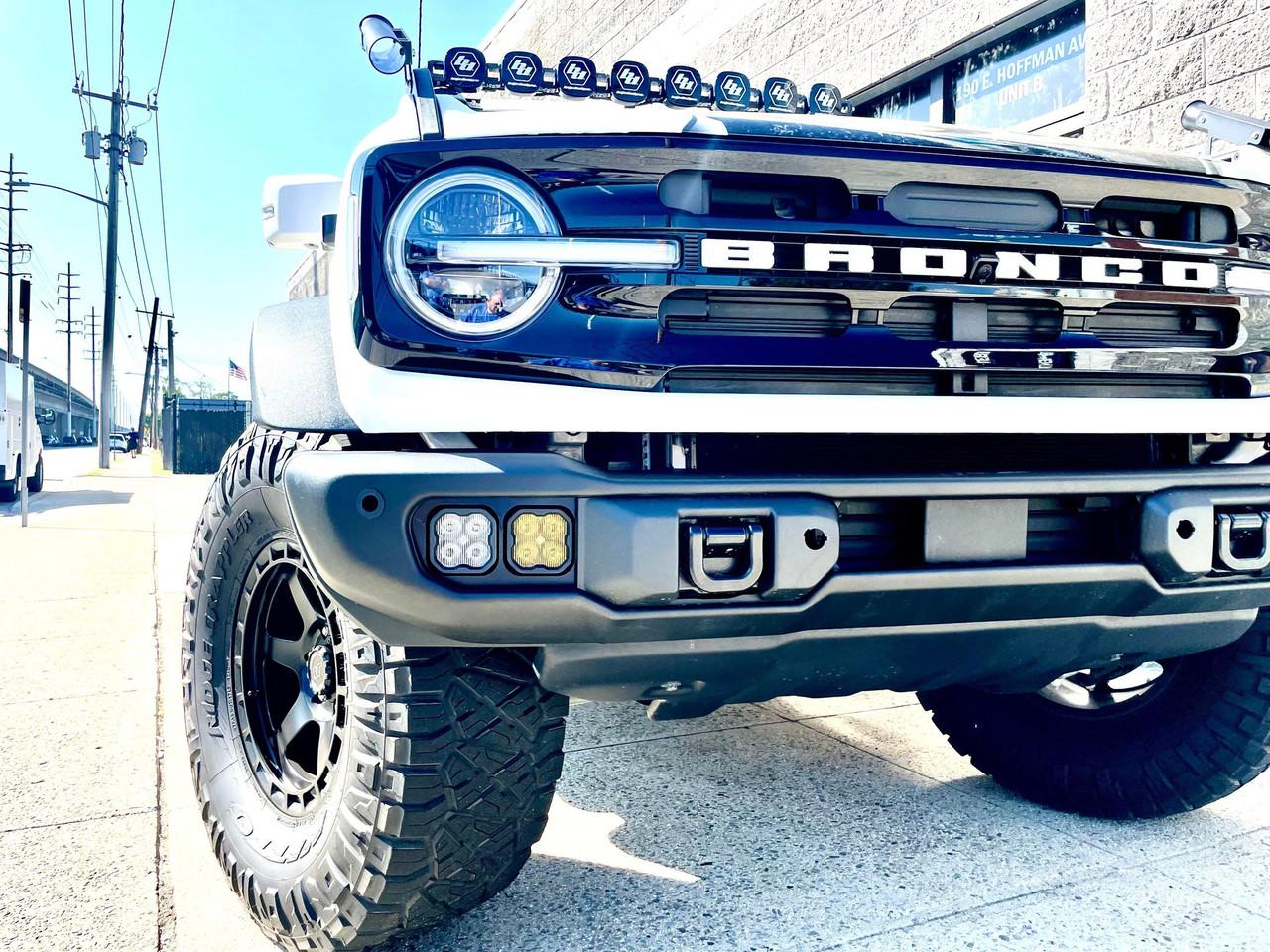

The Diode Dynamics capable bumper fog brackets I have might work, with some slight modification, since the screw location on the Baja Designs Squadrons is lower than the DD SS3's center mount.
Ford Bronco Capable Bumper LED conversion. 20240117_205729
They worked well when I had the stock bumper.
