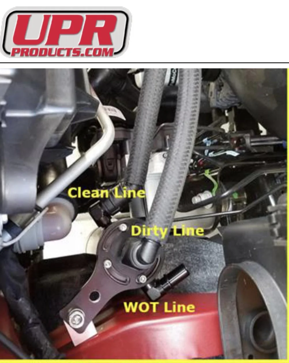

Ok fellas, after a deep dive into what @BrentC said and digging into what da fuck is a WOT line's purpose on a oil catch can, I found this site with the most comprehensive answers .... at least for me. They sell catch cans too but on the surface it seems like they custom make them to specific models. I will contact them and see what they have to say and post it if of any value.
have a look see;
http://www.eliteengineeringusa.com/ford/
http://www.eliteengineeringusa.com/faqs/
have a look see;
The FAQs are spot-on AFAIK.

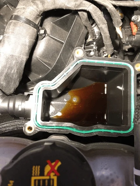

The stuff I dump out of the catch can has a unique smell and is more an emulsion than an oil. The acidic water mentioned in the FAQs is removed with the UBR.

The stuff I dump out of the catch can has a unique smell and is more an emulsion than an oil. The acidic water mentioned in the FAQs if removed with the UBR.
yeah it was eye opening to see the stuff caught in the can is less oil than other contaminants!

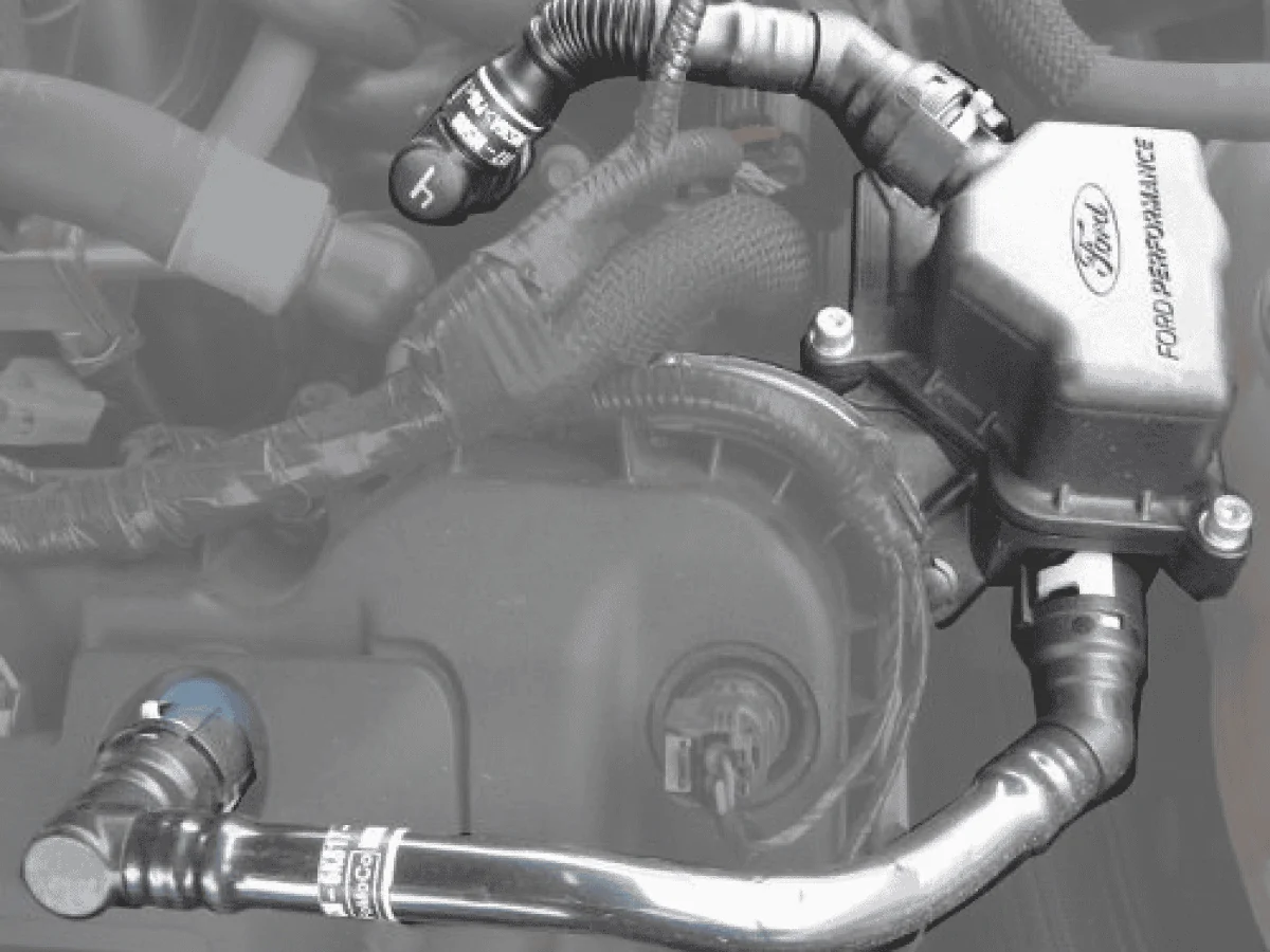

if the factory PCV system was adequate Ford itself would not make a catch can to be installed in its vehicles.
Again, the factory PCV system is adequate for the majority of vehicles. Unless you drive at high boost or high RPMs for extended periods, it's not needed. The Ford Performance catch can is for vehicles run on the track regularly, which is why they offer it from the factory on the GT500, but it's only to be installed by the dealer if the customer will be tracking the car.
