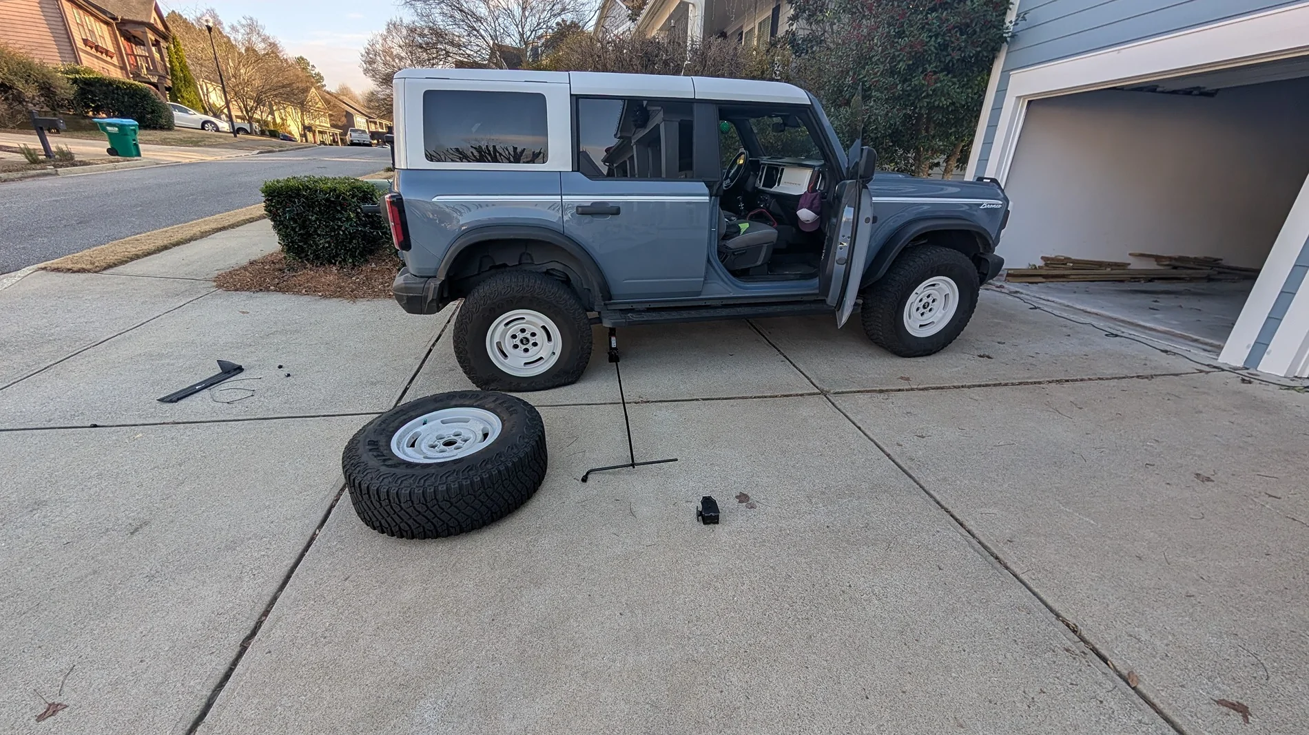

Nasty screw picked up, more like bolt. Lucky I was close to home. No rim damage , lost air quick.
Then the fun began. Unpack jack, set up in my driveway. Not impressed with the jack, so def getting a new one. With that said , being super cautious I had it changed in under an hour.
Let's see if the plug it

Perhaps the camera's perspective is adding more slope than there is IRL. But next time, use some of that spare lumber to chock your wheels. The OEM jack is fine - not the best and certainly not the most stable base. For the rear wheels, use the rear axle not the rear trailing arms as a lift point.

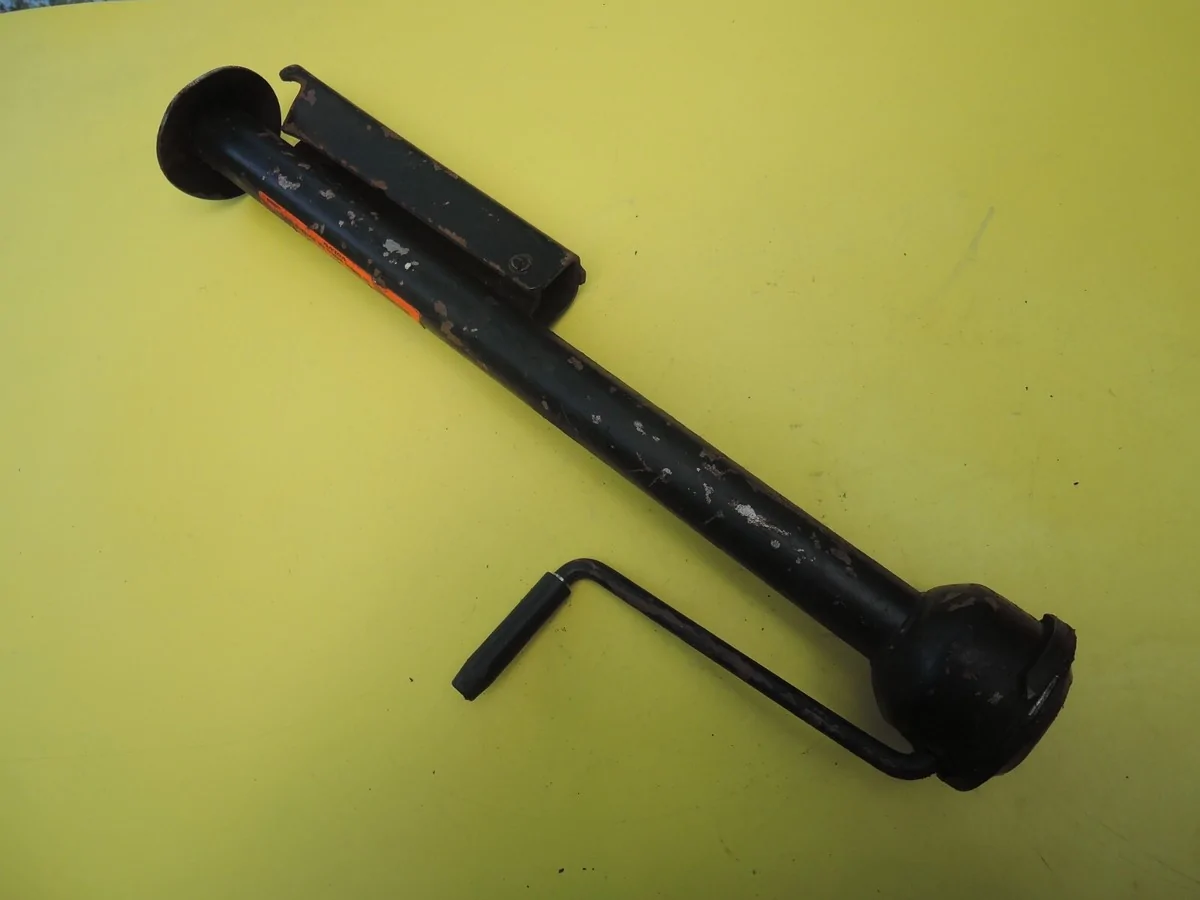

I’ll take the Bronco jack over this sketchy design of a 1970’s Volvo jack I had once upon a time.
Ford Bronco Caught my first flat .. IMG_1329
There’s always a sketchier jack!
