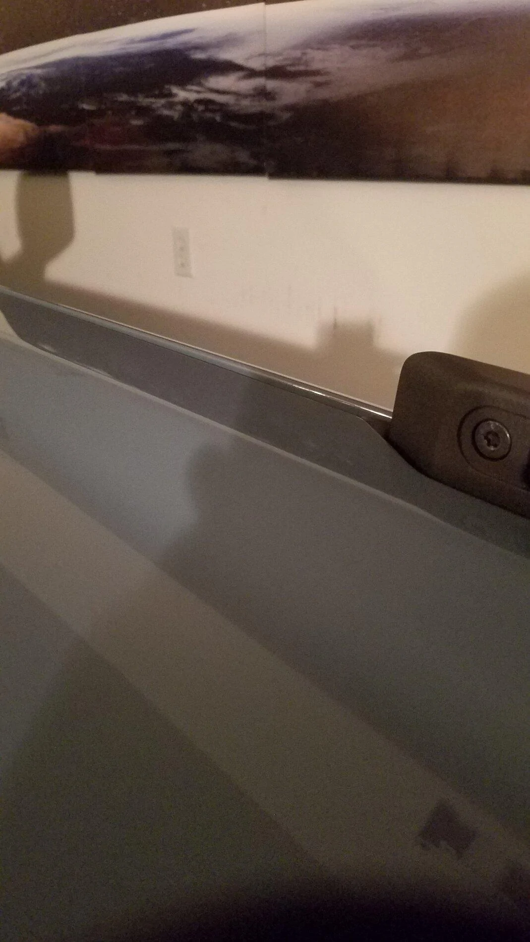

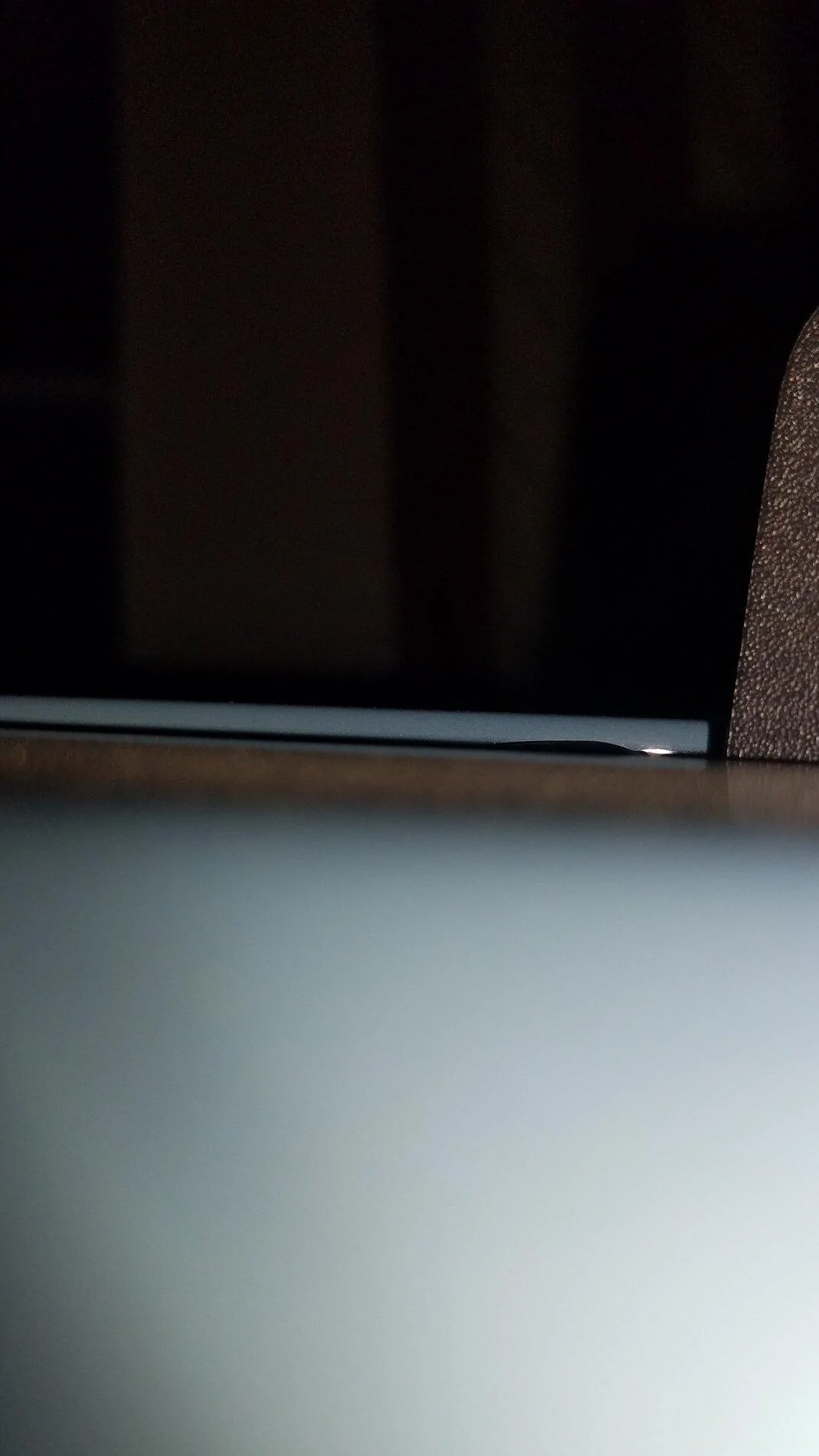

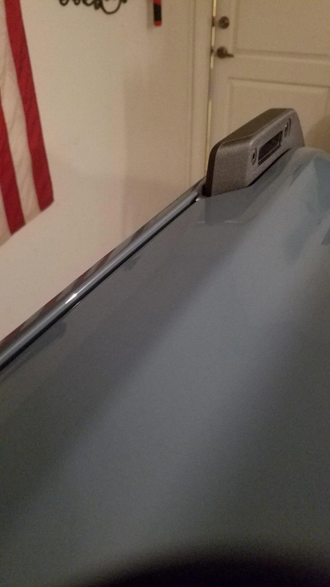

We noticed our bronco hood wasn't lining up flush with the fender/driver side marker. The hood sitting a tad low towards the front driver side slope. Passenger side fine. You do notice bc your eyes are drawn to the markers, but not end of world lol. We love our bronco!
I will say the best way to tell how well a car is built is how well all the body piece sit, line up and the gaps are all the same size. Toyota is great at this btw. But even they mess up. The first thing I do when home with a new car is inspect the body lines then the undercarriage. I'd grade the bronco a 7 out of 10 on exterior and 7 out of 10 interior. Thats being generous but its also a bronco, thus, well accepted.

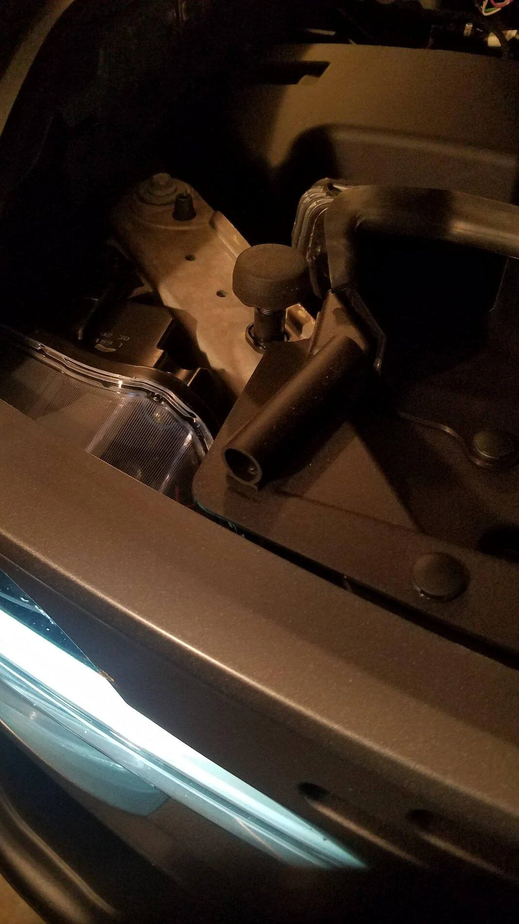

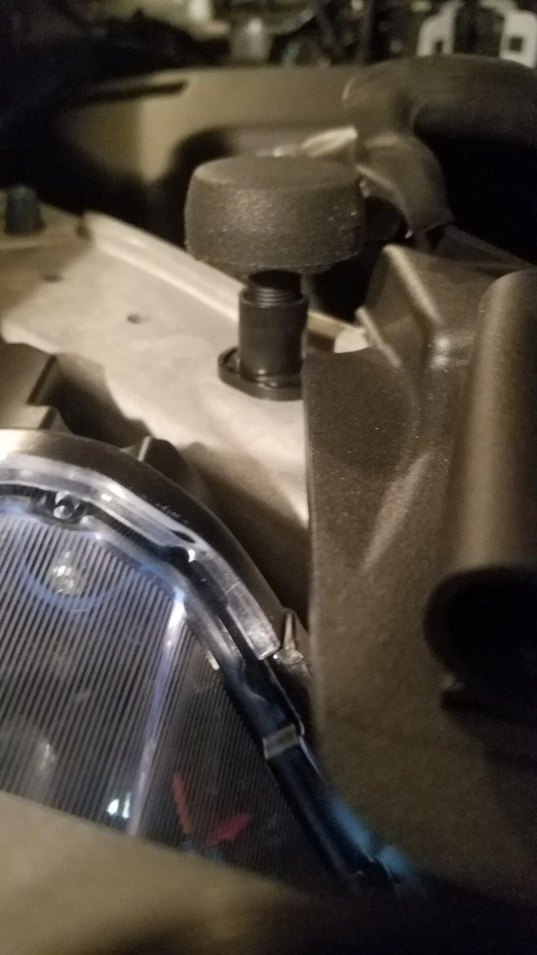

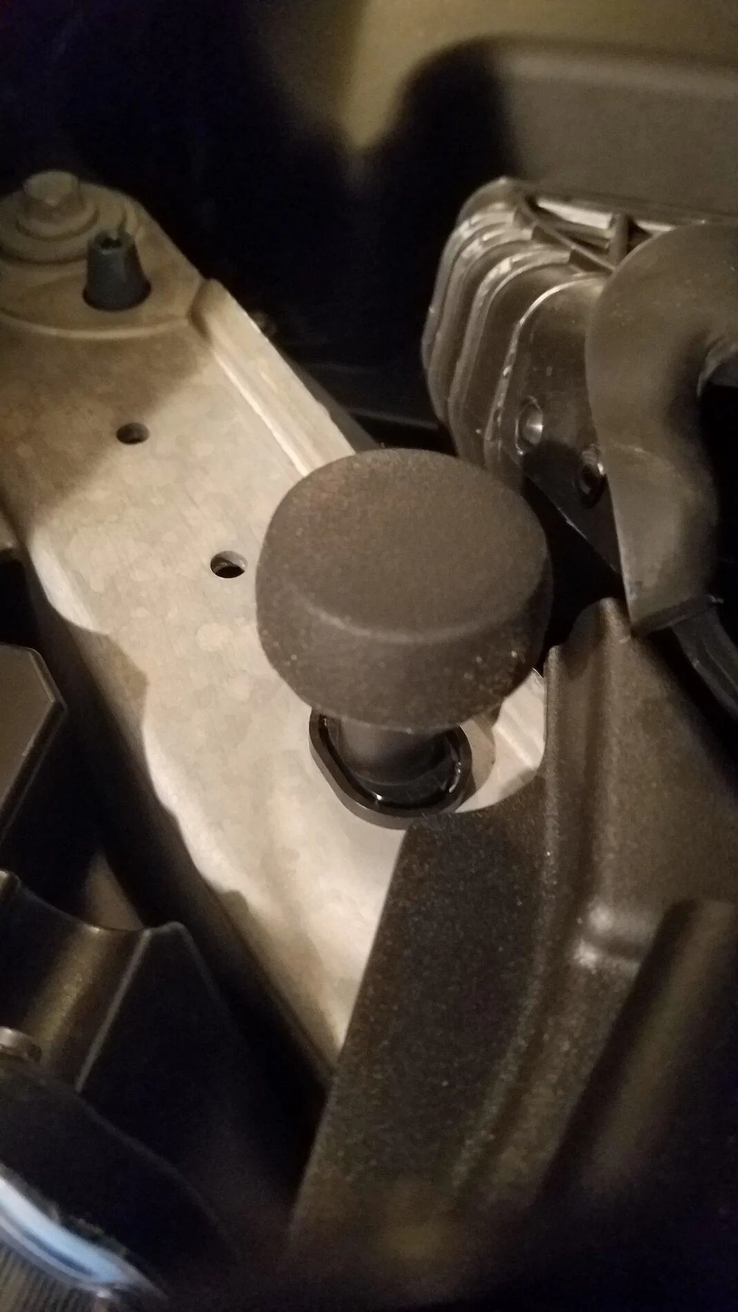

Every car has hood levelers in the engine bay on the left side and right side both up front. Bronco too. Black disc. See pics. You turn it clockwise to lower hood and counter clock to raise your hood on either side. I didnt touch passenger side adjuster, but had to loosen driver side almost all the way out. It helped a little. Since we cant raise it anymore we are happy with it and don't notice the hood anymore. The hood also doesn't vibrate on highway like my 4runner and honda accord. Good.
I also think a lot of it is simply the angle from which the corner of driver hood sits and the driver vantage point.

I always thought those bumpers you're talking about where there to stop rattling and that they were protective against damaging the hood when closed hard or slammed.... i didn't know they were aligned to make the latch mechanism work!!
i will try it and let you know but honestly i think its the latched mechanism itself .... not to beat a dead horse but when you guys say all Ford's are like that I'm still baffled how Toyota doesn't have these kind of issues with any type of latch ........ I mean it can't be rocket science for Ford's Engineering after 100 years in the Automotive world ..... its a frigging latch FFS
