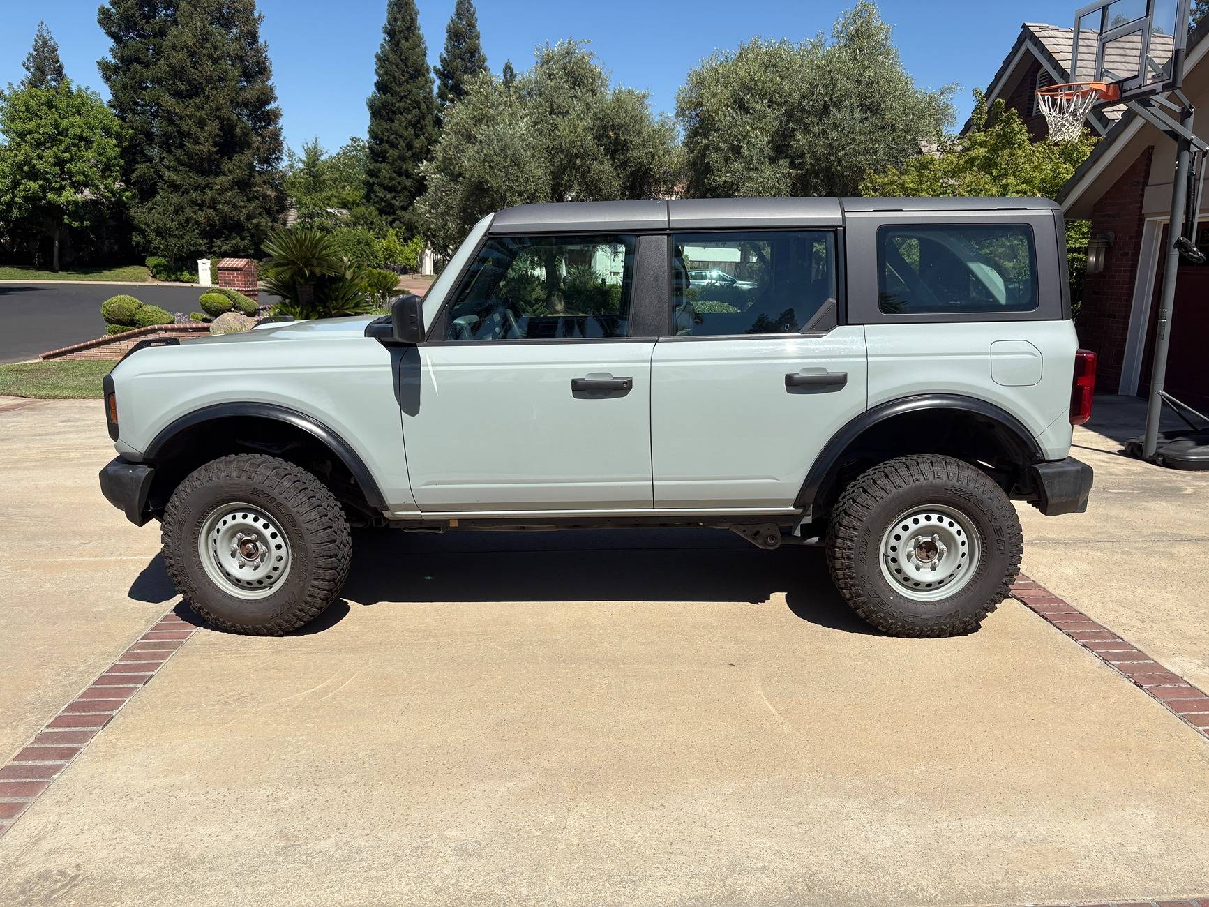

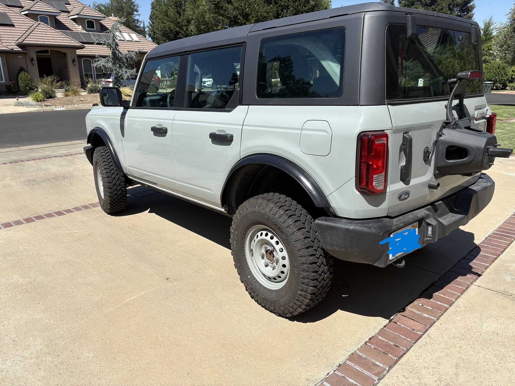

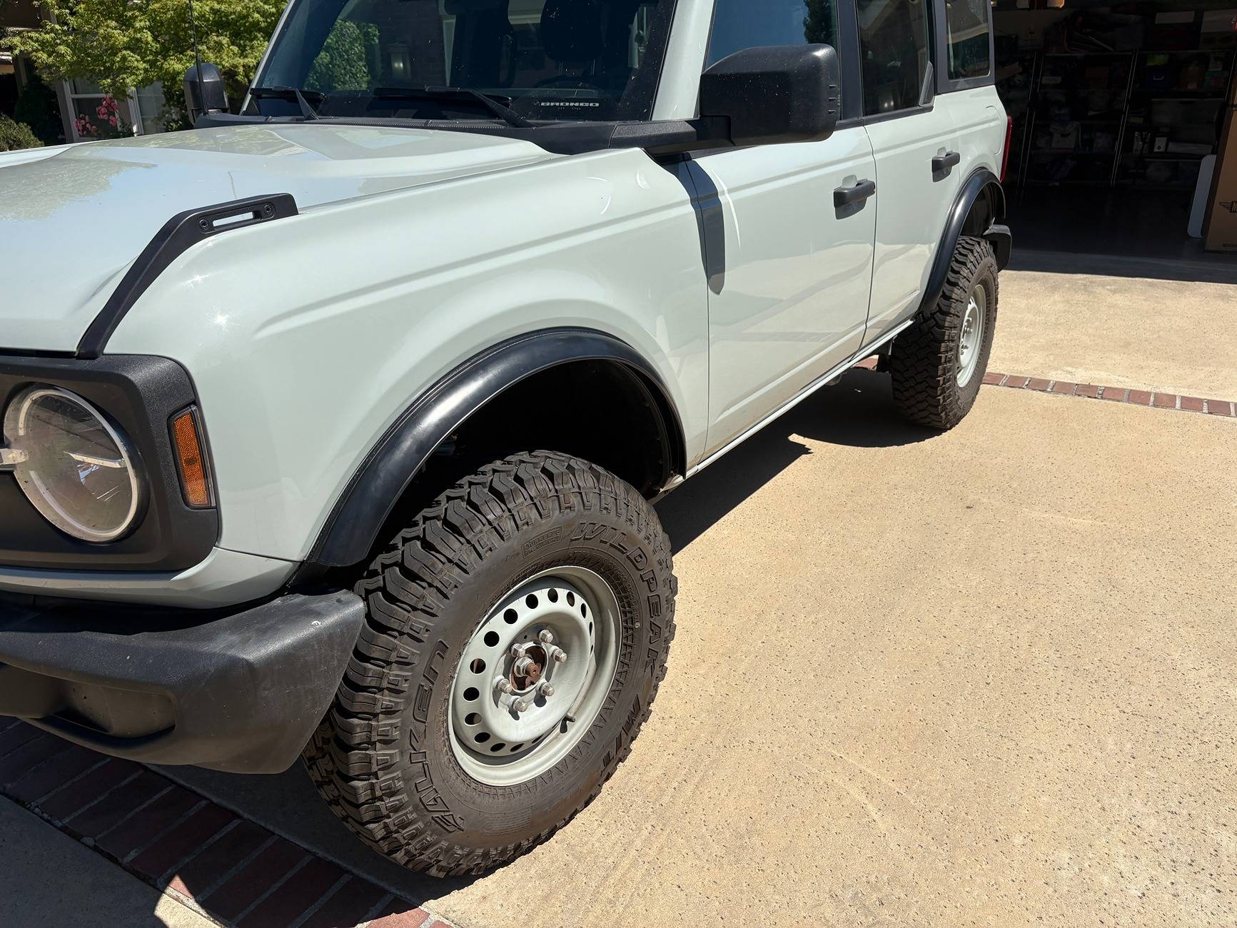

Just completed initial install of some Compact Flares.
Please let me know how this is looking.
I'm going for the OG OEM Old Man Narrow Body aesthetic.

I dig it. Looks good on your rig

@Bruno - these look cool
Were these the same easy-off/on as the stock flares? I've been waiting for someone (anyone?) to come up with a 'Weekender' solution to give a little 'poke' with my stock Sasquatch when I want that and then be able to swap back to the wider ones when I need that. (Some states will not pass inspection if the tires stick out too far). Can you provide a link?

I don't like it. Makes the tires look too small. Creates too much empty space between tire and fender

These look like the trim to fit universal flares right? They look better on the 6G than most vehicles they are tacked on to.

@Bruno could you post a straight on shot. Also as @helifino16 asked how was install and removal, any drilling, use stock clips?
I like it, nice rig.

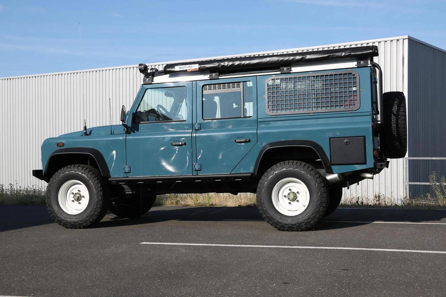

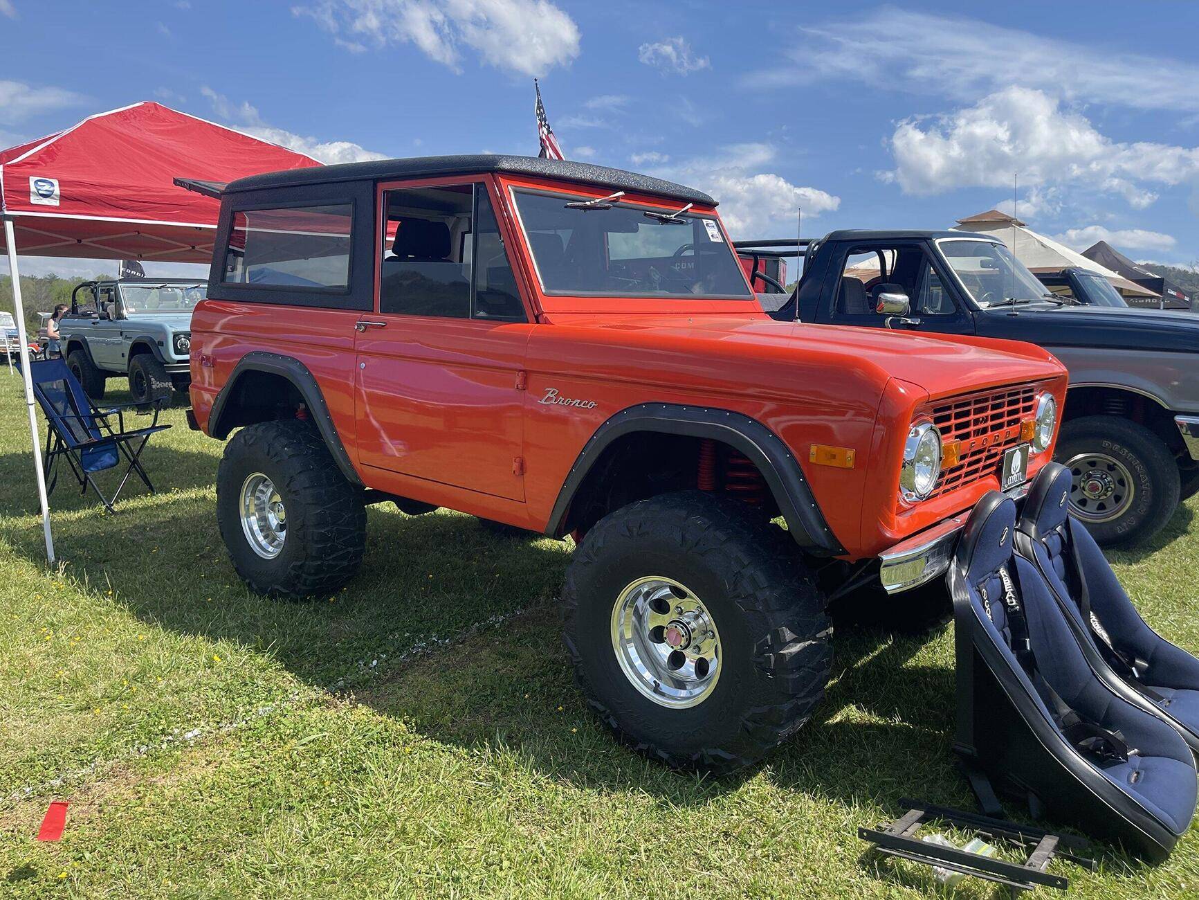

its intentional - pizza cutters on oem 16" steelies

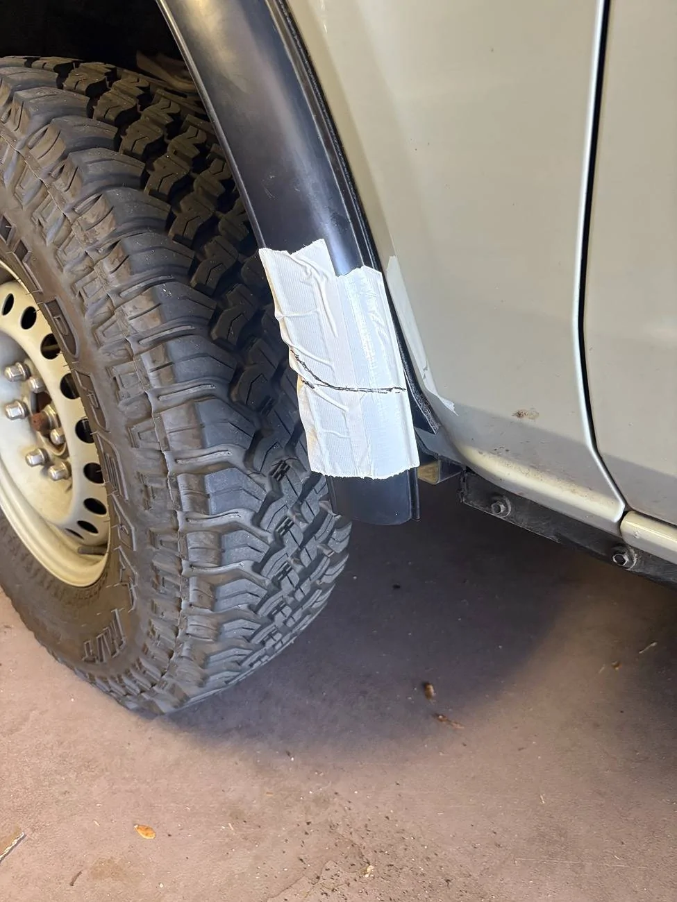

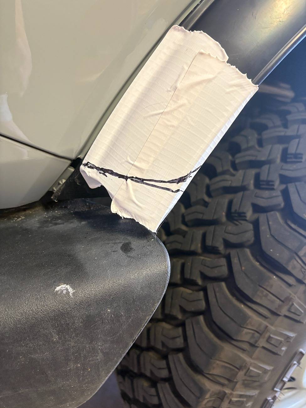

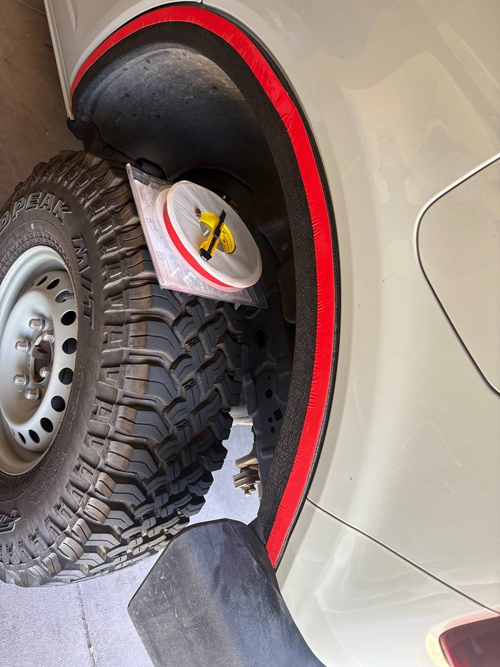

Ill work on it I need to do the other side in the next day or so
I used a Fender Delete kit, double sided tape these to it and reinforce with screws to the delete kit

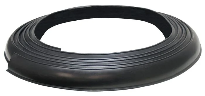

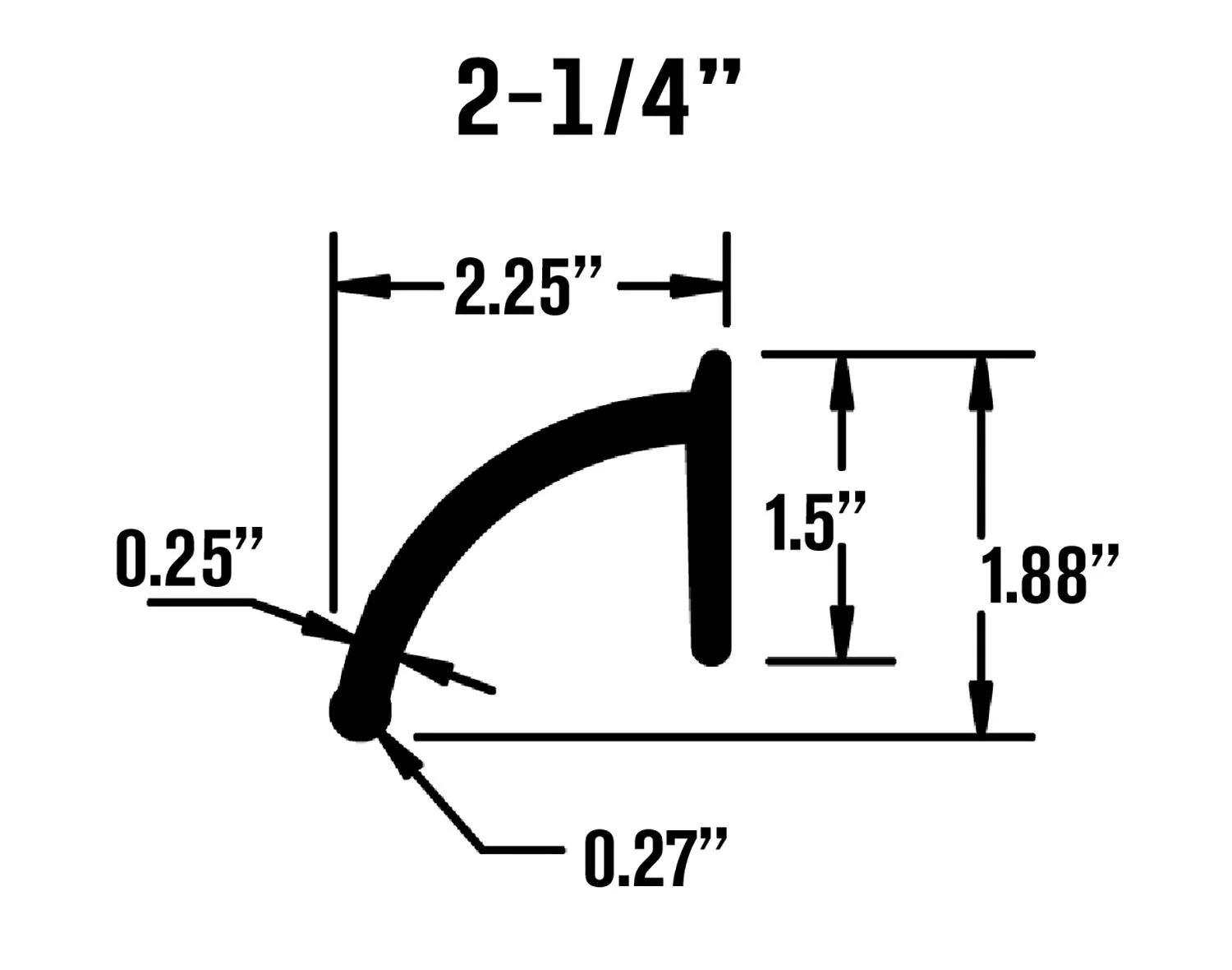

its this stuff
https://pacerperformance.com/products-footer/flexy-flares/universal/no-lip-side-mount/52-168-detail
