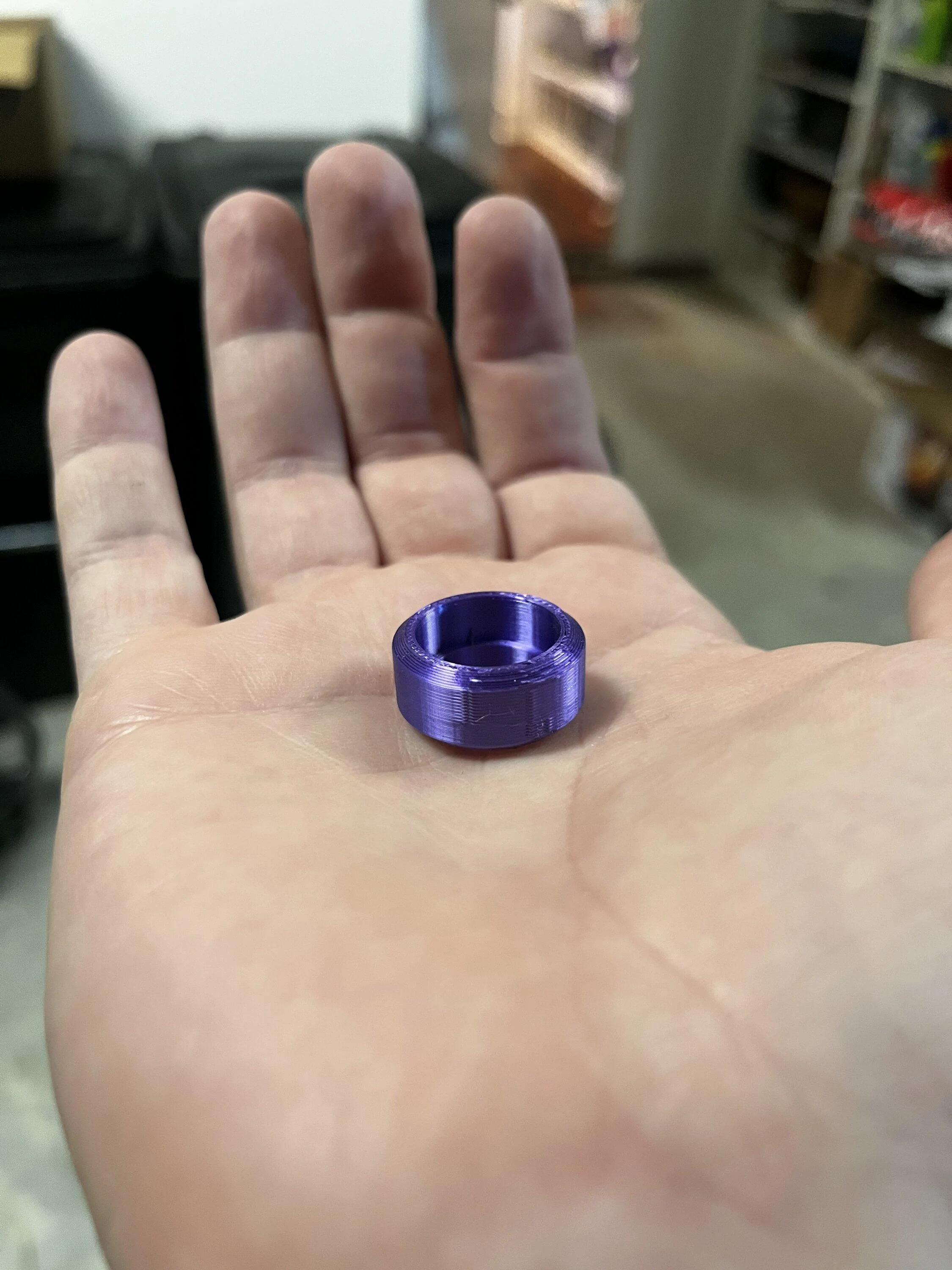

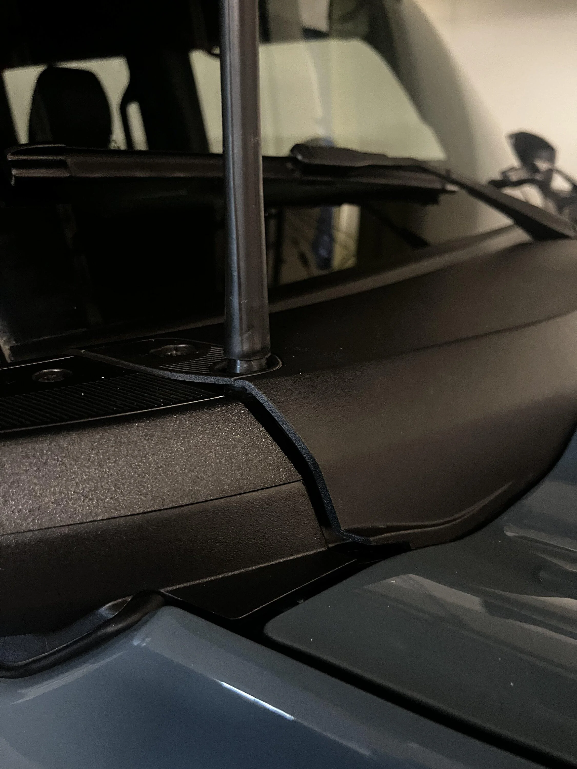

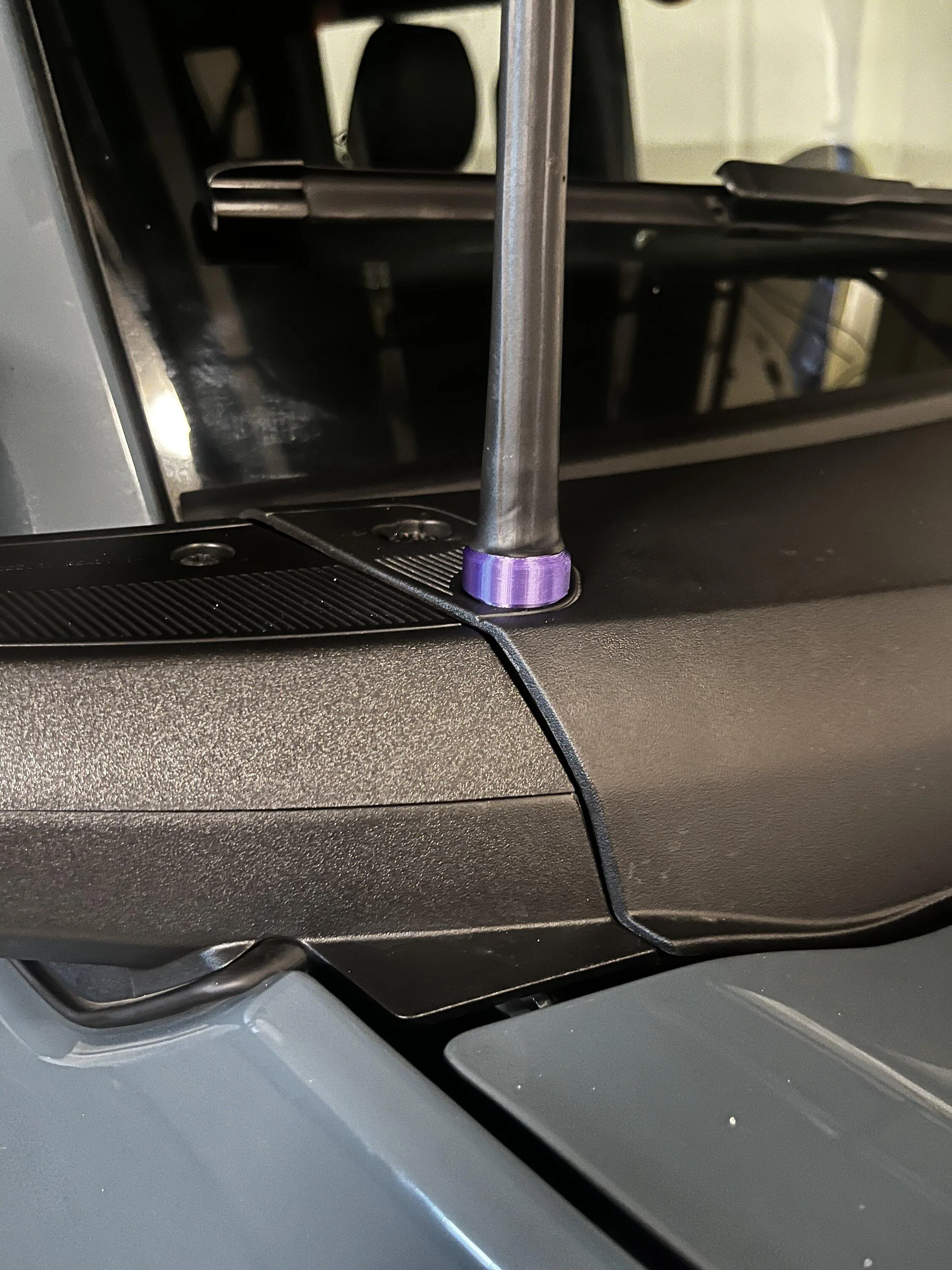

I've had this issue on my passenger side for a while and I've been intending to have my dealer take a look at the next oil change. It interferes with the hood opening and I worry it will either break or scratch up the hood. In the meantime I measured and 3d printed a custom plastic collar that holds the trim down using pressure from the antenna. I'll print another in black but used this flashy filament b/c it was already loaded and easier to see how it fit up on the bronco.
I may add just a little more of a shoulder at the bottom to perfect the fit, but this version will at least let me open the hood cleanly. If anyone would like a copy of the .stl file, PM me and I'll share it. If there's a lot of interest I'll create a post with a link.
