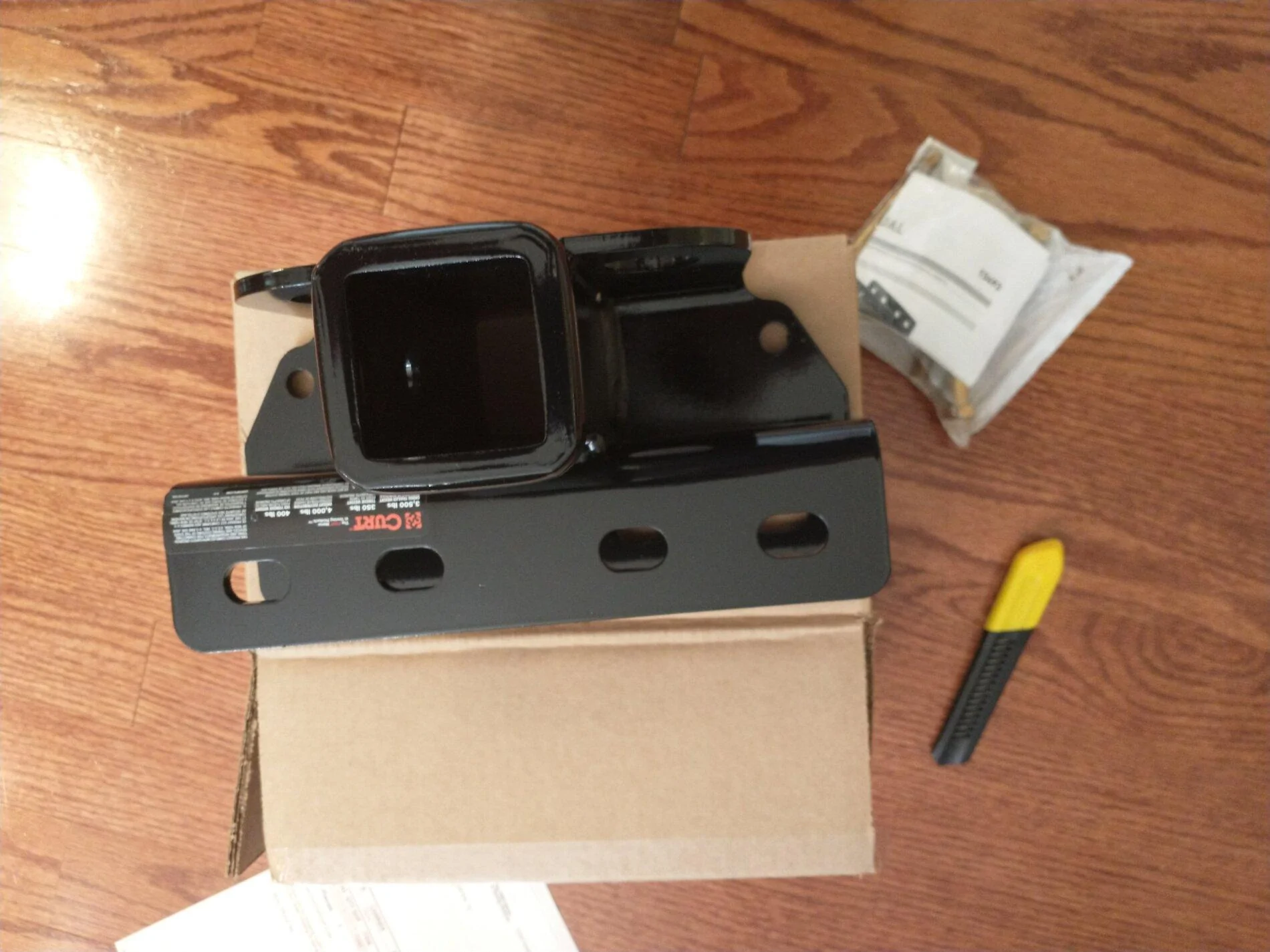

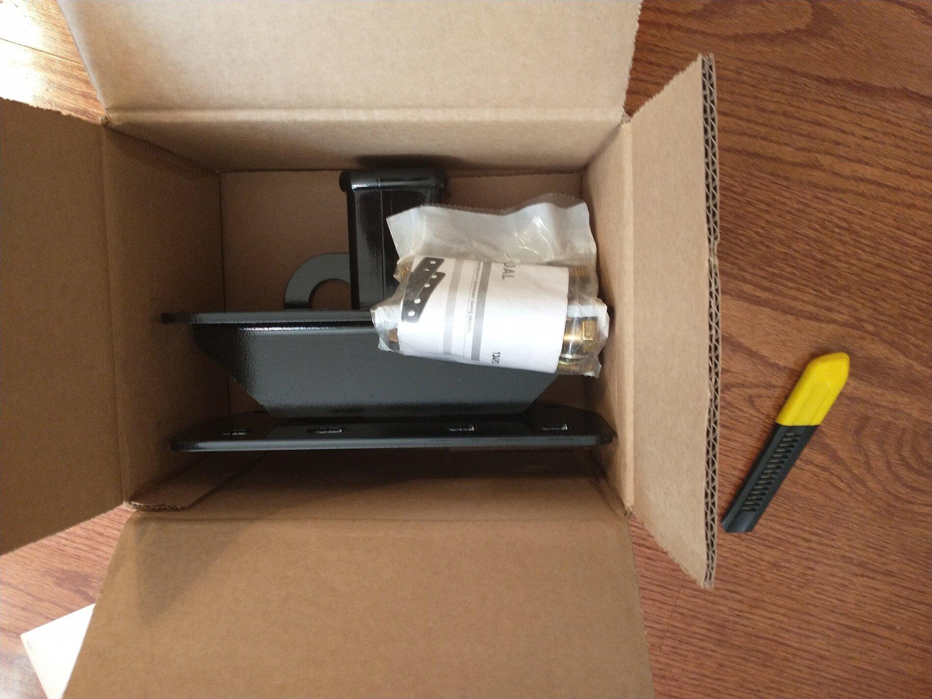

Got the Curt Hitch delivered yesterday. Ordered through RealTruck.com link found here on the forum for $111 ($120 including tax).
Someone on the forum had asked if it came with the mounting bolts, it does.

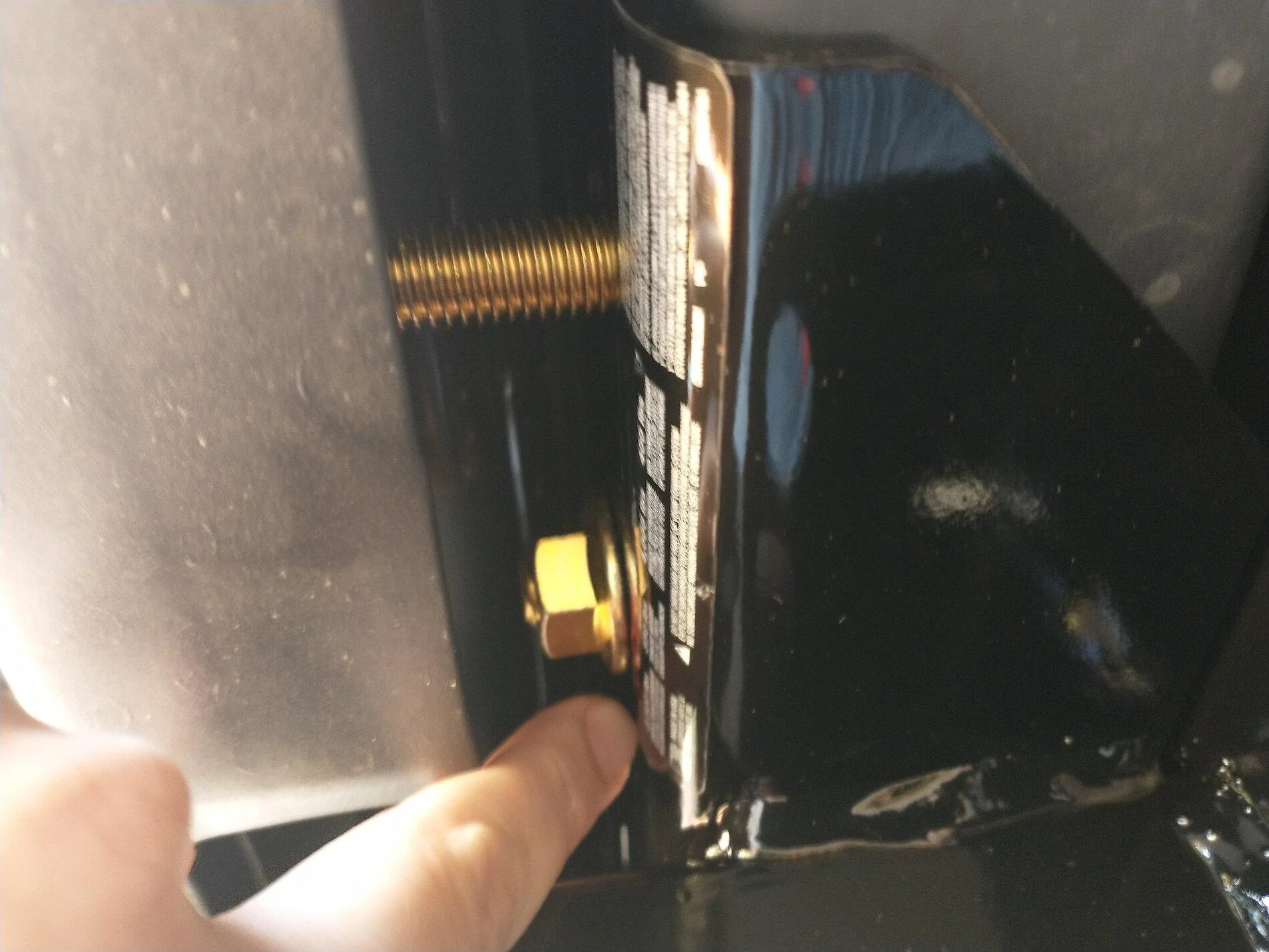

Not a lot of clearance so you have to get the nut on before pushing the bolt all the way in. Can barely get your fingers in there, but it's possible with a 3/4" wrench. HD Modular bumper pictured.

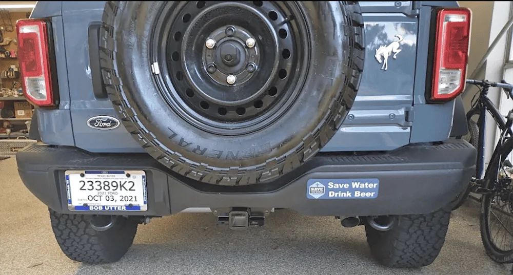

Ford Bronco Curt Hitch (Class III) Installed on 2021 Bronco Black Diamond 4-Door Curt Hitch installed 2021 Ford Bronco
It's barely a 1 beer job at 15 minutes. Hardest part is getting 110 ft-lbs toque lying down on your back and reaching up. I'm happy. Definitely a good deal compared to $350 for the OEM Ford one.

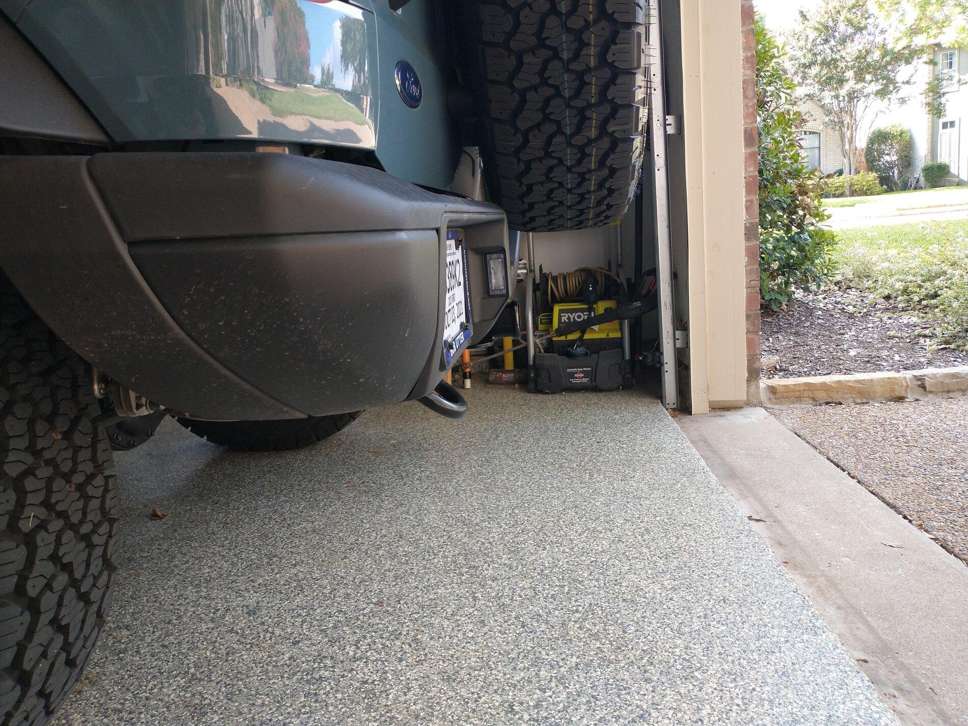

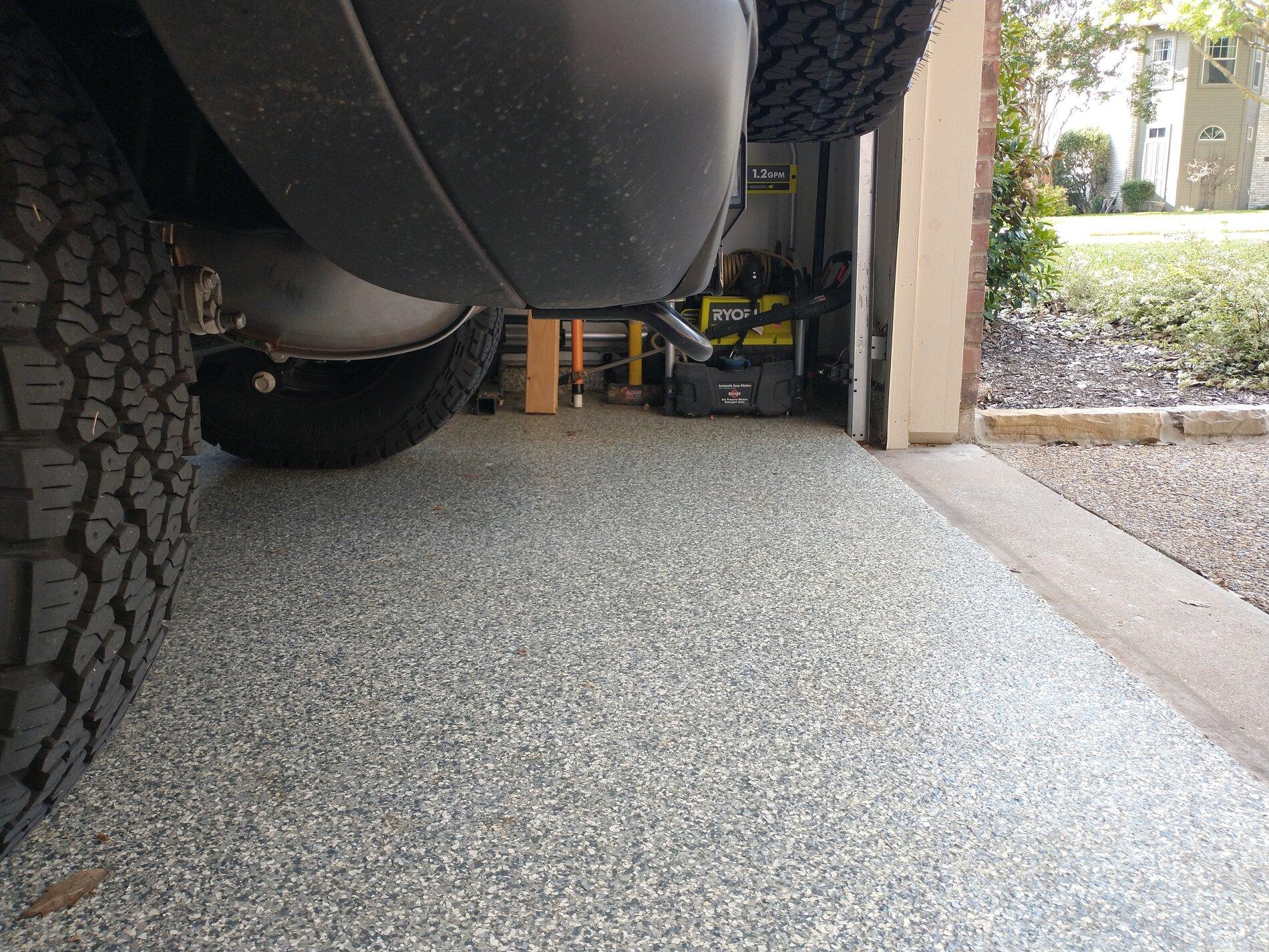

Profile pics for anyone who is concerned about clearance and departure angles. It doesn't stick out any further than the bumper and the recovery loop thing is still the lowest thing hanging.

I'm disappointed in you for not commenting on the bumper sticker.
