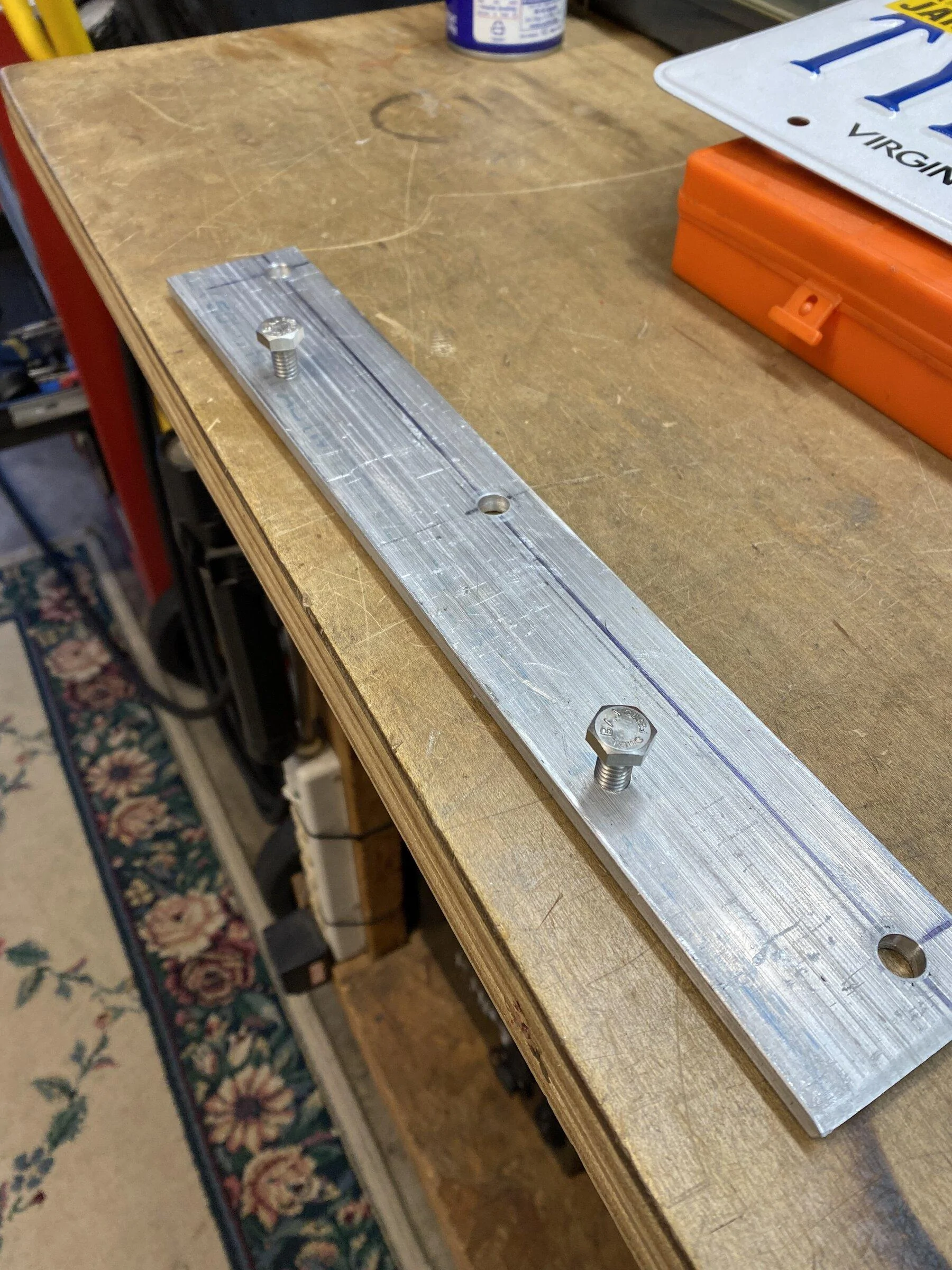

I used a piece of 1/4 x 2 x 13 AL flat bar.

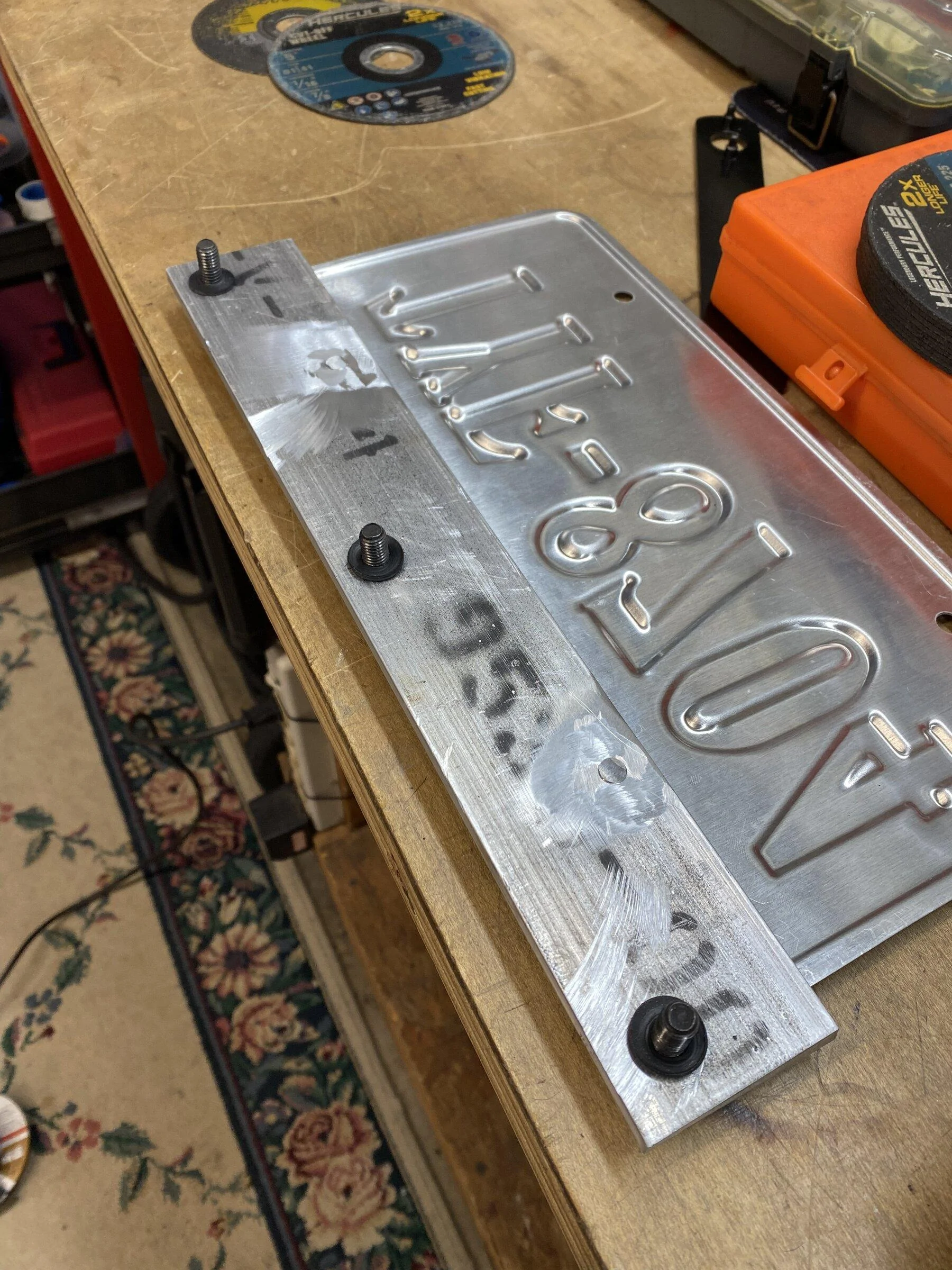

Drilled three holes across the top to mate with the bumper bolts and then drilled and tapped two holes to attach the plate with. The plate is bolted to the mounting plate and is super secure.

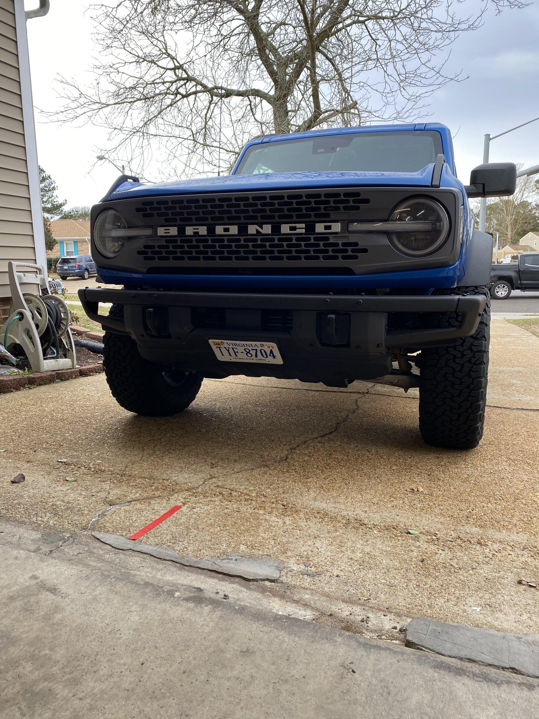

Nope, on top of the bumper isn't an option:
AL plate drilled for bumper mounting and drilled and tapped for plate mounting:
5/16" bolts cut flush and ground smooth on the backside. I also put a rubber washer between the bumper bolt and the bumper, not needed but I had them laying around.

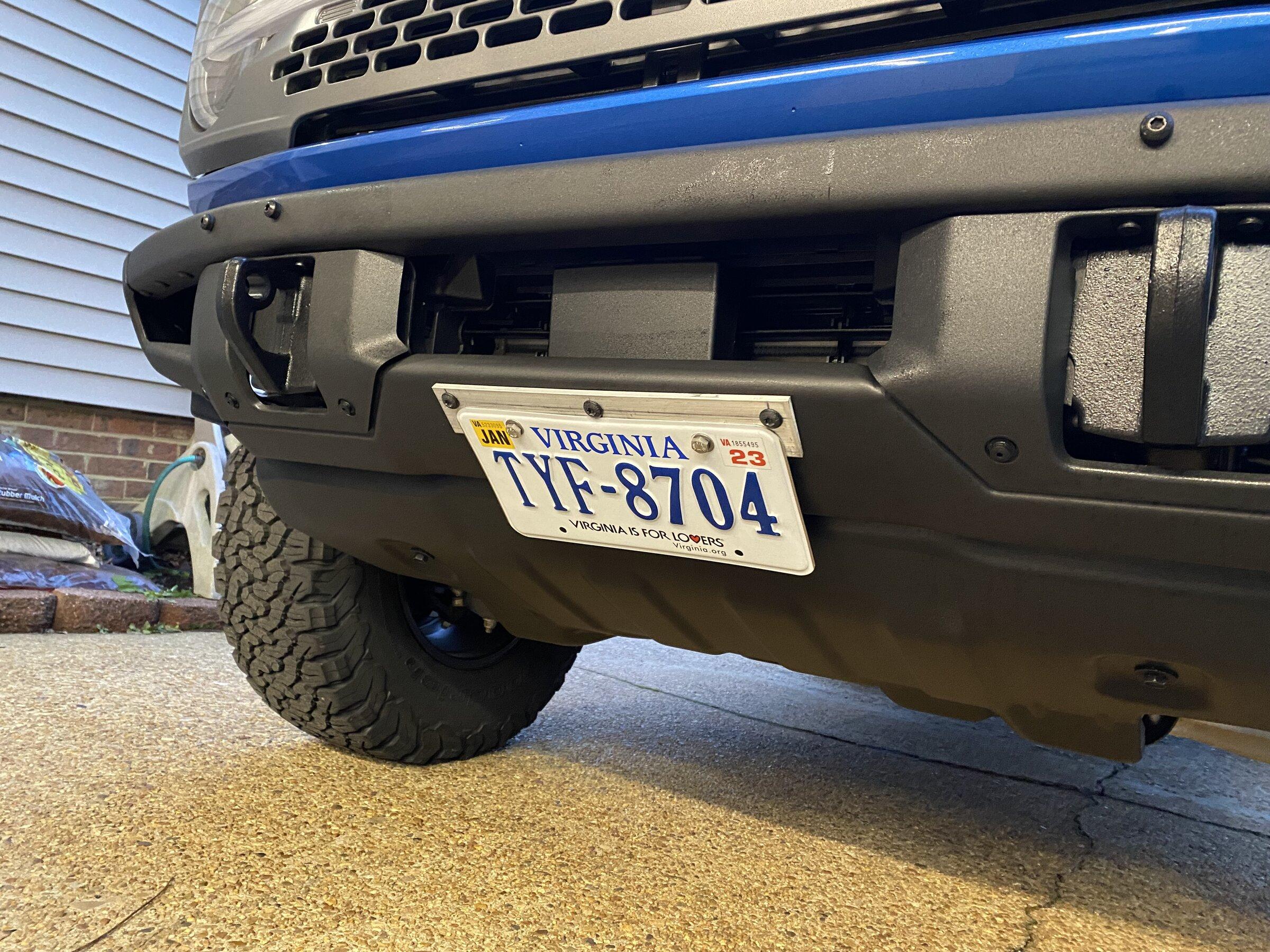

Final product pre-painting:
And once painted it disappears:
Could have just drilled two holes in the skid plate but this allowed me to use more tools.
