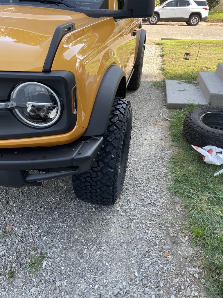

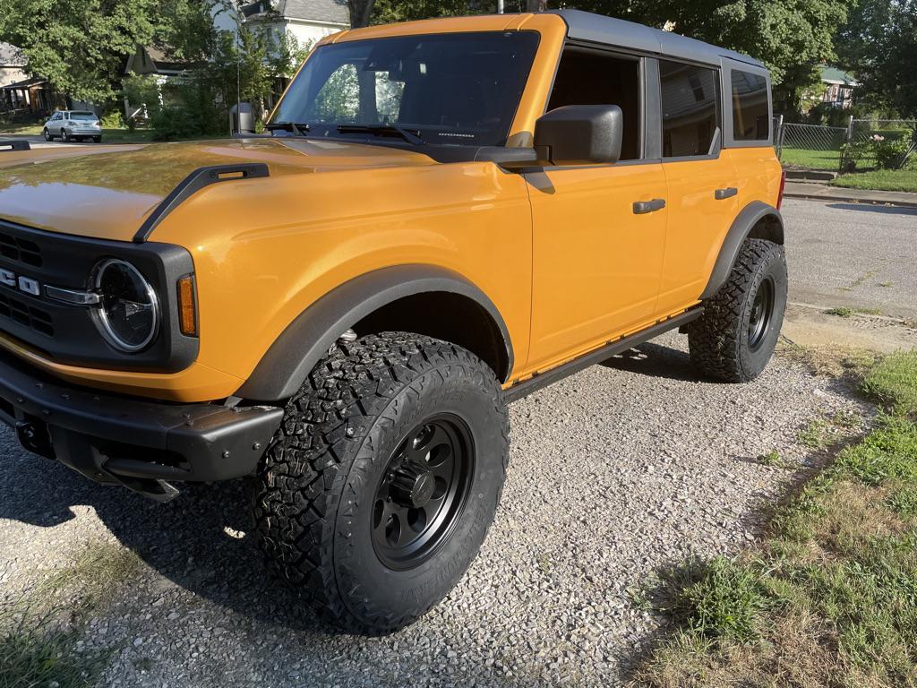

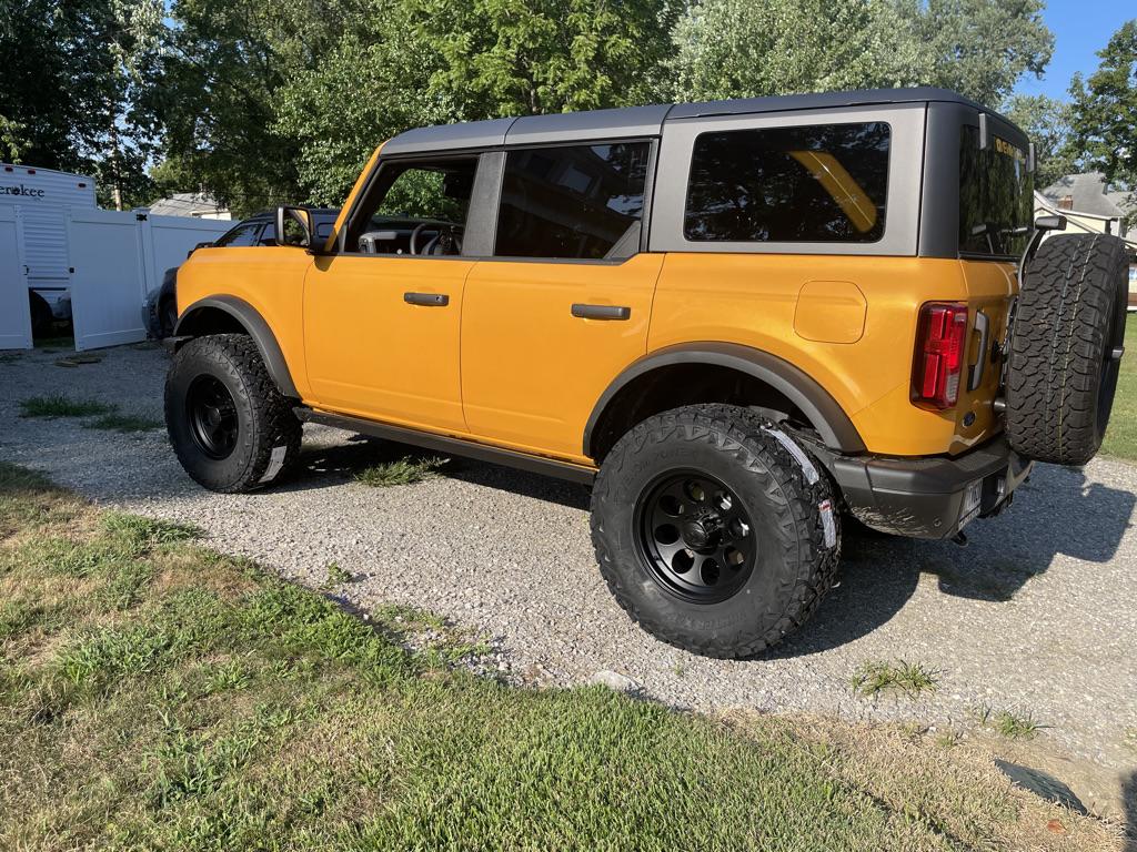

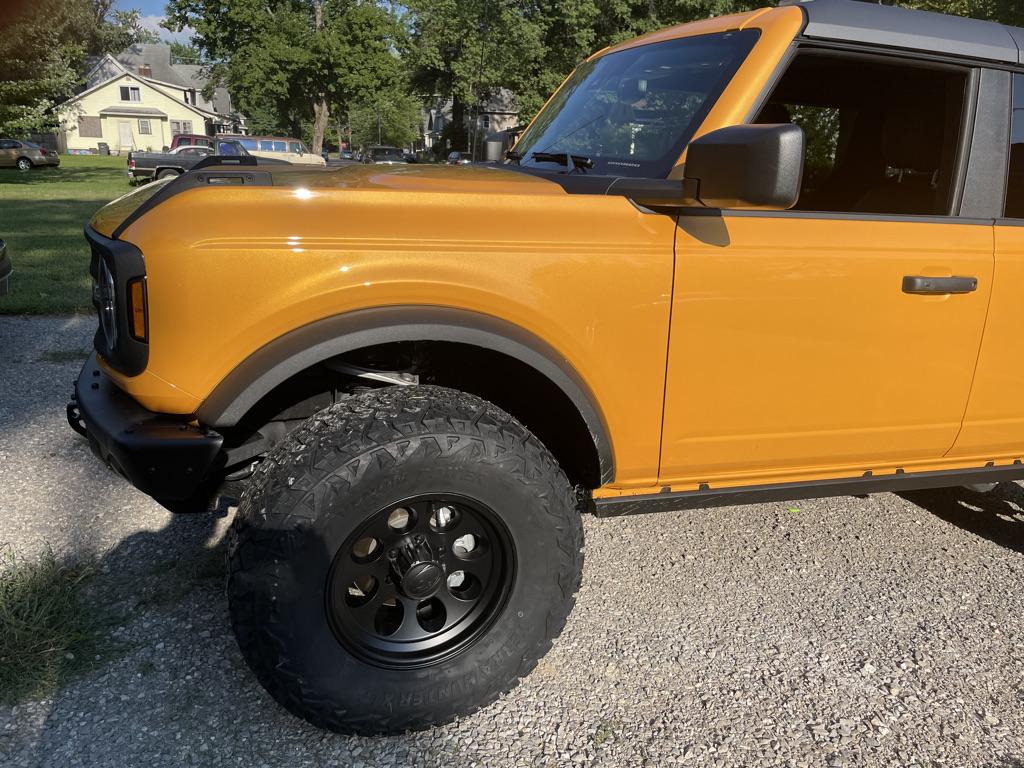

Wheels and tires finally came in.
17x9 Ion Alloy Style 171 0-offset
35x12.5 Venom Power Terra Hunter X/T ( Never run them before so not sure how I feel about them yet, so we shall see )
