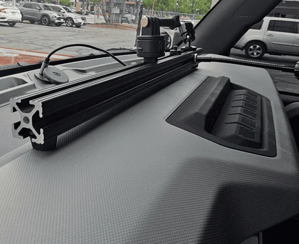

I didn’t want to spend up to $300 on some of the commercial accessory rails I have seen advertised and I wanted more space and flexibility than some of the $40 rails. So, I engineered a $20 rail that is extremely flexible, sturdy and more affordable. Please feel free to use this as a starting point for your own ideas. I have used it on highway and dirt trails and it has provided a stable base with my devices thus far.
Finished DIY Rail (USB hub behind the rail)

Shown attached to the rail
Here are a few accessories I have attached to the rail with good results
