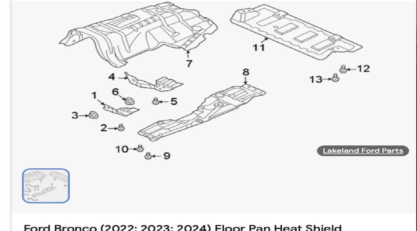

After hearing the second video I still think one of these may be rattling around. These heat shields are located at the front near where you are suggesting the noise is coming from.
