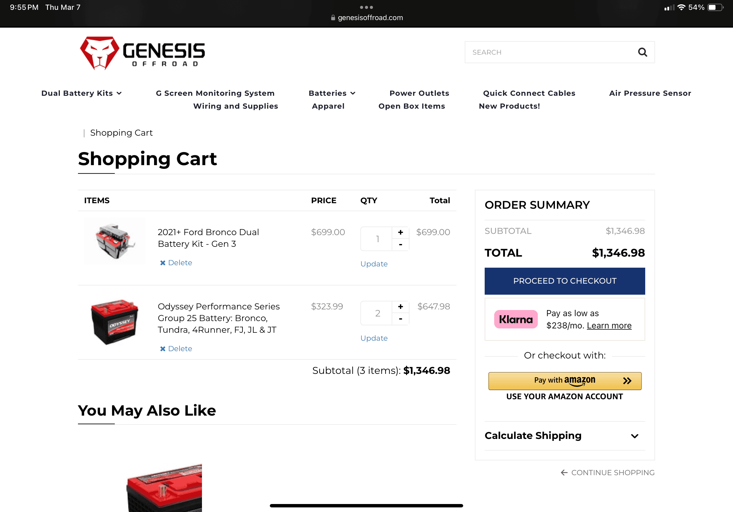

$1,350 all for hooking up what looks like a 60ah battery? No thanks.

Most Group 25 batteries (and there's not many out there) are 45-50 Ah. The good ones can get up to 60 Ah (ish). Factory battery is 80 Ah, and I'm sure there are aftermarket ones out there that can get close to 100 Ah.
So I can spend $350 on a 80 Ah battery (less with FordPass points). Or $1350 on a 100-120 Ah setup. The diminishing returns with this are impressive—a nearly 300% increase in price for 25-35% increase in power just doesn't make a whole lot of sense.
I assume most people would be getting a dual battery setup to run a 12V cooler or some other electronics while camping. But for $1350 I'd rather get a full-blown Redarc setup with Lithium Iron Phosphate batteries. Gives you the flexibility of adding additional batteries and/or solar panels down the road.
