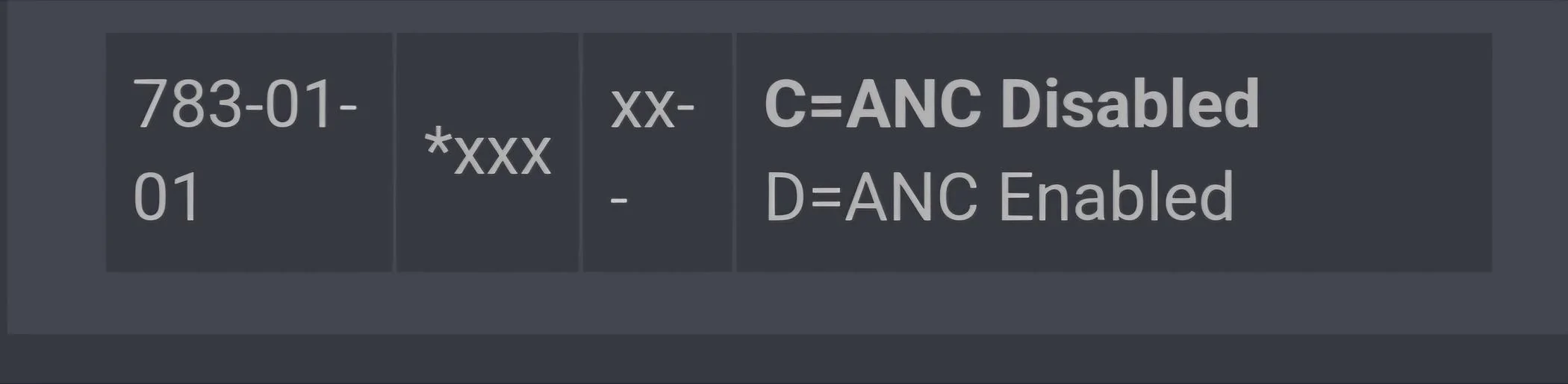

I know this thread is somewhat old, but it's surprising how much better the system sounds with turning off the active noise canceling nonsense with Forscan. It's crazy that someone at Ford hasn't realized that they are actually making things worse with that really crappy 'feature'
What part of forscan is that everything I have read say factory settings for the B/O system are the better bet? even with upgraded 6.5 rear pods, have not seen anything definitive for changes to forscan for better sound,
