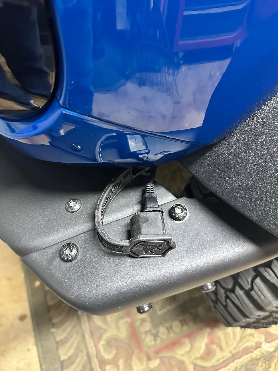

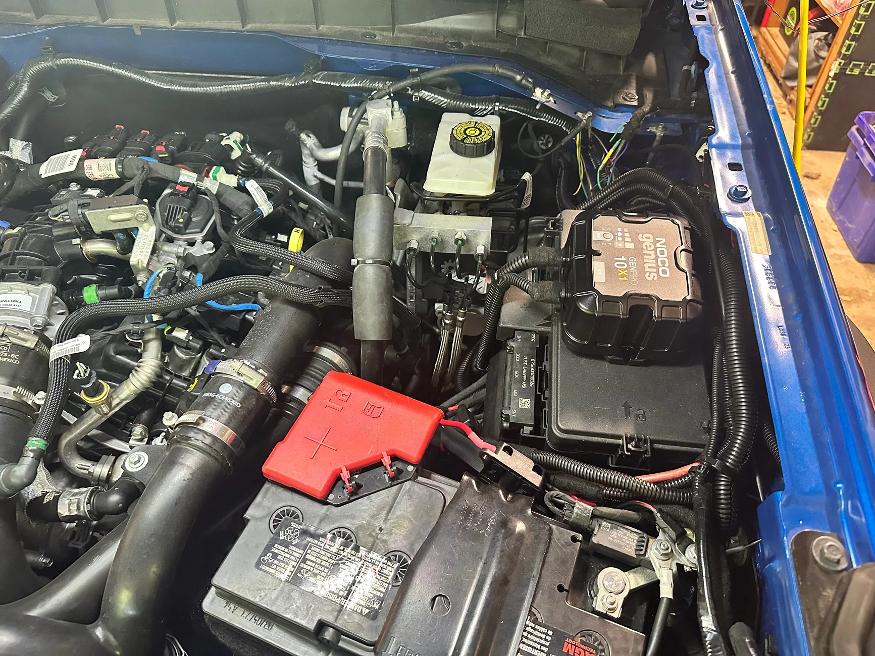

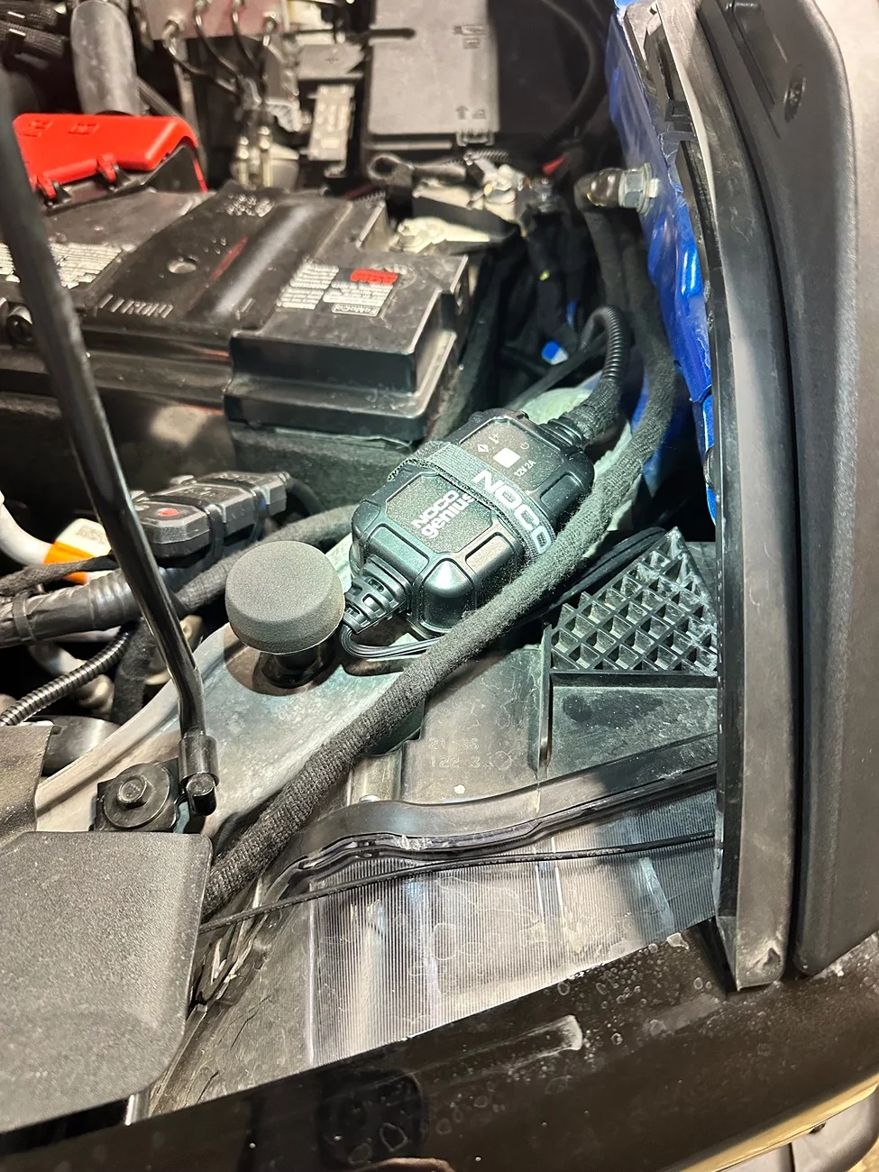

I have recently added a couple of things wired direct to the battery that always draw a small amount of current. Plus my Bronco sits a lot and does mostly short trips. Not surprising that I started getting "system off" messages in Ford Pass. So, it was time to install a battery maintainer. The one I used was a five minute install, and didn't cost much. Thought folks might like to see what I did.
https://www.amazon.com/dp/B07W3QSMF9?ref=ppx_yo2ov_dt_b_fed_asin_title&th=1
https://www.amazon.com/dp/B0FX3L8NJN?ref=ppx_yo2ov_dt_b_fed_asin_title

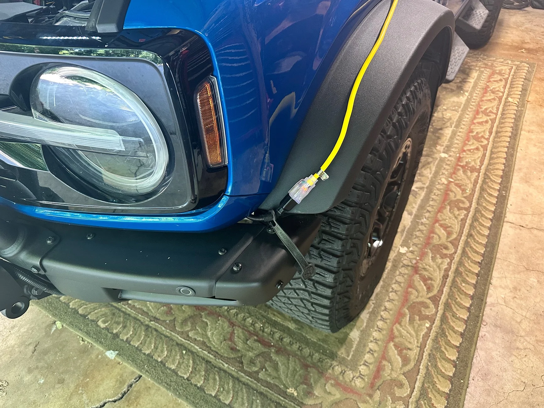

The 120 volt pigtail was just long enough to reach the front bumper. I'm very pleased with how it turned out.

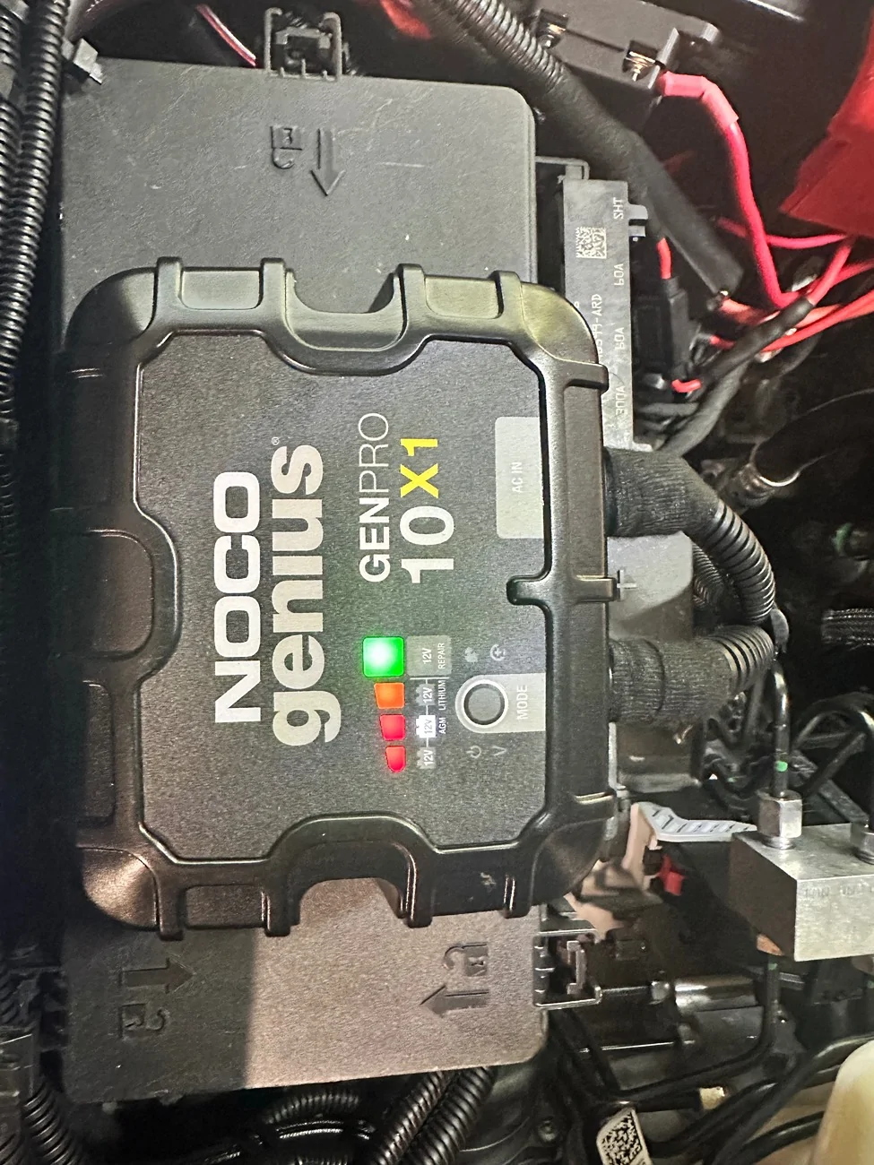

I have the same Noco 2D setup on my bronco, along with my other 2 vehicles. Inexpensive, yet extremely effective and great addition for keeping the battery charged since I don't drive it every day. Reminds me I need to route the connection down to the bumper area somewhere so I don't have to pop the hood all the time.

I have several Noco Genius 1's laying around for ATVs/Generators/tractors/etc - and that works just fine in the Bronco if you are able to let it set overnight. They are very small little packages, but they are set up like wall warts, so you probably wouldn't want to underhood mount it like you can the Genius 2. They do have a ring terminal adapter that has a Noco-specific quick connect that's smaller than a 110 plug though, and that I have wired in all my small engines.
https://www.amazon.com/NOCO-GC002-Eyelet-Terminal-Connector/dp/B004LWQ35Y
Last year I got a bigger Noco Genius 10 to support Forscan/FDRS programming. It's a lot bigger, you wouldn't want to mount that under the hood, but works as expected.
